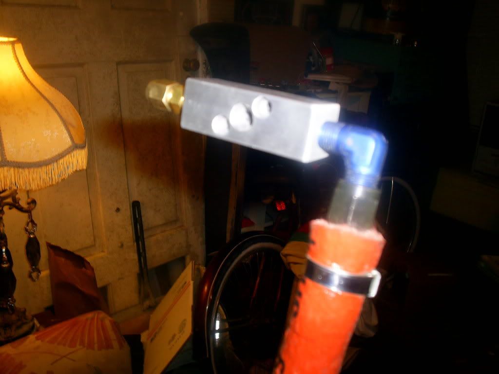

this is how it would connect at the oil filter, the only difference is there would be an adapter between the fitting you see here and the oil filter housing
http://i20.photobucket.com/albums/b2...c/S4021070.jpg
this is how the other end would go at the firewall side, the line to the oil pressure gauge comes out the other side.
http://i20.photobucket.com/albums/b2...c/S4021071.jpg

i'm going to possibly start making them, 45 bucks including shipping. I might break even at that rate. thats including the 30 percent discount for three geez members. these are hand made and take some time to make each one, I don't exactly have a CNC machine or anything. that includes the hose which i have a limited supply of, and one 90 degree -4 to AN fitting. one straight -4 to AN fitting, and the high quality brass fitting for copper line to the gauge. I may have to go up in price though, I sold the first one for that price, I just about break even. prototype first parts are always cheaper. I can make them with 1/8 npt for the warning light sender, or 1/8 bsp to fit the factory sender.
