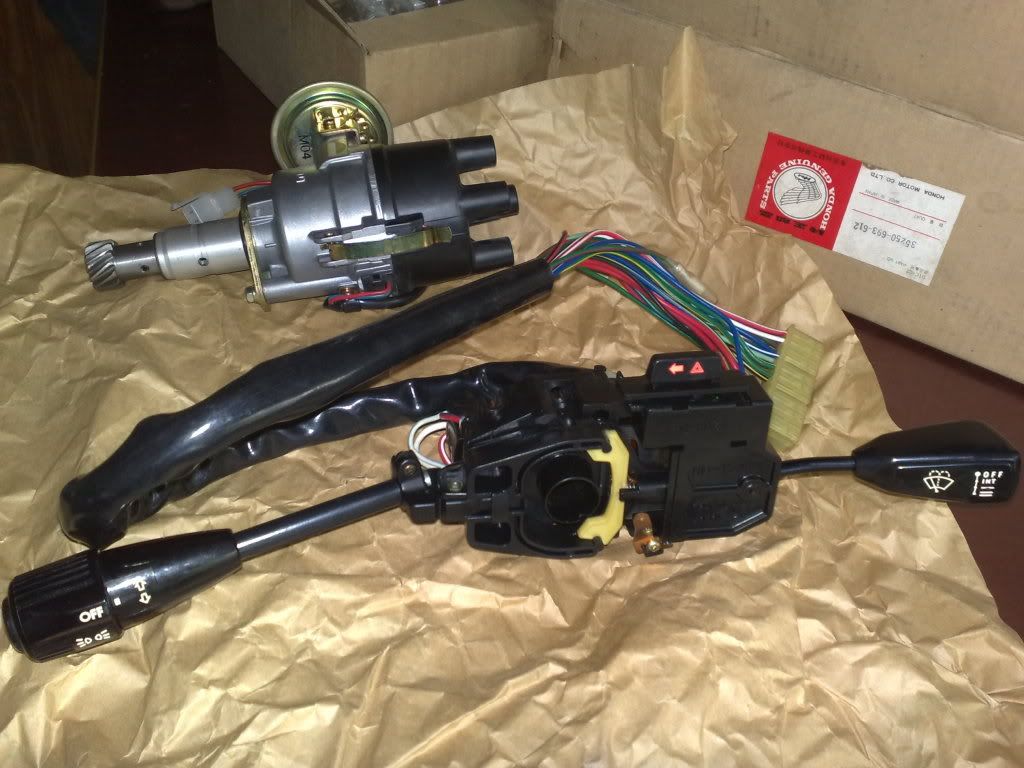

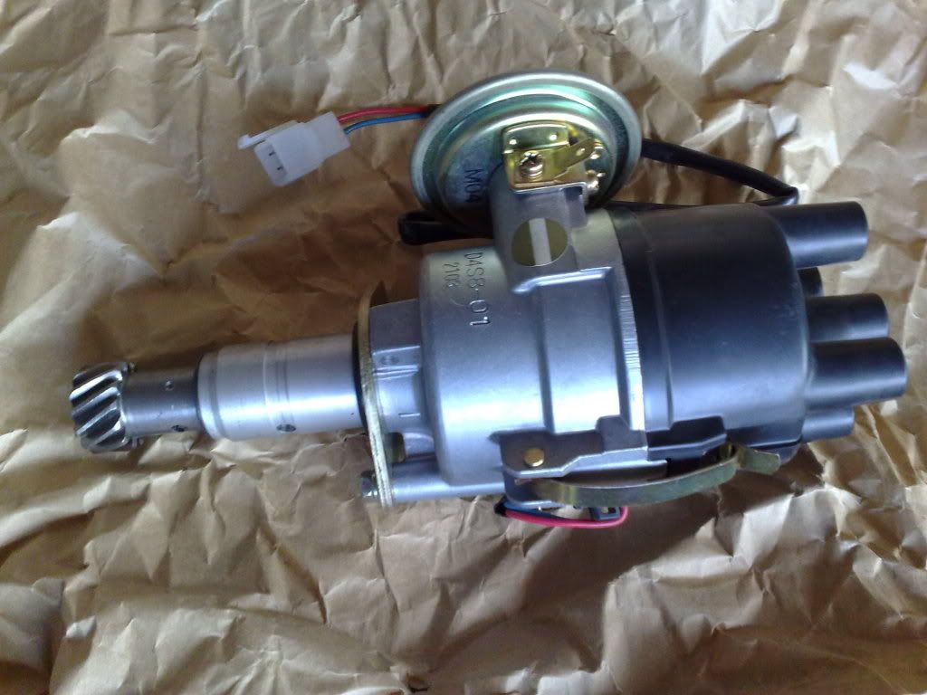

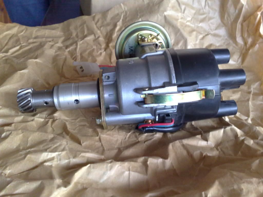

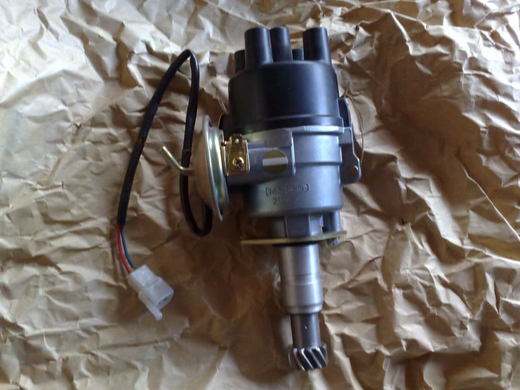

Well, from my point of view, its still cheap, i dont have the points type ones, but have the electronic ignition ones, complete with rotor and cap, and sold the last one for U$D 190 to Argentina.
Here is the pictures, 3 left. ( Well, 2 because one is going to my car )
Aren´t new Honda parts beautiful??
**EDIT**: My parts are NEW, of course that a remanufactured one can be found cheaper, take that on count.
