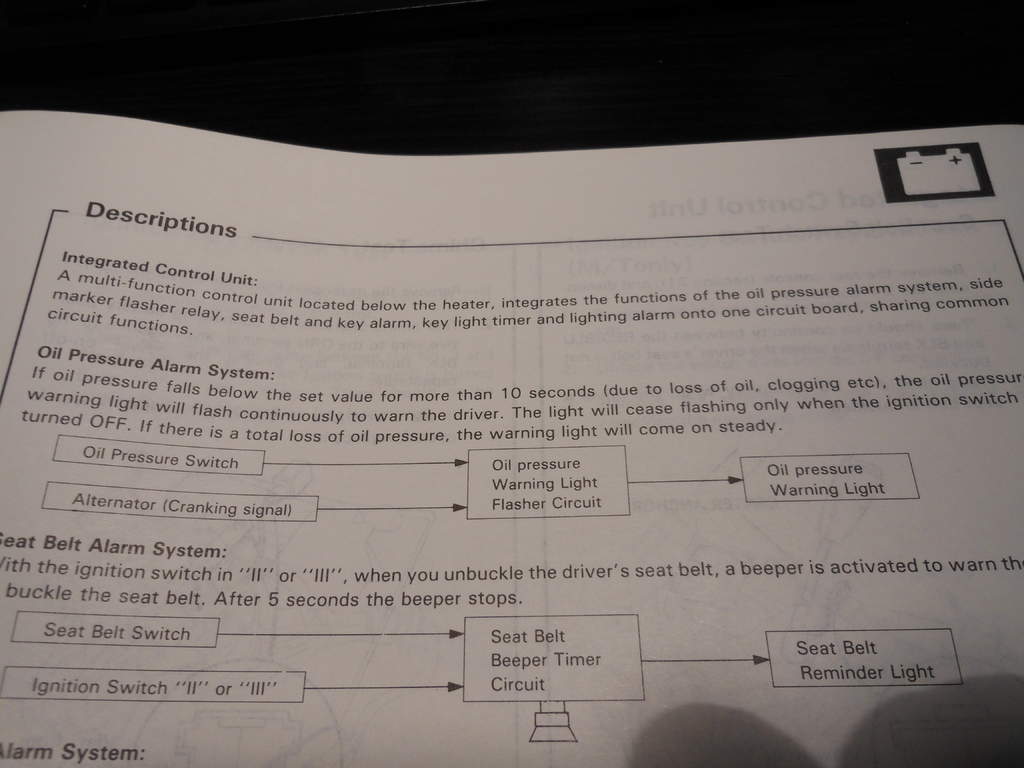

The oil pressure switch is a single 1 wire connection and its placement would only allow oil leaking from the valve cover or the base housing to possibly come in contact with it. There are no external contacts other than the single wire that comes off of the sensor that is technically a simple transducer. If the system falls below the factory set safety pressure value for more than 10 seconds it will continually flash and will only stop flashing when the ignition switch is turned off. Total loss of pressure will keep the light on. The system is primed from the Alternator cranking signal from the voltage regulator (pin L Wht/Blu wire only), the charge light shunts the IG and L pins off the voltage regulator (Wht/ Blu and Blk/Yel)
I'm talking about pressurized oil leaking into the switch contact internally, it's only a rubber diaphragm in there. you are making the wiring sound more complex then it is, the blue and white white changes state from a ground to 12 volts when the alternator is charging, this is your signal to the box to arm the system. the blue and white wire works the same on both carbed and FI engines, and it's not supposed to be ten seconds, it's supposed to be immediate when there is any drop that would turn on the light, but is too short of a duration to do so
factory spec is 10 seconds, and if you insist here it is right from the factory manual
Attachment 6608
the only part of that statement i'm agreeing with is that the system uses the wht/blu ( not to be confused with your favorite wht/blue for the charge light) and goes to the integrated control unit for both PGMFI and Carb'd models and specifically on the carb'd models to the choke heater + emission control
I do not agree with the statement that the system is armed when the alternator is charging and i have verified this with my own 3rd gen and I have been kind enough to include a video for you. From my simple test it would seem that the system is armed when switched to the +12V source even when the alternator is not charging

I have the factory electrical service manuals, the same wire for the light is used as a signal, this keeps the light from flashing before the car is started, It's also used as power for the choke on carb cars, The regulator switches field rapidly between 12 volts and ground to regulate voltage, when the alternator quits charging that wire is ground to operate the charge warning lamp, when it is charging it shows 12 volts, which is also a signal to the box etc, this indicates the engine is turning is all
See 10 seconds according to factory manual.
ok apparently you didn't see my video and fail to answer the question and yes I have the full factory service manual as well. Take a look at 25-102 and review the 25-103 I displayed in a previous post. What keeps the oil light from flashing prior to start up is the zero pressure it measures as it should when not running or when total oil pressure is lost. The signal wire only comes into play AFTER the system is primed and reaches an intermediate pressure value that is between the set value and 0.
This signal wire is a reference wire, it does not arm the system, the system is armed when the ignition is switched to IGN1. The literal label for this wire is Wht/Blu2Quote:

according to my manual, which is the 86 electrical troubleshooting manual, once it detects +12 volts from the charge light wire, then 30 seconds later it arms, if it detects the oil pressure switch closing for more then .5 seconds after that, and then reopening, it will flash the light until the ignition switch is turned off. are you saying it won't flash for more then ten seconds after a drop in pressure? that would defeat the purpose, it's supposed to flash to show you drops in pressure too quick to see with the light, according to the electrical manual the white/blue which is the same wire for the light, and on the carb car the choke heater, is listed as engine running input. It's like most charging systems, it changes state from a ground to a positive 12 volts when the engine is running, when the box detects 12 volts from that wire, 30 seconds later it arms. It may be a shorter time on later models. The warning light wire is that simple, when the alternator is charging, you have 12 volts on both sides of the bulb, and no ground, when it's not charging you you 12 volts from ignition and now you have a ground, that same 12 volts when it's charging is what triggers the integrated control box and arms the flasher circuit.
it's done this way for a reason, if you are sitting in the car and have turned the key to ignition, but havent started the car, it won't start timing until it detects the engine is turning, they could have also done this with the AC delay box as it detects RPMs, or even the fuel safety relay on carb cars, or fuel pump circuit on FI cars, but they chose to use the alternator wire
