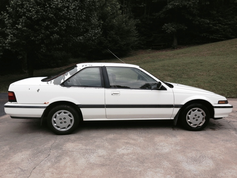

Yep, I'm probably going to keep this one for a long time and fix it up. It had been sitting for a while so it needs just a little work. Here it is in all it's glory. Don't laugh too hard, I only gave $50 for it :)
Attachment 6629
Re: Weird transmission problem
Looks like a great start.
