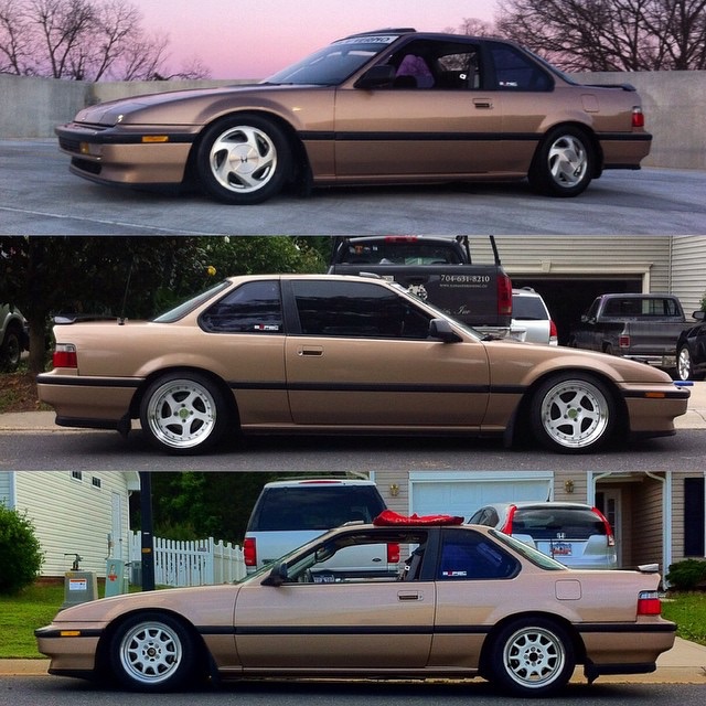

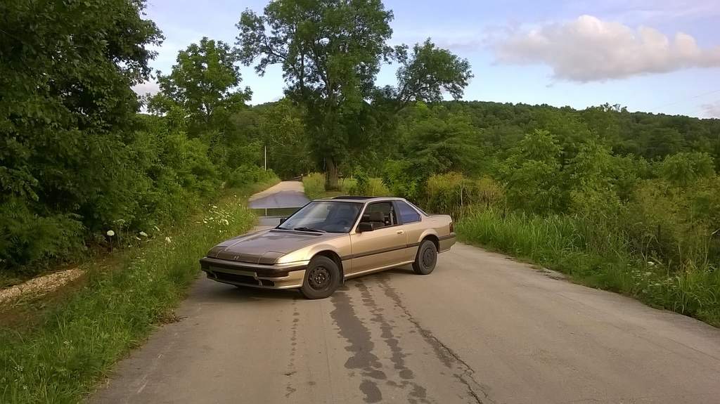

2 Attachment(s)
Re: Will a a20a3 from an accord lxi swap into my 1989 prelude? I want fuel injection!
Attachment 7053 here it is!
This is what I'm going forAttachment 7054
