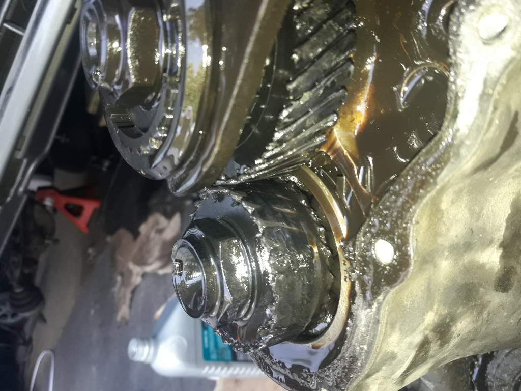

how do you post pictures from your downloads? i want to show every one how my tranny looks but it keeps saying upload failed.
That's some nice sludge in there.
Eek! What a mess!
NO thats because I power washed the outside of the tranny and some water got in there but its all clean now.

That picture tells the story: Lack of proper lubrication... (to state mildly...:toilet:) Use high quality Manual Transmission Oil, keep it full, and change it regularly; 30-50K mile interval. 5th gear will always be there for you if you take care of her.
Keep the oil full.
Also dont drive under 45 mph in 5th gear lugging the motor.
