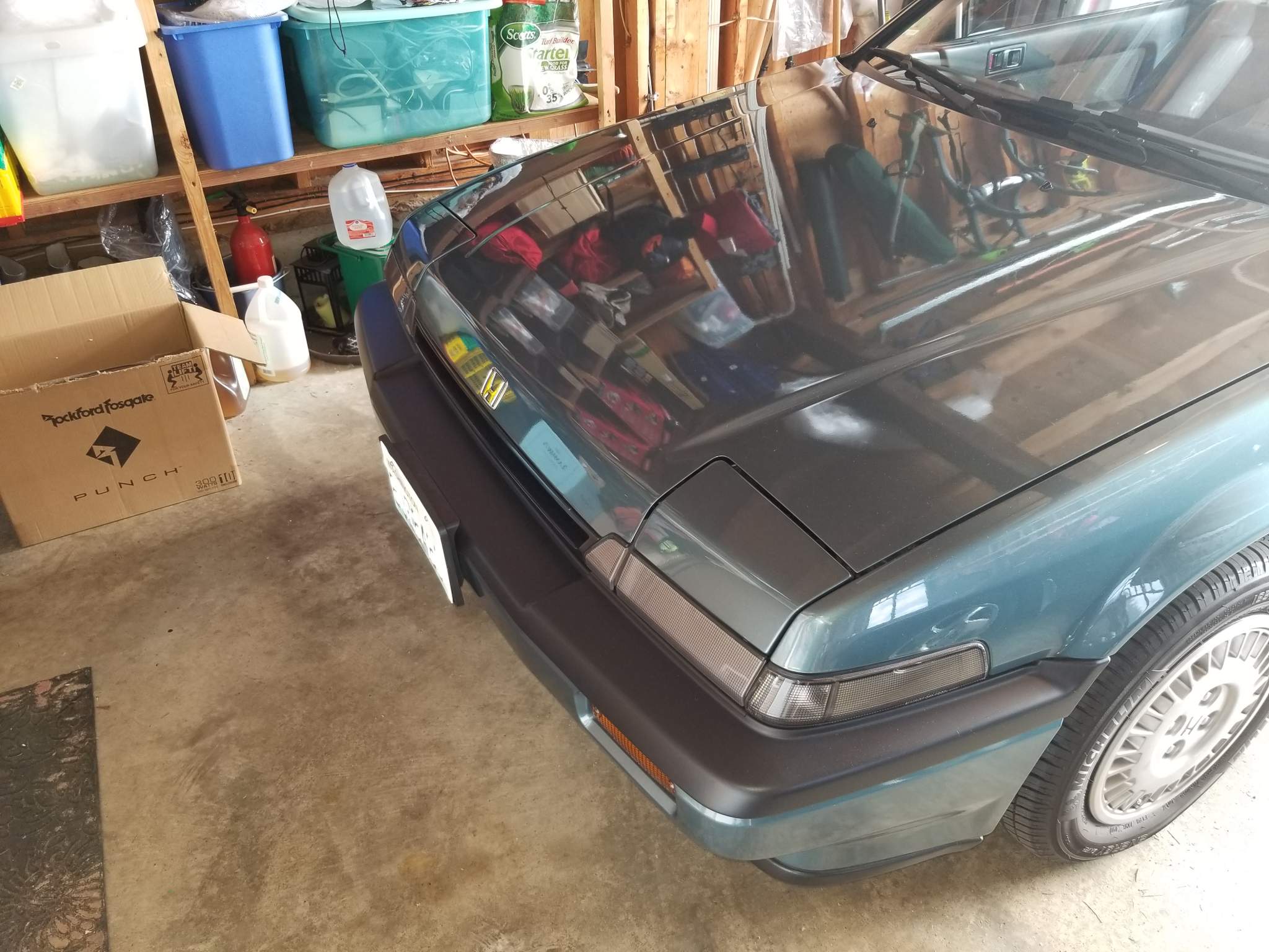

Re: Mounting front License Plate?
I use the bracket for a 2007/11 Honda CRV. I bolts right in and looks OEM.
Attachment 10685
