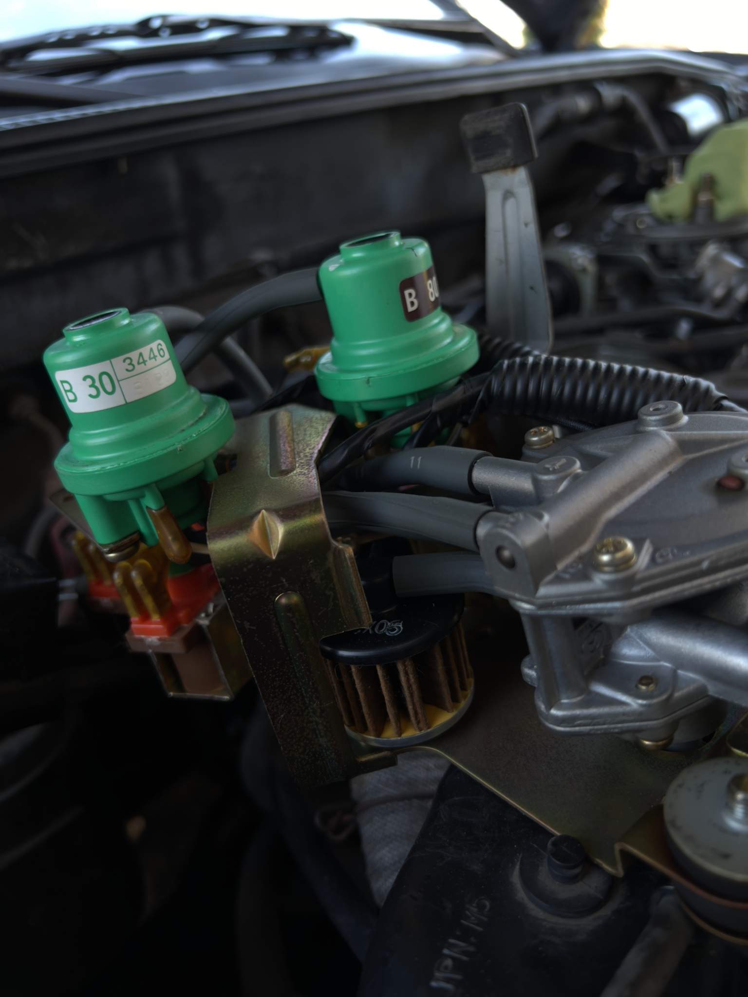

1 Attachment(s)
Yet another high idle thread
Okay so here’s what I’ve done so far:
- My coolant is getting hot, so the thermostat is working (or stuck open, i’ll find out this weekend when I get to it)
- Adjusted the throttle stop screw, it’s backed out all the way for now
- Adjusted all the other diaphragm screws and backed them out all the way
- Sprayed carb cleaner everywhere, for both cleaning and to check for other vacuum leaks (couldn’t find any)
- The one leak I found was the diaphragm of the choke opener
Some more things to note:
- I know I have a bad alternator and already have a replacement, just need to install it.
- The engine/car is very shaky/rattly when the engine is below 2000 rpm
- 4th and 5th gear are shaky only when throttle is applied
- Even with the choke almost closed the idle is still high
What I’m planning on doing:
- Vacuum testing both thermovalve A and B
- Taking a peek at the coolant thermostat when the car is cold
- Complete coolant flush
Anything else I should add to the list? And thank you guys for your help thus far
Video of engine running: https://youtu.be/st2lu6-8Yc4
Black Box Insides
Attachment 11337
