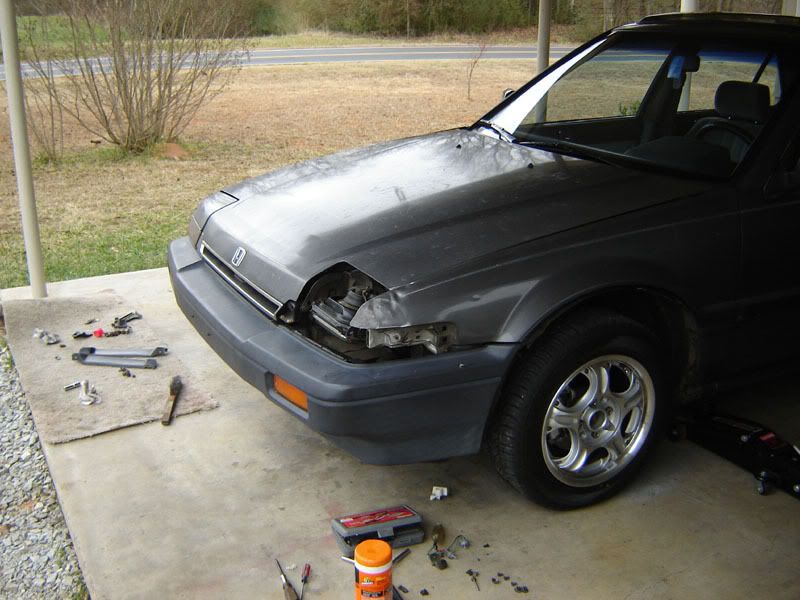

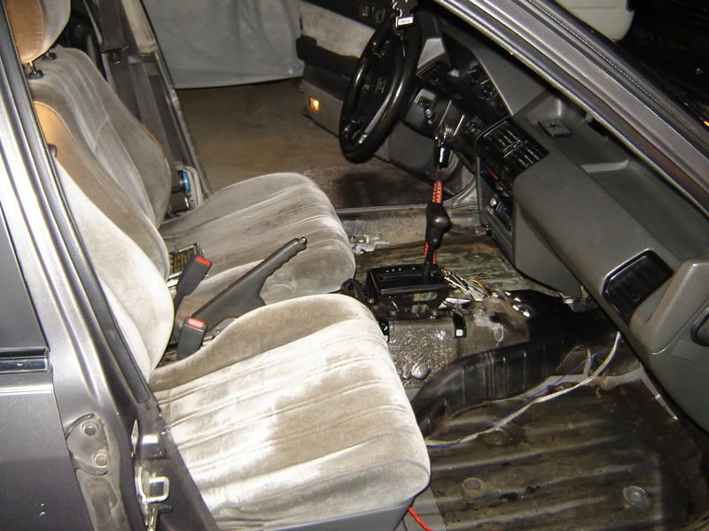

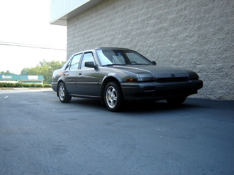

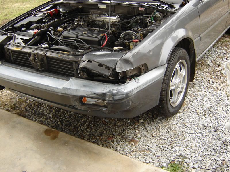

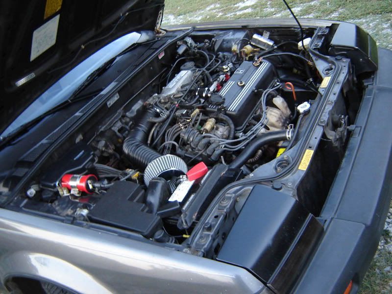

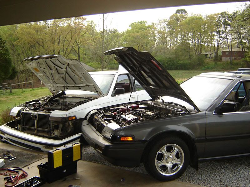

Well because some people were complaining, and also because it needed to be done, here is my update thread. I will go ahead and list my mods and put pics detailing from when I got the car up until now.
Exterior Modifications:
Removed Pinstripe

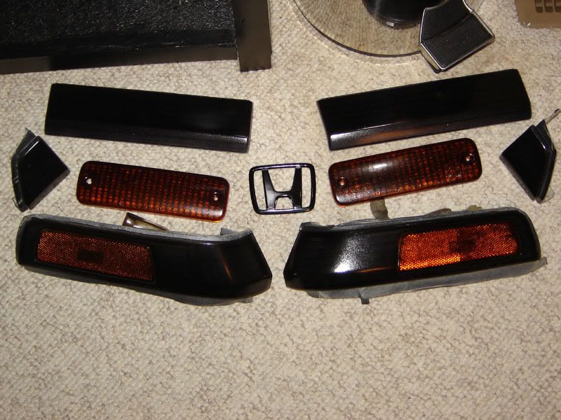

Blacked out frontend including: 88-89 corners and eyelids, 86-87 hatch basic
black centerpiece, blackened turn signals. 86-87 Hatch bumper
Blackened Emblems (Removed LX-i, added 2.0s)
Smoked Tag Cover
Silvania Silverstar Headlights/Or Hella H4 Ecodes
Added Sunroof Visor (then took it off again...and cracked it :()
Painted Drums/Calipers Black
Rear Doorhandle Without Keyhole On Front Passenger Door
Interior Modifications:

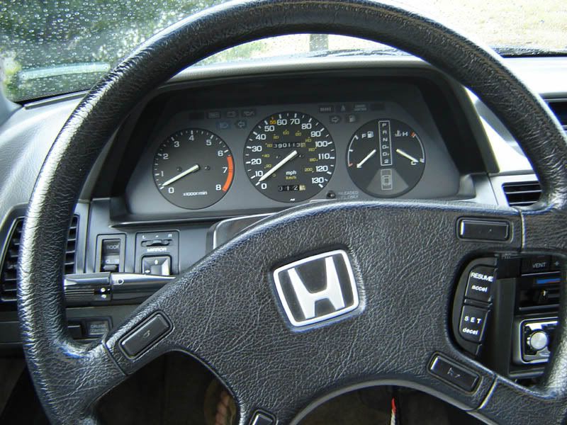

88-89 Steering Wheel (slightly diff. from 86-87)
Pioneer DEH-P560MP Headunit
Pioneer 3 way 150w speakers up front, stock Pioneers in rear
Autometer Pro-comp SRT-4 Boost Gauge in Cassette surround
Resprayed headliner, sunroof cover, and top half of interior in black.
Engine/Electrical Modifications:
MSD Blaster 2 Coil
Bosch Premium Wires
Upgraded Grounds and Added Grounds
Homemade Full CAI with AEM Bypass Valve
Multiple Map Sensor Harness - Info Here---> https://www.3geez.com/forum/showthrea...349#post814349
Magnaflow Muffler
Gutted Catalytic Converter
Relocated Battery to Trunk
Suspension/Wheels, Tires Modifications:
14" Primax European Sports (AC Shnitzer copies) wrapped in Firestone Firehawks
14" MSW O.Z Gold Mesh rims (awaiting tires)

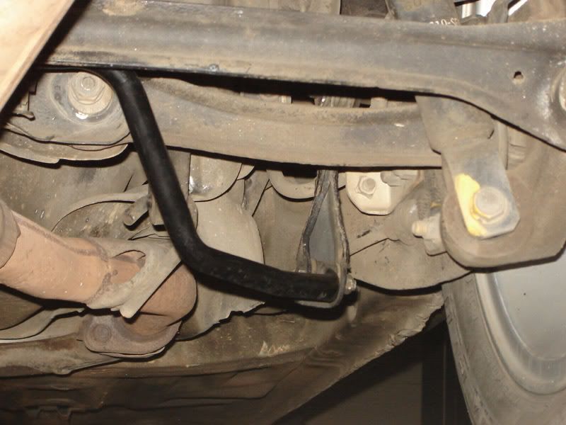

Homemade Rear Strut Bar
Acura Vigor Rear Sway Bar and Endlinks - Info Here --> https://www.3geez.com/forum/showthrea...180#post813180
Full Size 14" Accord Alloy Spare (gone for weight reduction)
EF 88-91 Civic Coilovers Nopi brand front on Accord Tokicos, and Arospeeds in rear with stock civic struts.
Front Vector Tophat Mod
DC Sports Front Strut Tower Bar (removed for now, because of Vector mod)
Prelude Adjustable Front Upper Control Arms
Weight Reduction/Relocation:

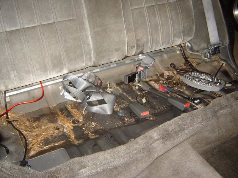

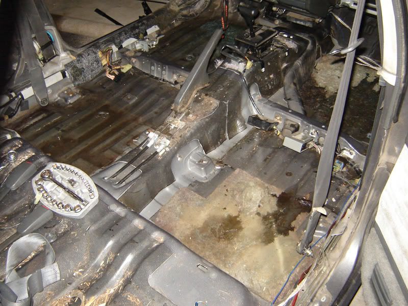

Removed Rear Seat + Bottom Seatbelts + Seat Latch

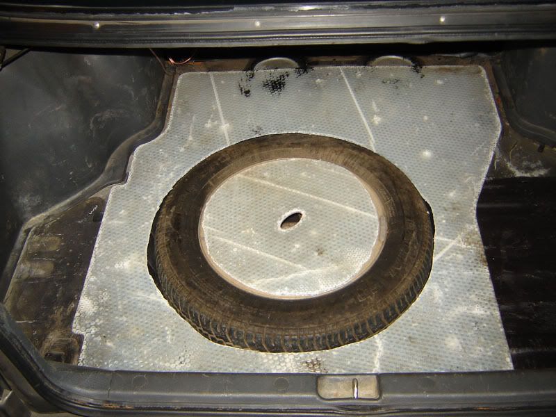

Trunk Sound Deadener Removed
Under Rear Seat Sound Deadener Removed
Ac Compressor, Condenser, Evaporator, all lines removed
Cruise Control Removed
Power Steering Removed
Removed Spare Tire
All rear seatbelts/other gone
Battery Relocated
Misc.:
Repainted Valve Cover
Repainted Heat Shield
Painted Various Engine bay Components
Etc.
Upcoming and Newly Finished Products will be Placed here When Done!

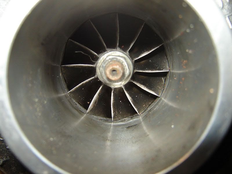

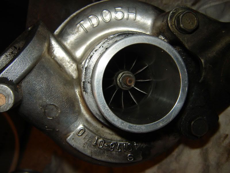

What turbo is that, a 13c/g?
Alex
Originally Posted by
86AccordLxi
Alex
14b 1g DSM

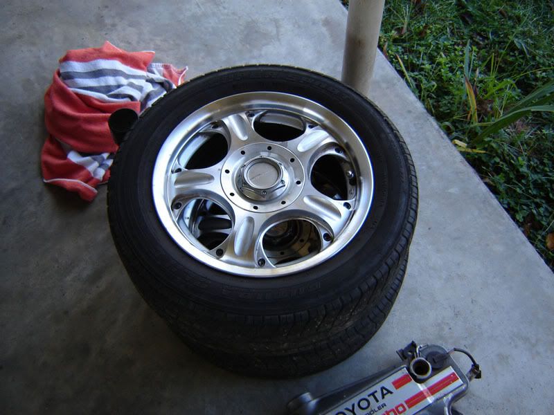

it is good to know the story of the wheels, I was so close to buying some identical to those 18z, but decided it was too much metal too close to the asphalt.. need more rubber and less suspended weight for that to work. In other words, lowered car and tighter spwings.. lol
wonder what happened to Estimated ?
those wheels you have now are so complicated looking, nice though. but from a glance look like S-10 steelies .. no offense, now that i know what they are I appreciate the look.. more pics? more story...
roodoo2
((((( applause )))))
this is gooood stuff, brb .. going to pop some corn
The wheels i have now are temporary. I have a set of meshs, just have to get tires for them ;)
