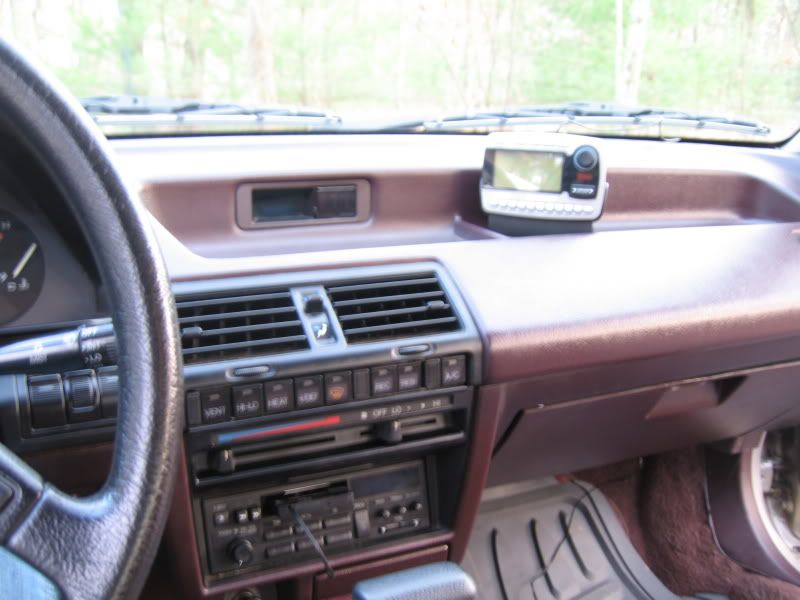

Just thought everyone would like to see how I set up my sirius unit in my car.
I have it mounted on the passenger side of the dash pointing toward the drivers seat held down to the dash using velcro.
http://i218.photobucket.com/albums/c...6/IMG_1612.jpg

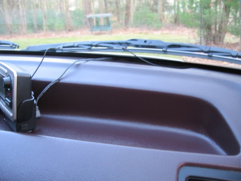

I have the wires tucked into the edge of the dash up near the windshield, and run down the side of the dash.
http://i218.photobucket.com/albums/c...6/IMG_1615.jpg

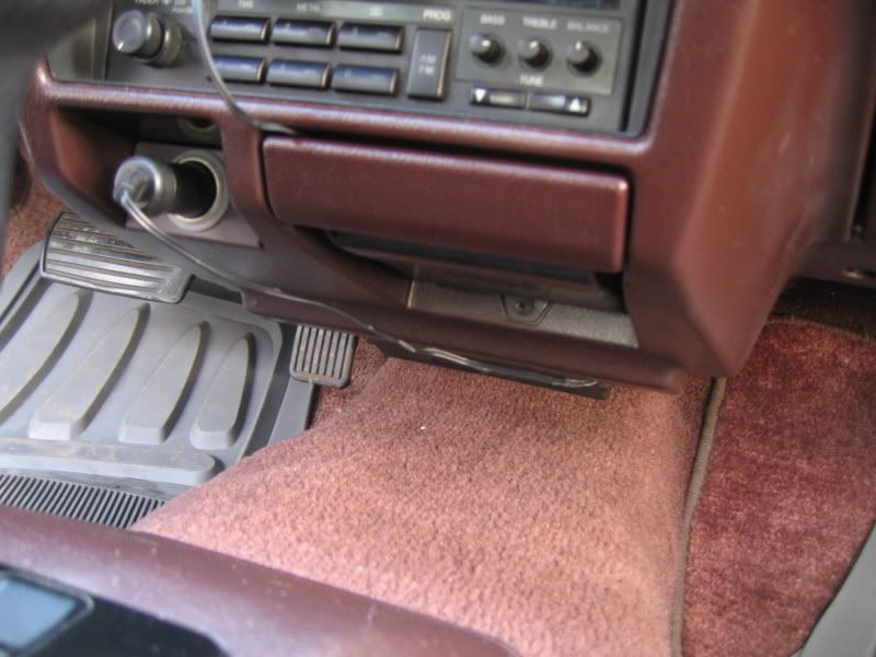

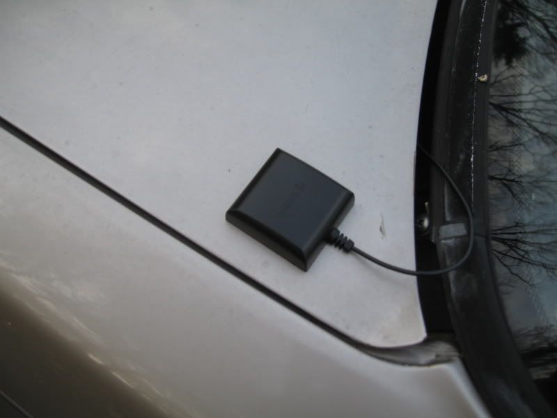

From there, i have the cigarette adapter run behind the glove box and the antenna wire follows though the passenger side of the car tucked under the door sills.
http://i218.photobucket.com/albums/c...6/IMG_1613.jpg

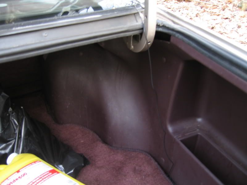

From the back door sill, I ran the wire through the back seats and into the trunk, and ran up the trunk strut.
http://i218.photobucket.com/albums/c...6/IMG_1618.jpg
http://i218.photobucket.com/albums/c...6/IMG_1619.jpg
