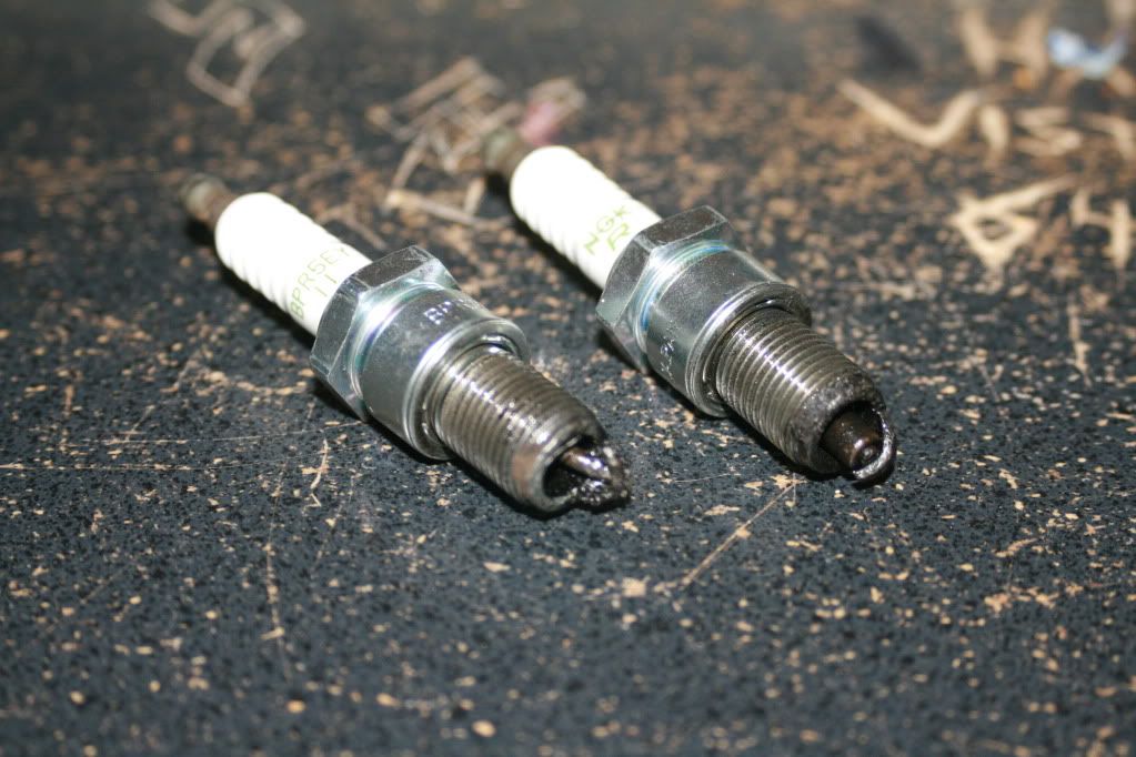

Oh, I forgot to add that part in lol. I Reinstall the timing (Yes I did it right) and it it hitting the valve and the spark plugs looked super cool, I'll post pics of that in a min

what did you do? even if the belt broke the pistons can't hit the plugs.

No idea, car was running bad, turned it off. Came back about hour later went to go and start it and a few noises happened, then I pulled the plugs and they looked like that. So they can't hit huh? weird. But on the plus side The day before me and Strugglebucket were doming on the porsches and bmw's lol

Are all the plugs like that or just two? You might have dropped some valves.
Re: Timing belt slipped off :(
3 are like that and the one that wasn't is one I couldn't change lol. Hey if you have aim hit me up and I'll send you all the videos of you

when my rod exploded the pistion slapped tha fuck out of the head and it didnt bend the valves. it did knick the plug tho.
