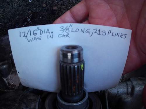

Ok folks, I'm telling you secret stuff that I am the only person in the US knows. 21 splines 3/4" diameter pilot shaft/input shaft, 3/8" long not counting tapered part.
The dummy pilot shaft is the one that fits my clutch and into the end of my crank. specs are above. The tiny pilot shaft or input shaft on the tranny is what I was sent. that has slop in the larger hole that is in the end of my crank.
Attachment 7194

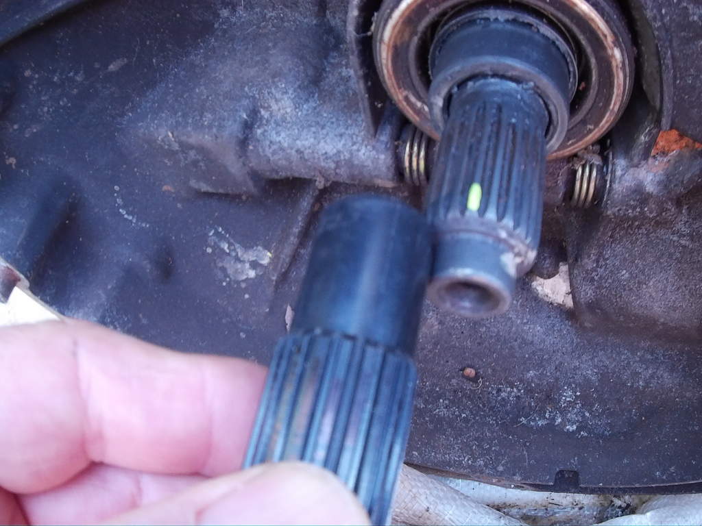

1 Attachment(s)
Re: Thoughts on new manual transmission?
Attachment 7197 You can see difference in size compared to the other pictures. Can you see how close the end of the smooth shaft comes to the splines. This pilot shaft or input shaft is tiny and has a lot of slop when in the hole in the end of the crank. The length of the smooth part is only 1/4 long compared to the one that came in the car length of 3/8". I don't know why the picture came upside down. If someone knows how to rotate it, feel free to do so.
