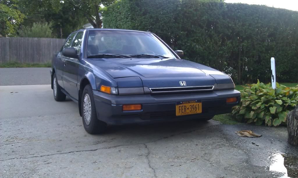

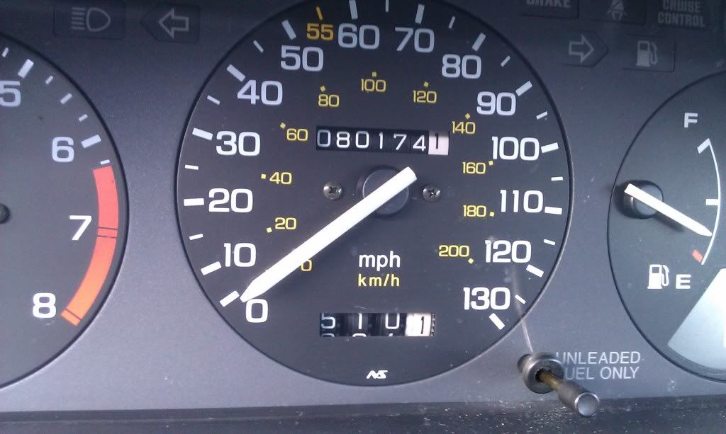

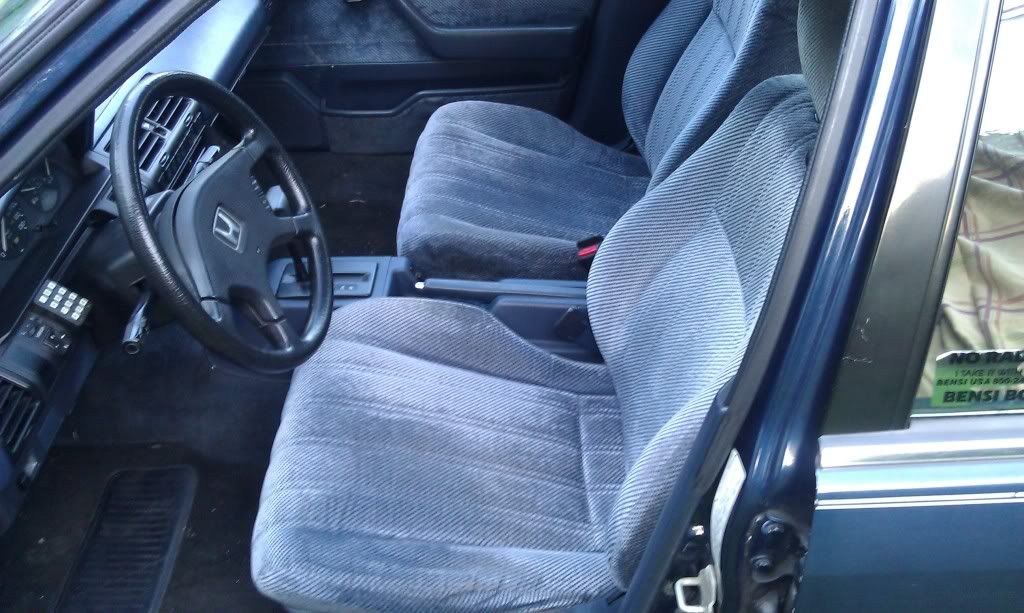

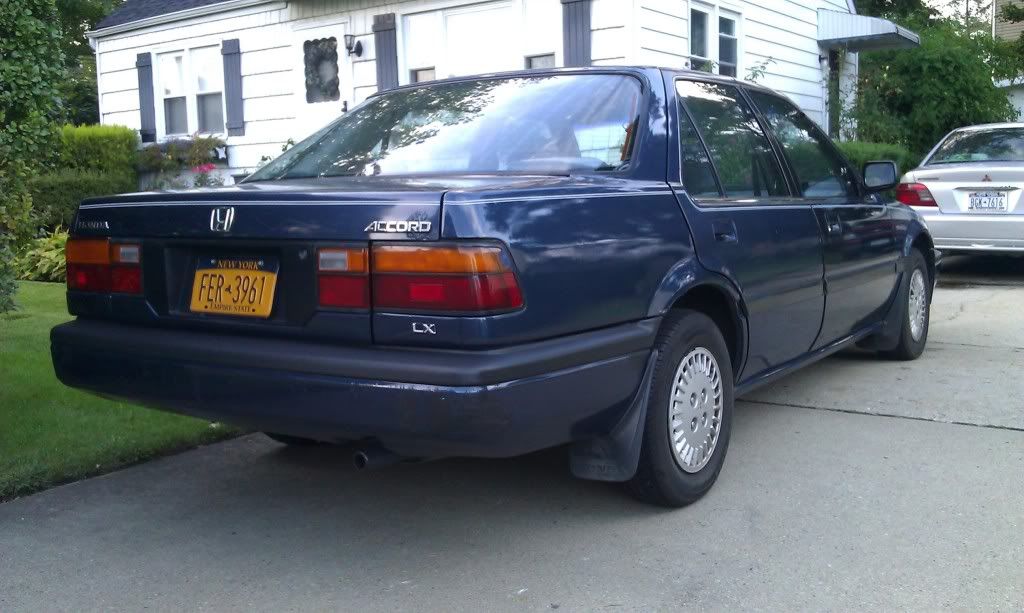

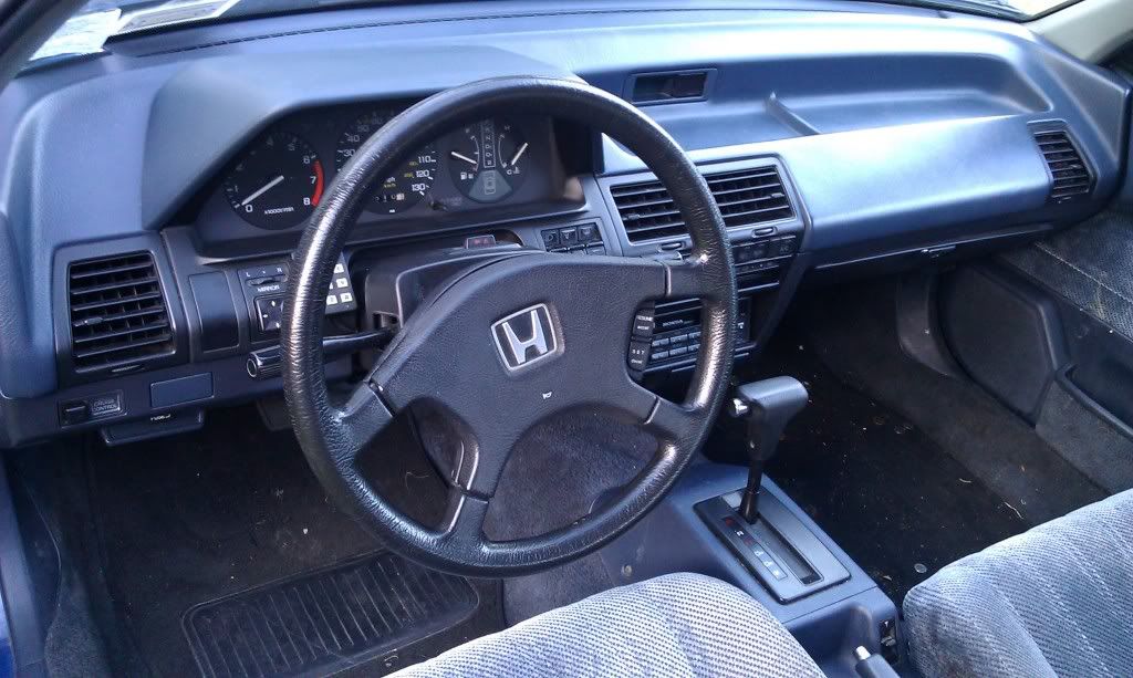

http://i611.photobucket.com/albums/t...z/IMAG0016.jpg
Thought I'd post some pix. As you can see its in good shape. The funny thing is I was just looking for any old cheap car just to commute back and forth to work. Everything I was looking at was bad. I stumbled on this at that repair shop as he was selling it for a woman who could not drive anymore. She was the second owner since 1989. I think I did good. I wasn't really looking for a Honda either. Now I'm hooked and want to maintain and get it running perfect as possible. I'm now a Honda 3geez fan :-)
