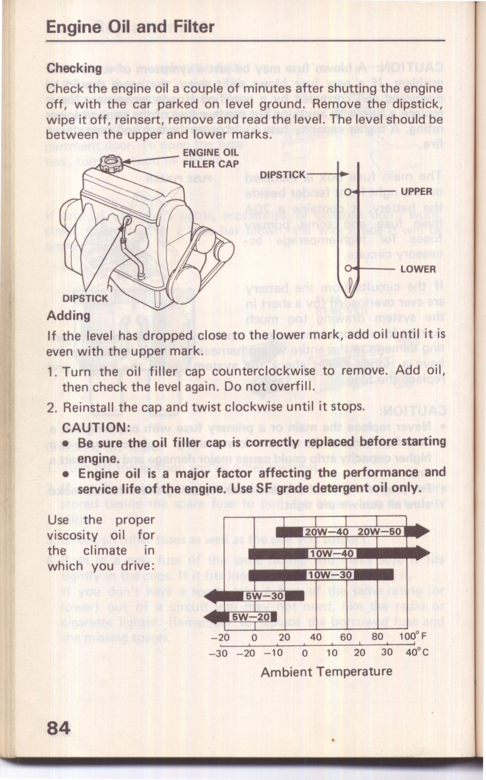

At least verify that pressure is actually bad before you spend to much time/money on it. I currently live in Texas, and our temps get to 115f(268c) here in the summer. Even Honda suggest 5w/30, keep in mind the oil gets thicker in summer. This means you are running 50 weight viscosity in the warmer weather, that is 20 over Honda rec value, and 20 in the winter that is 15 over. Would not be a bad idea to start there. Not sure if foreign (outside the us) oil is rated different.
From the Honda shop manual
http://img.photobucket.com/albums/v6...psb52a821c.jpg

x2. You cannot diagnose anything without a gauge. Hook one up and post results.
Remember that the threads are BSP so you need an adapter (Thanks LOst for insisting on that!)
With regards to oil viscosity, I do not think you have a problem there
Attachment 5074
Unless Honda undertook a radical redesign of the A20 between 1987 and 1988 (my manual is from 1986) you should be fine. I have been running 15w40 because I like to use diesel (in fact diesel AND gasoline) oil. For the GA climate is fine although in the dead of winter it is a little bit heavy
Sorry for posting the whole page but the scanner was acting up.
