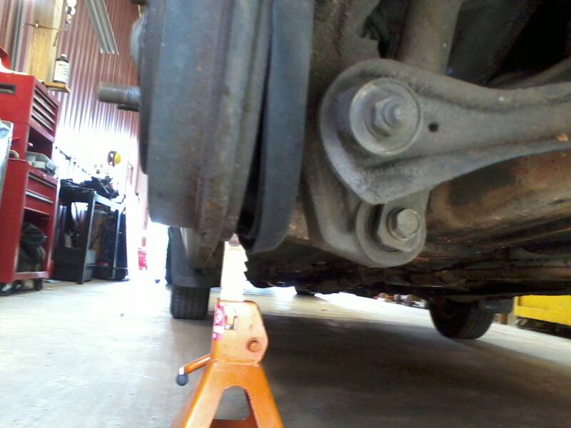

I found out what was causing the scraping noise at random on the car today. Driver side rear brake spring has broken somehow and is rolling around the rear drum. and it's bent not the drum, but the large part the drum connects to. I am not sure what it's called to order it, or even if i can order it for that matter. Hopefully, it won't be a JY part, as these cars are hard to find.
Found this when I removed the tire. Its not supposed to be bent.

Looks fine to me man!!

The picture is showing where somehow the piece behind the brake drum is bent. I could not get the drum off to inspect. This is the only picture I took because of that. I can take a ton of pics of how it's bent though, but I'm gonna warn ya, they'll look exactly the same as the only picture I took. Lol. Mainly, I need to know what that piece is called that mounts at the hub area. The part that the wheel cylinder, shoes, etc attatch to. I couldn't figure out what its called from the manual. All I know is it isn't supposed to be bent. And before I go prying on this whole assembly, I need this new part to reinstall.

Thank you so much. That's exactly the information I was looking for. B-)
