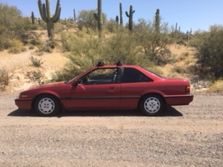

I have always wondered what the status of your car has been for a long time. It has sat at 208k miles for as long as I can remember. We have essentially the same car with the only differences being window tint (or I would die in Az) a roof rack, and I'm lowered a bit. Similarities being the same Alpine head unit, and I had to use plywood in my trunk to replace the original particle board. There have been stints where I have not driven my car for long periods (6 months or more at a time). It amazing how these cars will fire right up after sitting untouched. I had my car in storage for a year while I was stationed in Korea. When I came back, I put a jump pack on the battery, fired it up and drove it to get an oil change. That same day I took it to the car wash and knocked the dust off of it. The next day I began my drive to South Carolina (2300 miles) for the next 4 days and had ZERO problems. A 25 year old car (at the time) that sat for a year rocked a near cross country trip.
This past year, I had to call on "The Little Honda" as it's affectionately called by my family to travel once a month to Utah and back (1400 miles round trip). With the exception of a leak in the power steering pressure line (which I took the belt off and drove around until replacing the hose) this little car has been money.
It's awesome to see you getting your car back on the road. I say this because you have shared your knowledge and helped countless people over the years. I also look forward to that 208k below the picture of your ride steadily increasing in the months and years to come.
Snooze, if you need anything, don't hesitate to ask....and good luck!
Attachment 8819
Many thanks! Your car is looking a lot better than mine.
