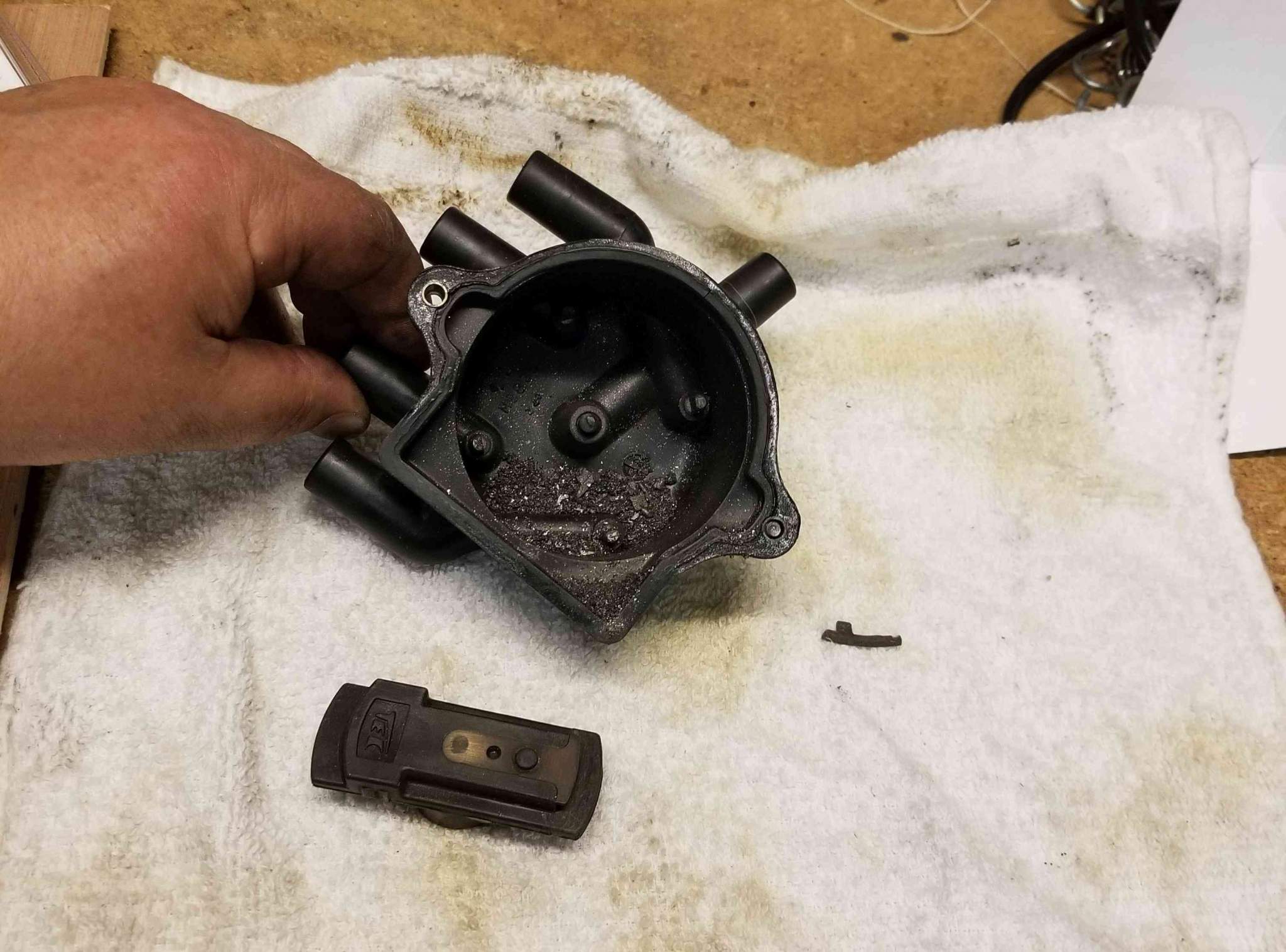

New to the forum, but original owner of 1986 Prelude SI - bought first year out of college. Finally getting it back on road.
Had someone put in new plugs, wires, timing belt, injector o-rings, alternator - got it running good about 89% of time - but would sometimes lack power until high revs - then jump into full power.
Next morning it is dead, turns over but no spark.
I pull distributor cap and get this. Metallic shavings and what appears to be a piece of a retaining ring or similar with a tab - see lower right of pic - this was in distributor cap.
Clean out distributor and install new cap/rotor, as expected no go, but worth a shot for the $.
Anyone recognize this piece? Guessing distributor bearing is shot, but shaft really didn't have much play.
Any other ideas?
Thanks
Attachment 11096

Doesn't look familiar... whats the other side of the dizzy look like?
Re: Have a quick question? Ask it here!
It had debris that I cleaned out with air. Sprocket looking thing( forgot name) would turn slighlty until it hit a stop in both directions, don't even remeber if I tried to turn the shaft - but it is connected to cam/motor right? I shouldn't be able to turn that by hand correct?
Almost looks like water got in your distributor and rusted it out from the inside out.
It would be helpful to take the dizzy off... but yeah there definitely shouldnt have been rust flakes in there

What does the rest of the distributor look like? There isn't enough material in the cap to explain that amount of debris. Clean it out and test.
Get a new cap and rotor for tec (not hitachi) and try again. I am baffled how all that shit ended up in your cap
