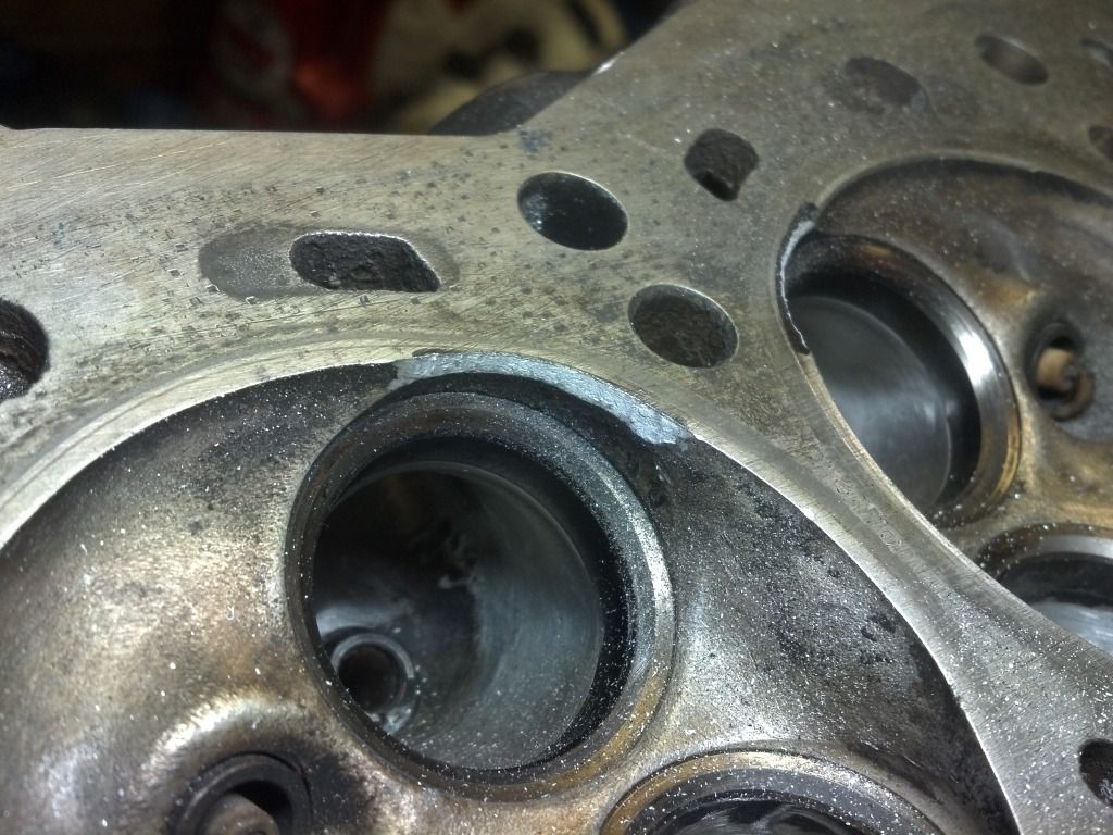

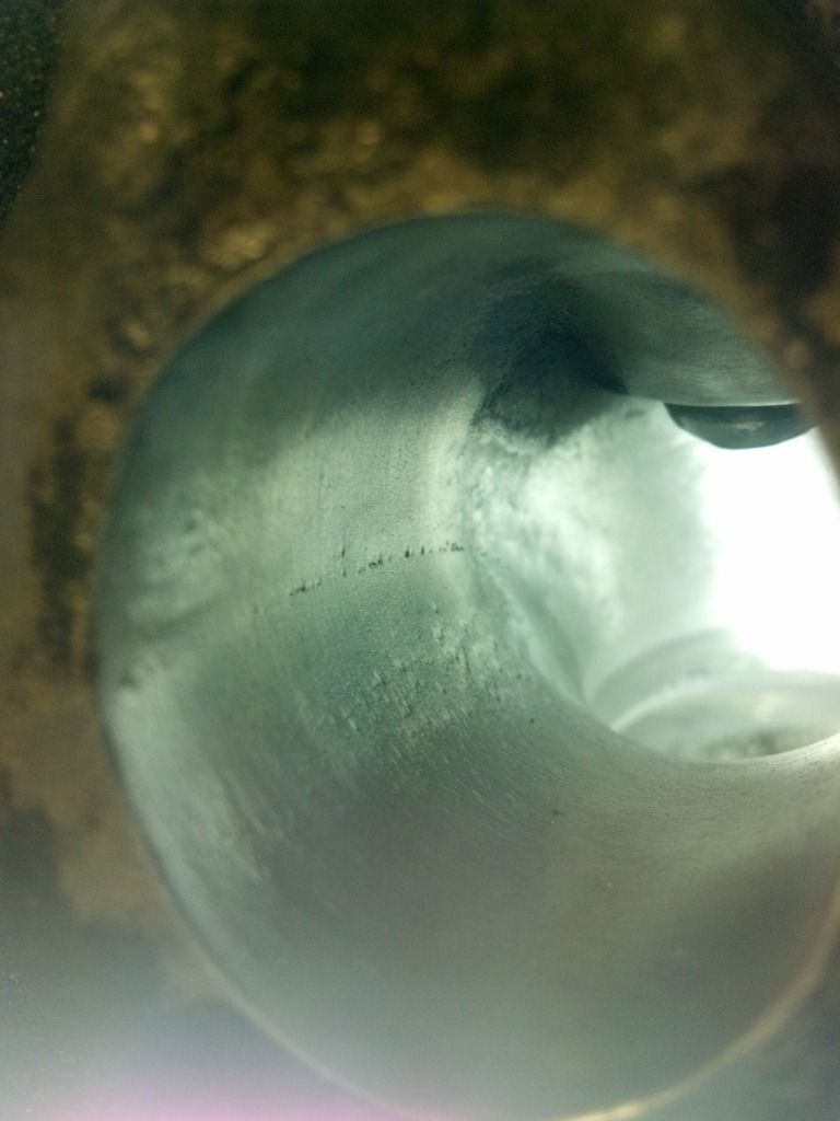

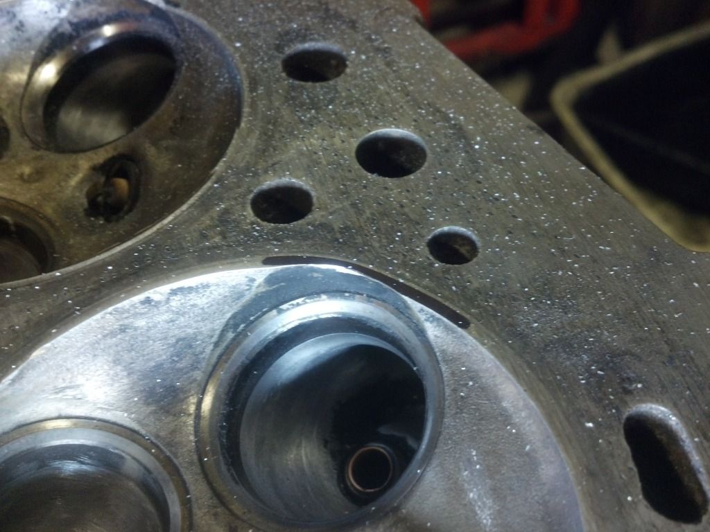

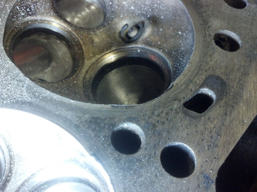

got the head ready to be milled finally, and I got some pics too...

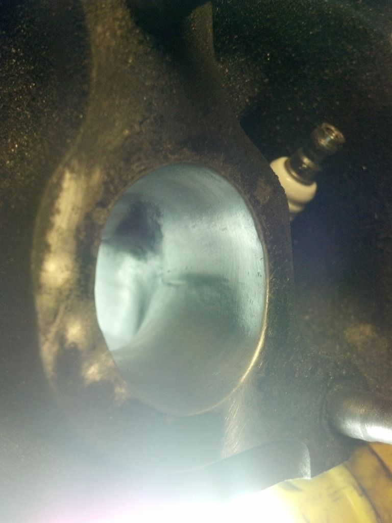

Btw, these are the exhuast ports...
http://i180.photobucket.com/albums/x...-59-29_859.jpg

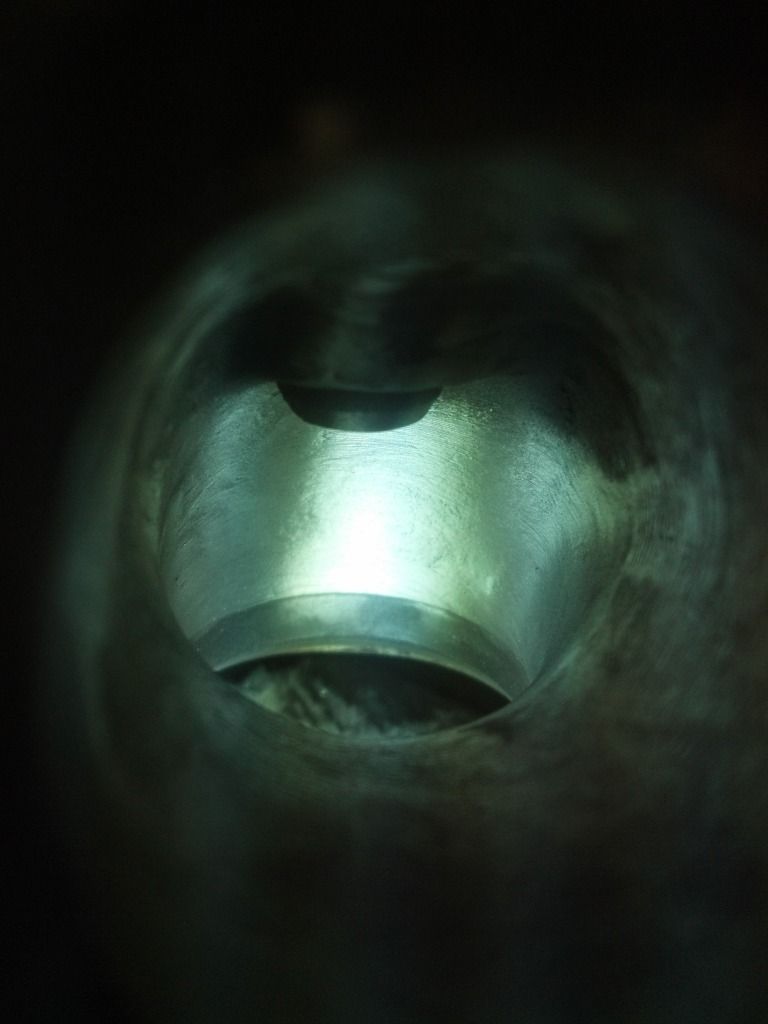

rough cut...
http://i180.photobucket.com/albums/x...-52-23_140.jpg
a little bit smoother...
http://i180.photobucket.com/albums/x...-52-12_879.jpg
http://i180.photobucket.com/albums/x...-59-36_919.jpg
one of the few shots of the deep side...
http://i180.photobucket.com/albums/x...-02-40_612.jpg
smoothed out with 320grit...
I did buff the exhaust ports, but I didn't for the life of me remember to take pictures!!

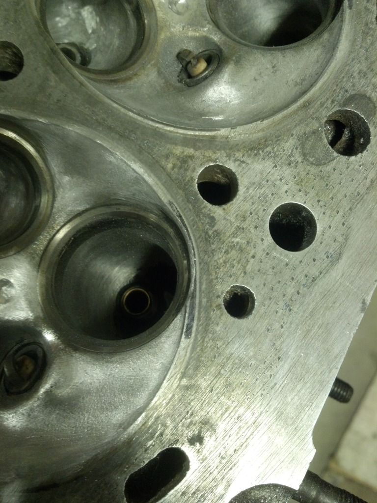

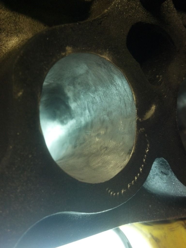

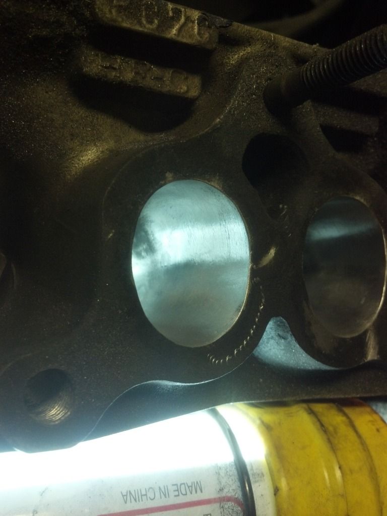

Now the deshrouding on the exhaust side...
http://i180.photobucket.com/albums/x...-14-14_531.jpg
the amount that I want to take out...
http://i180.photobucket.com/albums/x...21-14-27_0.jpg
beginning...
http://i180.photobucket.com/albums/x...-14-34_895.jpg
http://i180.photobucket.com/albums/x...-14-40_558.jpg
more
http://i180.photobucket.com/albums/x...-38-57_543.jpg
not enough, so more!!!
http://i180.photobucket.com/albums/x...-54-58_535.jpg
enough?
Try not to get carried away matching the gasket as it's the bore you need to be inline with. also try and smooth out the edges around the machine edges where they cut into the chamber to put the seat in near the area where your opening up, and also try to use a smoother surface than the one you have currently. Valve seats aren't too recessed into the chamber roof so not much work needed there me being a perfectionist I'd still give them a little blending. Also you haven't altered the shape of the exhaust ramp at all, you can really help flow by making this area more aerodynamic like a sharks fin and you can reshape the guide end as well to suit. You can open up the exhaust ports quite a bit at least a few mm and definately more as you get nearer the manifold. Looks like you got bronze inserts in the exhaust guides have you got the same on the inlets as well? Hows the wear on the inserts is there much sideways play on the valve stems.
Also have the back of the valves backcut to match the seat width if this hasn't been done yet? Have you got a picture of the valves? inlet and exhaust.
Try and go over some of the photo's of my heads to give you some ideas and pointers.
I think you'll be quite shocked how much difference this will make even a basic head job with nice valve seats and matching backcuts creates a lot more flow.

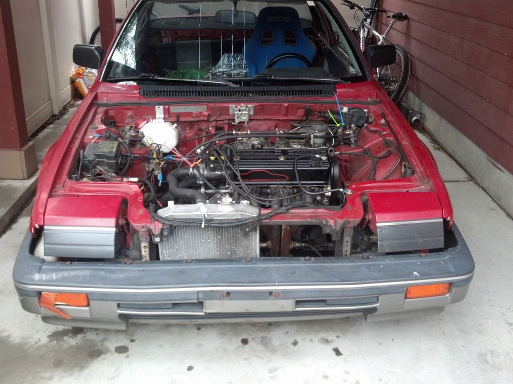

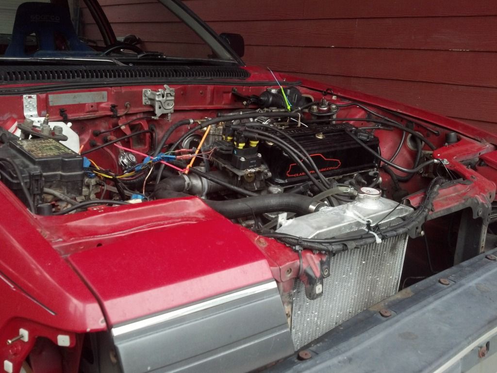

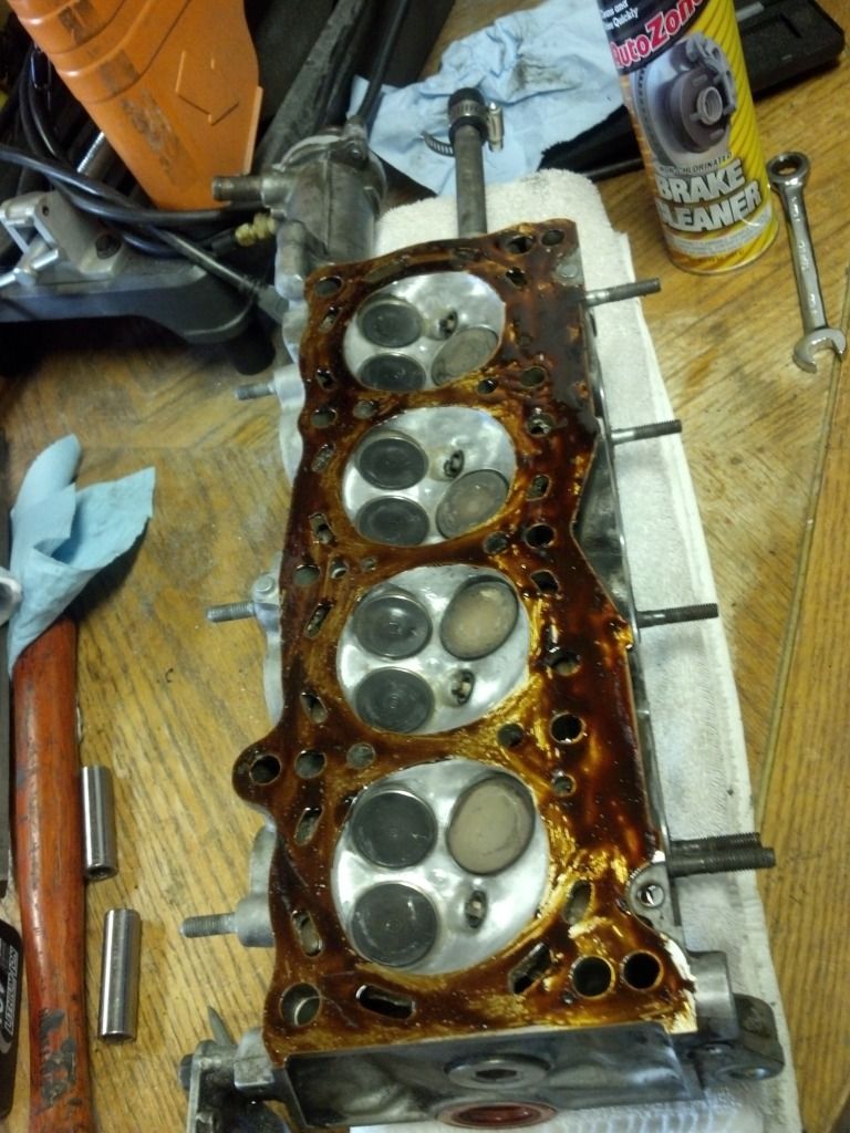

Ok guys, got the car back together... Looking at a small break in period right now, but i'll give you guys an update!
http://i180.photobucket.com/albums/x...-26-20_330.jpg

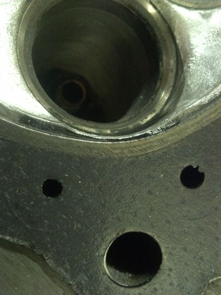

picture of the head with the indian Head, head gasket shellac...
http://i180.photobucket.com/albums/x...-26-39_898.jpg

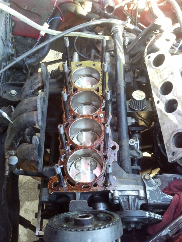

Block with the Shellac... new o ring in the oil control valve and I also replaced the o ring seal for the filter to block to stop the leaking. hahaha motor didn't leak at all except for having to reuse this oring before. no leaks now!!!
http://i180.photobucket.com/albums/x...-49-28_946.jpg

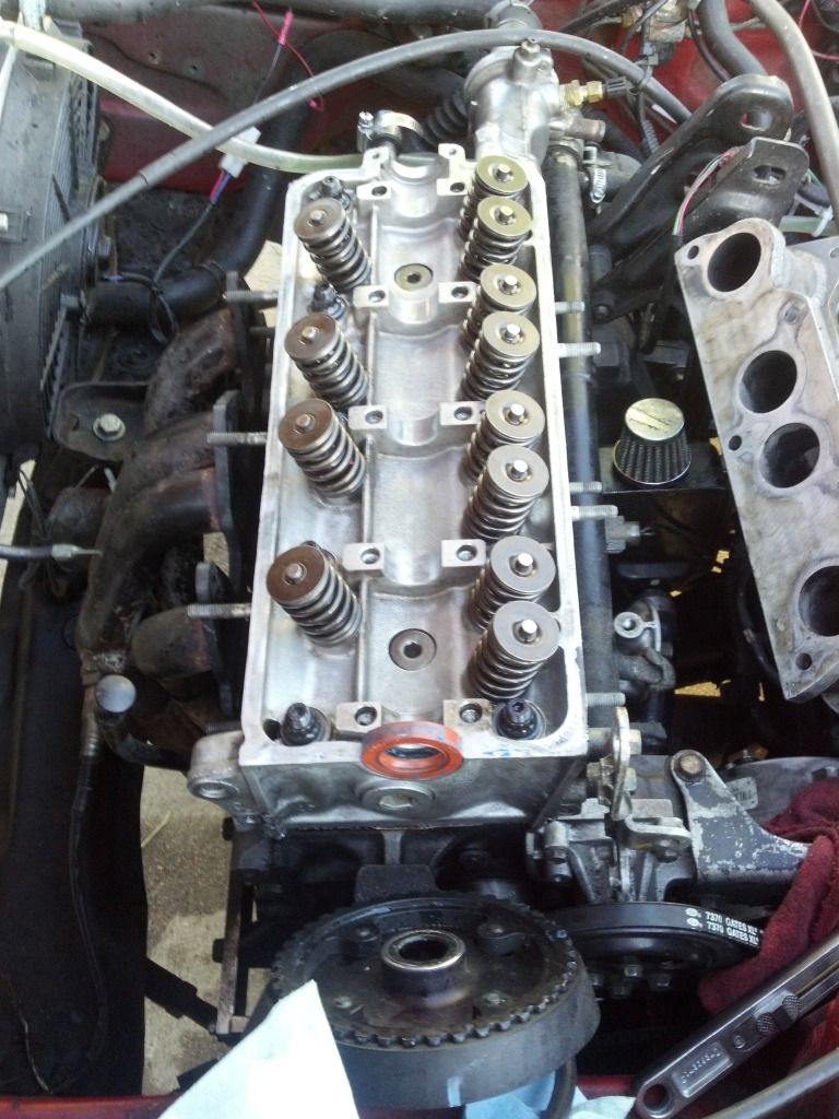

head back on! I torqued it to 20lbs, then 50lbs, 70, and then finally 95lbs...
http://i180.photobucket.com/albums/x...-03-12_767.jpg

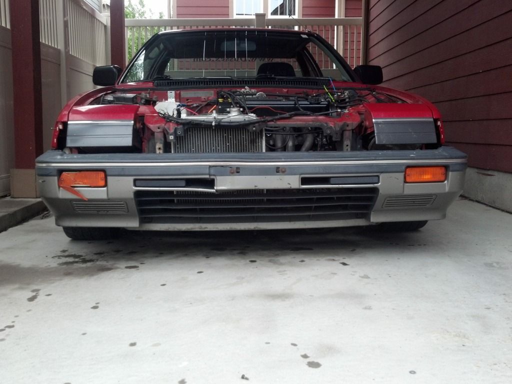

intake and exhaust manifold back on... had a hard time with the intake manifold leaking, so i tried the shellac on the manifold... hope it truely works because it seems like it'd be terrible to clean off! hahaha
http://i180.photobucket.com/albums/x...-03-35_919.jpg

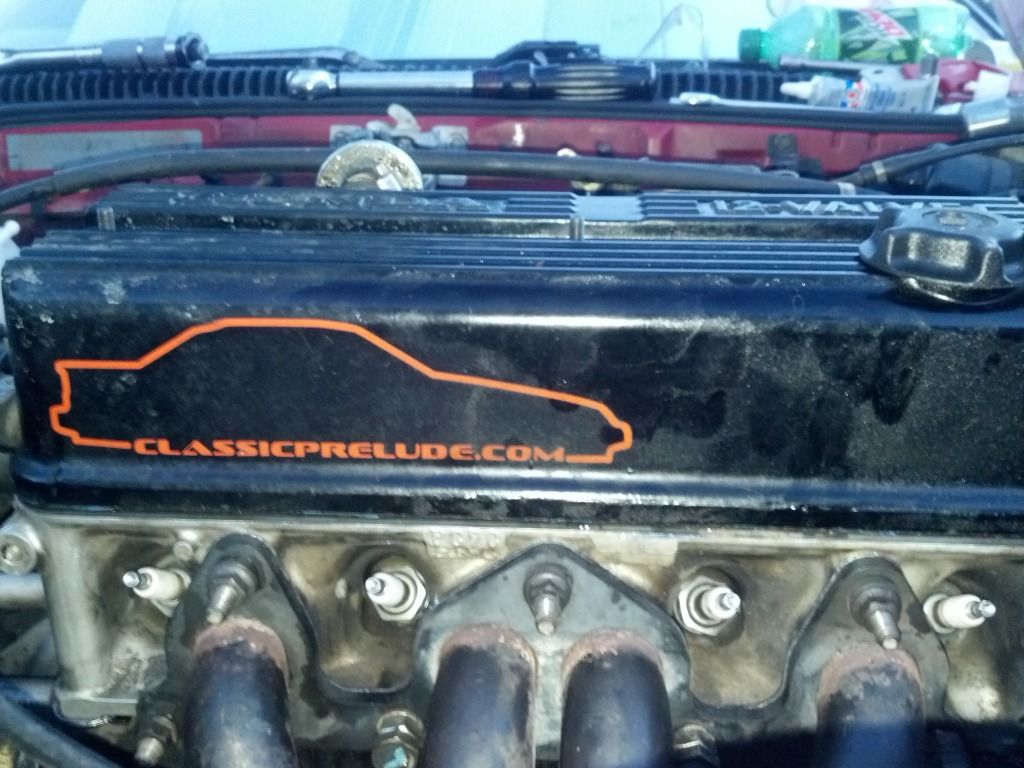

of course more classicprelude luv!
http://i180.photobucket.com/albums/x...-58-45_853.jpg

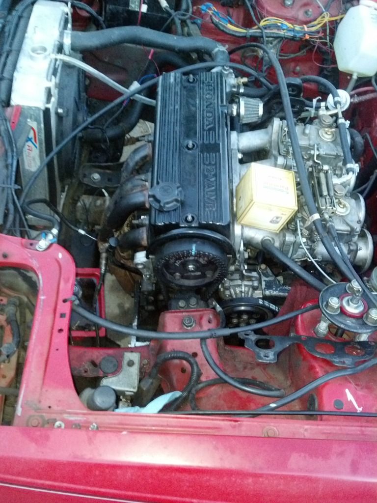

How I've been driving it the last couple of days...
http://i180.photobucket.com/albums/x...-58-58_149.jpg
http://i180.photobucket.com/albums/x...5-59-08_15.jpg
Fuckin' badass picture...
http://i180.photobucket.com/albums/x...-47-08_262.jpg

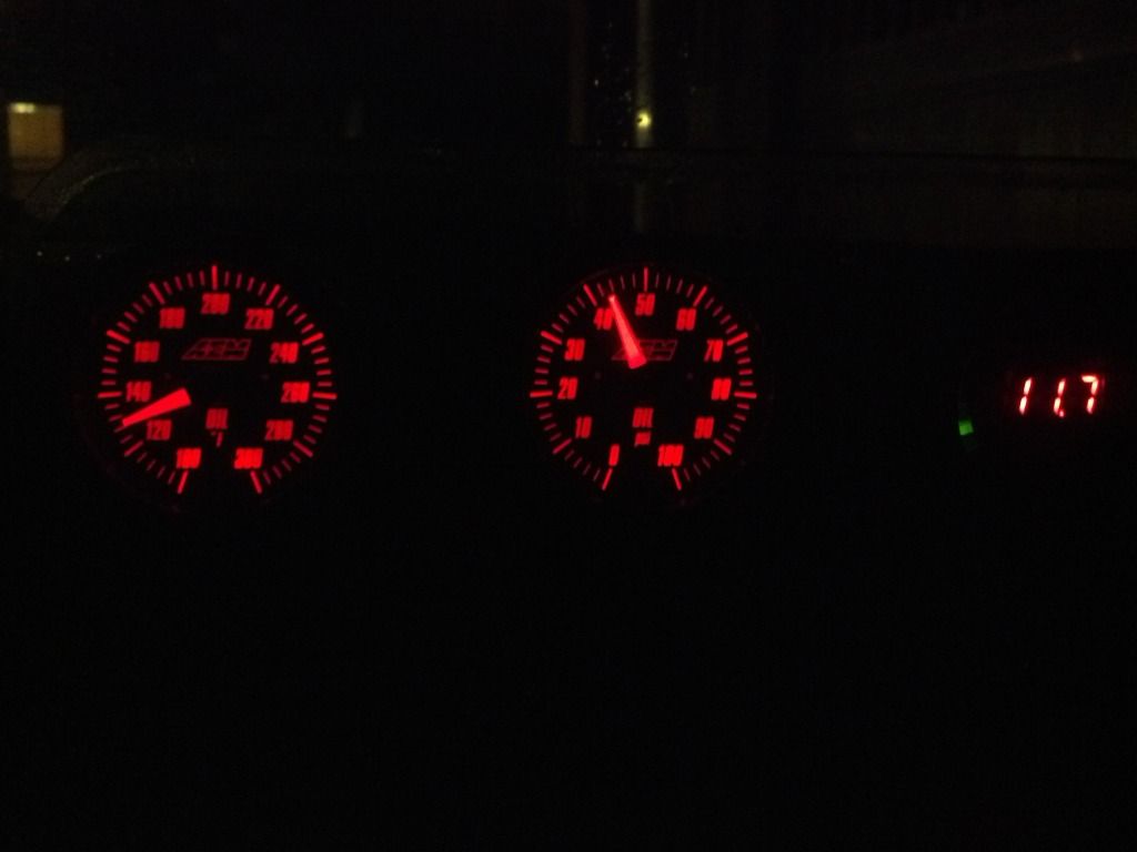

After about 15 mins of easy driving... about 45 degrees here in North Denver.
Per Richard's suggestion I'm no longer running a thermostat, so the temp stays pretty low under normal driving. The Hottest its been since i've gotten it running has been 170... I'm loving it!
I haven't really driven it very hard... been trying to keep it below 4k until i retorque it again. I will say that it seems pretty much the same, with the exception that its running smoother and much much cooler. I've had a couple blips up to 5500... feels pretty good. I'll retorque the headgasket wednesday or thursday, do a little ignition tuning and go to the dyno day on friday with hopefully better results.
furthermore... after much more thought... despite my power being in the 110whp range... I do expect to see in increase in high end power with the head gasket alone. That being said... 110lbs of torque here at 5300feet above sea level out of a 1.8 is pretty fuckin' badass. i'm excited about the potential here... EEEKKKK!!
