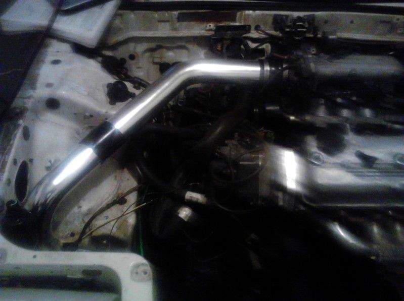

Got intercooler on. Mocked charge piping, need to cut here and there, and I'll be done with that. Oh! And I need to get bov flange on. Thinking about buying Alumiweld and trying that out. Anyone have any experience with that??

http://i19.photobucket.com/albums/b1...115_190521.jpg
Only pic I could get. Didn't have my cam on me. couldn't get better pics cause of lighting.
