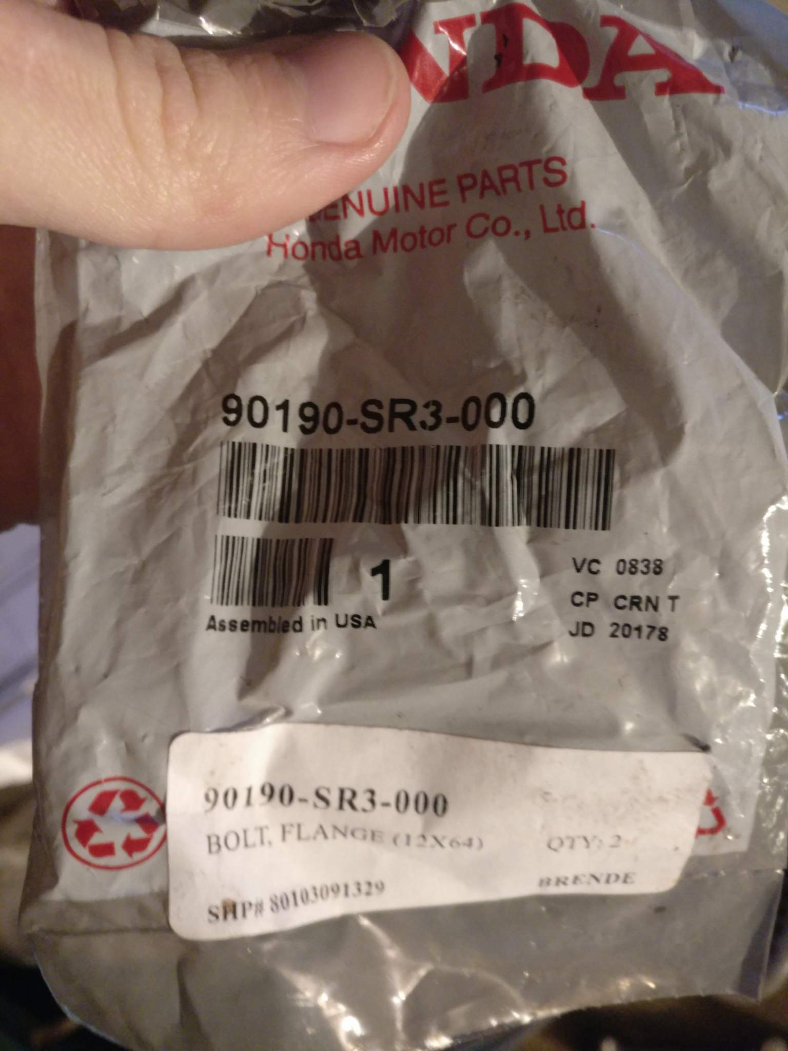

So Ive been driving the car lately. The rear control arm bushings really had me in a bind for a bit. Cam bolts for toe adjustments had to be replaced with oem Honda bolts... which do not actually fit and I have to use a washer to keep the nut from bottoming on the shank. Slapped some new adjusters in the drum brakes aaand I noticed there was practically no wear on my drums. Turns out the wheel cylinders I replaced got the pistons cocked in the bores, so they didn't really move. God drums suck. Whatever, my brake pedal is slightly less sketchy and the parking brake works awesome. I haven't driven it hard recently to see if the brakes feel ok going into a corner, I really don't expect them to be very good until I change the prop valve.
It is getting put back up for a couple days for a health checkup because I think it left another damn spot on my driveway even though it didn't leak a single drop while it was up on stands. I also need to give it an actual alignment before I give myself a reason to buy tires.
Here are the oem bolts I got for the rear subframe.
Top is the eccentric bolts that are too long
Bottom is the bolts that hold the long control arm in the subframe.

About a month ago my brand new brake caliper lost a mounting bolt and hit the wheel, putting a big scar in the caliper, wheel, and broke my valve stem. Everything is alright, its mostly cosmetic, but lesson learned use more loctite, I was running out when I put it together. That day I finished the paperwork to get an abandoned title for a 07 Ford Sport Trac with 113k mi, v8, 4wd, it is a hell of a little truck and I have been driving the crap out of it and hauling dirt bikes, haven't driven the accord a lot since. Part of that is ptsd lol, but the truck is just a bit easier to hop in and go, especially in the cold. I don't really like that, makes me feel complacent, and its part of why I sold the type R. Its fine if I am using the truck though, but Ill probably get tired to the abysmal gas milage pretty soon too lol. I'll probably throw some more parts at the accord soon to get it ready for autocross in a couple months, its definitely nice having another vehicle for that.
So my ford is having problems, but the Accord has nothing but reliable. That being said, I can't stop thinking about modifying it. I have the adjustable rear lower control arms to install, the front upper control arm camber mounts, and I want to raise the driver front a bit in an attempt to corner balance and correct the control arm lengths side to side to get a better alignment. Also still thinking about building an engine. I will eventually, as I've outlined it all here, but money is tight since I went back to college. I need someone who knows a little bit about what to do welding and porting a 3 valve head, that is the biggest show stopper. I'd also love to find some 5.5mm diameter stem exhaust valves to maybe bump up in size, or at least improve flow around the stem. What I'd love to get going sooner is my megajolt, but I really want to get my bike carbs put on. I am planning on getting a 3d printed manifold and 3d printed velocity stacks.
