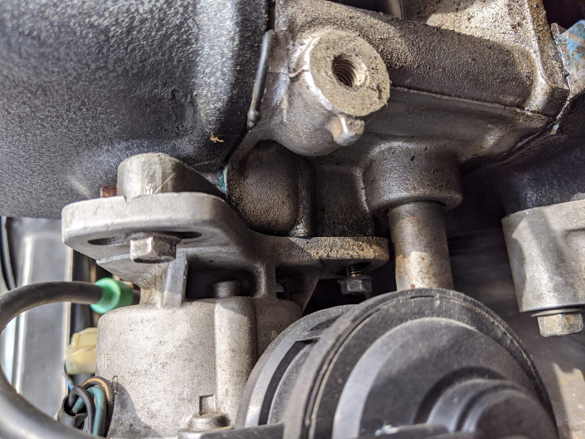

Why wouldn't it? They're the same design on the mount. It fits on mine and I don't see any other heads being different. Heck you could use a fuel injected TEC on a carbed engine provided you have long enough bolts to get through the cam angle sensor.
Unless theres some California engine fuckery that I don't know about.
I thought mine was going to be a survivor. Sike! I was going to let one of my friends drive it before tach bounce... funny I said I'd let him drive it the same day my clutch stopped reacting to pedal input, and the time it started growling... I don't mention his name around my car anymore.
They mount differently. You have to replace the mount and to do that, you have to remove the valve cover and replace the cam cap. Easy for you, but I think OP wants his car to run without having to do head work, or having to run around junkyards looking for scarce parts.
Really? There was no difference on mine, I did not change the cam cap. It mounts normally, I have it basically in the middle of it's adjustment and there is tons of it. The ears are no wider or narrower. I'll have to look at the cap on the engine I pulled it off of, I didn't notice anything different. Here's a pic for proof... Ignore the backing out bolt, I just noticed that.
Attachment 10721
The one has a big long stud on it.
