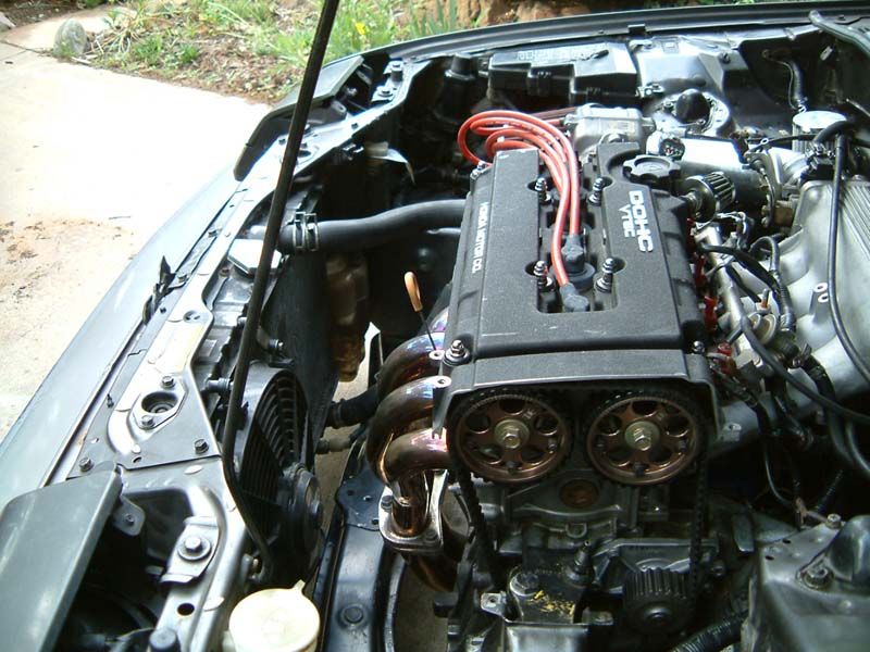

i give you props on the tuck legend master. I did a tuck on all my injector wires. the 2 wires you tucked ar the only ones i need to tuck on that side of the car. I have to say that makes your bay looks soo clean

you rotten mother f$%^ER, DAMN THAT looks good. very nice job on making it like factory.

Thanks, I cant decide If I want to tuck my injector wires through the manifold or I might just use the factory plastic piece that cleans them up a little bit. I know the resistor box could also be moved to the inside of the fender (actually the front bumper) on the factory a20 application.Quote:

I just removed the plastic piece and tucked it behind the mani so all you see is the injectors. keep upthe good work.

Yes it is a megan racing I got off eBay. I would not suggest getting this header unless you modify the end of it to a 2.5 inch collector. Besides that I have had no problems and I only paid $150 shipped.

On you pics, I was wondering where did you put your battery wires ?
Originally Posted by Fushi
Since I removed the AC there was a hole for the AC water dump. I used that hole and ran the wire to the trunk.

The 2" diamter pipe after the secondaries should keep tq lower in the RPM range, but as legend said you can up the diameter to 2.5" That is the maximum you should go though.
I didn't like where they placed the flex joint on my accord 4-2-1, I will eventually ditch the flex entirely and make it all 2" pipe, with 18" of added lenght to the pipe, then exit into a 2.5" pipe or muffler depending on the room available. I'm also ditching the flex because it was the part that was defective and causing the leak so I'm kinda forced either way.

I dont see why it would not be possible on the b20, Just run the wires through the fender and you are set. Just remember that I removed everything having to do with AC, Power steering, and Cruise control.
theres a few things m planning on tucking soon , urs looks super good , ive gotten a bunch of ideas from your car , im porbly gonna tuck the vaccum reserve canister and the the fuel injector resitor box , im gonna try a couple of other things like the blaster coil maybe , im also gonna try shaving and polishing a valve cover as soon as i get my hands on a second .. man your hatch is soo sick ... im jealous
