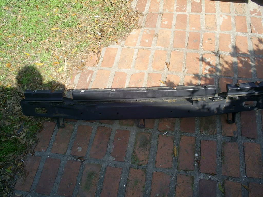

i haven't put in the new steel part yet,been digging up old dead bushes and putting in rose bushes all day. been rolling in the dirt all day. heres the steel bumper part i got from the yard. i'm making a piece right now that attaches to the center section i made,about to go to the hardware store and pick up some socket head bolts as a matter of fact.

ok the old steel bumper is out,what a piece of shit. i forgot how bad it was,this steel bumper was put on the car at some point in the past, the amount of rust on it,doesn't match the rest of the car. the new steel bumper i got is from a southern car also,and it doesn't have any rust. this car has always been in the south from the records i found on it. only minor difference,is the 86 steel part has two pieces that help hold the bumper shape on the bottom,and the 89 has three. this is not a major problem,the plastic pieces on the top where the screws go are the same.

son of a bitch i think the hatch rear steel part is different despite what everyone on here says it's almost twice as thick as the hatch steel part
Re: i have the solution to the rear lip on the hatchbacks
ok it fits but barely. the steel box section on the sedan bumper is twice as thick as the single box section on the hatch. actually sits up against the sheet metal on the car. i slid it in temporarily to make sure the bolts went through. i will try to pull it and paint it tomorrow, it looks awesome. too dark for pics tonight,but i will get some tomorrow. this really finishes off the rear of the hatch. the splitter looks like something ferrari would have put on it. it def was worth all the hard work.

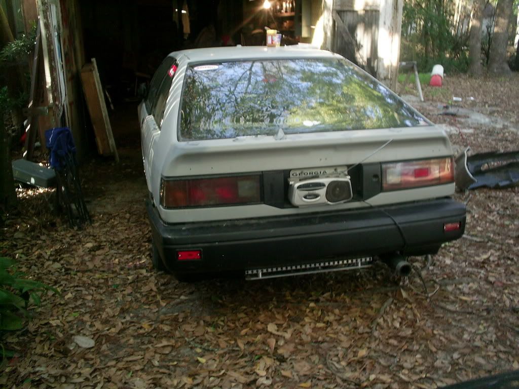

the dam 88-89 bumper doesn't fit:rocket: so i need to take it all back apart and go back to the junkyard to pull an 86-87 inner steel bumper. the dual cross sections just don't fit. in the picture the ends aren't connected and i haven't painted it yet. was just trying to get an idea what it would look like.

does anyone know for sure that the 86-87 sedan rear bumper will fit the hatch? this is going to be a pain in the ass to go pull another one. the bumper cross section is too thick and won't slide up all the way. so theres a huge gap. someone needs to put this in the sticky section that 88-89 steel bumpers don't fit 86-87 hatches or possibly sedans. there is some misinformation floating around about them
