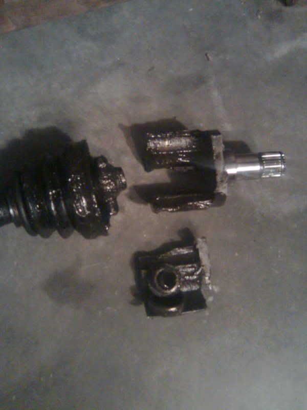

Re: axle replacement.. help?
heres the damage guys...

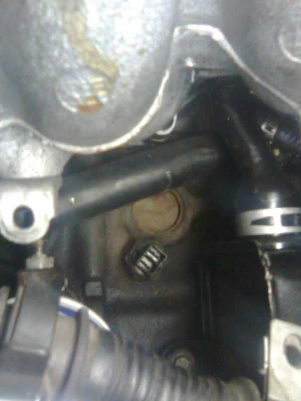

and off topic.. i found this sensor on the block and dont know what its for..
note: i have the a18a1 block with my 2.0L fuel injection

Youch on the CV! As for the sensor, could be an aftermarket coolant one.. don't see it being much else.

yeah man.. the cv was toast.. and if the sensor isnt used then eh ill just leave it dead
haha wow that cv got OWNED
I believe the sensor is coolant temp sensor for the carb ecu. The a20a1's have them in that same location but the a20a3's don't.
