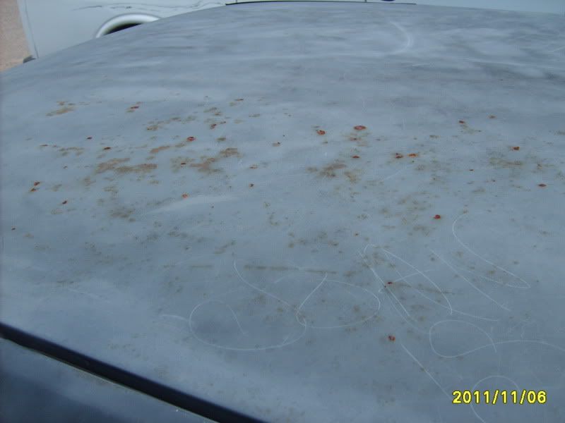

Question... How do you guys deal with rust so it doesn't come back? The previous owner said he spent a few back to back weekends sanding away the rust, buuuut, as it would seem, it's starting to come back, the most of it is on the roof, a little on the hood, but nothing major, a few odd lines of rust, but the roof looks like this..

one way is to grind the hell outta it and use a rust converter / remover like navel jelly ( be careful products like these usually have some kinda of corrosive acid in them) or even better is getting some POR-15
Re: Just me and my scrubby Accord.. :(
I wouldnt "grind" it , esp on the hood or top, it risks warping the whlole panel.
You can use 60 grit on an orbital sander.
Looks like you could just go over it good with 100 to 150 grit to get that surface stuff off and then take it down with 180 and reprime. There are several primers out there that turn black (rust converter) and work very well and killiin the rust from coming back. The issue then will be letting it cure out good before resanding it, to then start applying surface primer to smooth it down good enough for a semi flat paint job I believe you said you wanted.

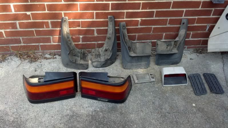

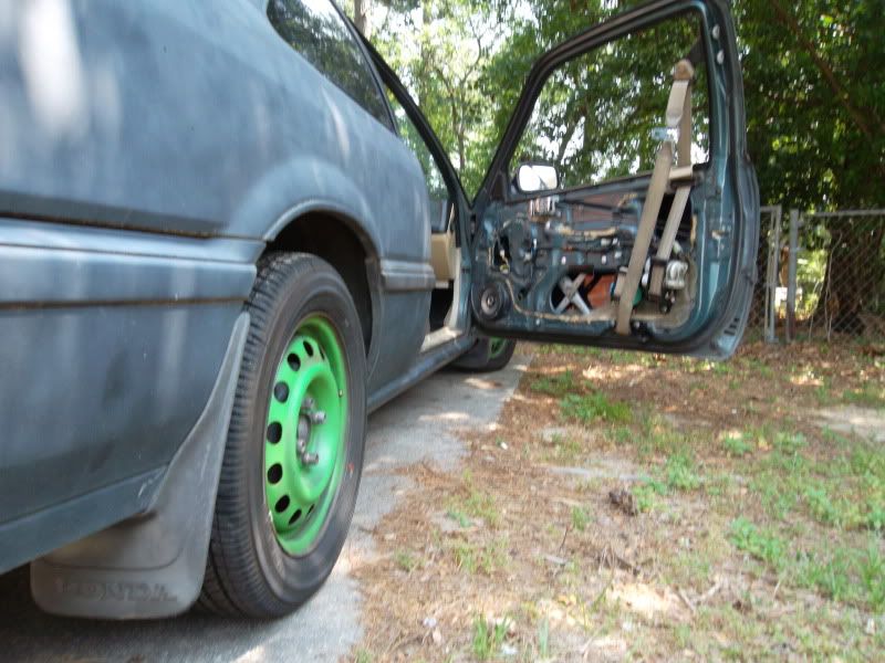

I've gotten some work recently done on the car, and to give a general list of it all: i replaced the front struts because they were gone, car rode like a boat, got the exhaust fixed up, put Roo's pipe on there, and my buddy put my old muffler on the end of it, i've got a set of DC headers I still gotta put on, having some issues with disconnecting.. [RuSt] I got door panels, an overhead light, a new 3rd brake light, and since right before I went to Basic Training last August some lady backed into my car, I had to replaced the brake light too {did them both so they matched}. I also got some mud flaps, cause they're spiffy to me and I like them. ;) Pictures below!
