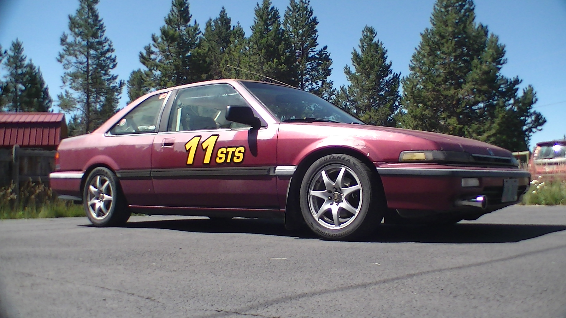

Hell yeah, repping the STS class too. Lmao
You can actually get adjustable rear arms for cheap, run these instead of those stupid eccentric bolts, there's no way the rear of the car is actually straight and true to the front.
