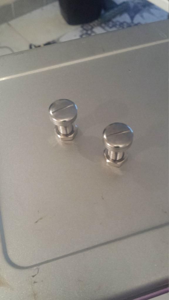

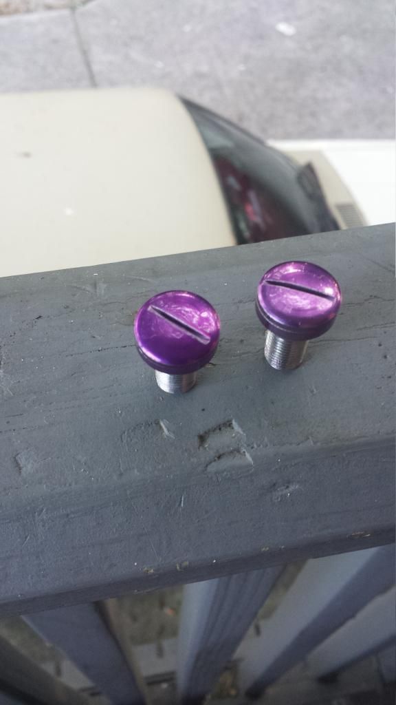

First i took these cool little flushmount valve stems:
http://i28.photobucket.com/albums/c2...729_172546.jpg
then made them look like this:
http://i28.photobucket.com/albums/c2...729_193721.jpg
im kinda mad tho. this is 2 sets of valve stems that i coudnt use on my wheels... so ive kinda given up on these wheels. ill just keep them for another wheel i guess.

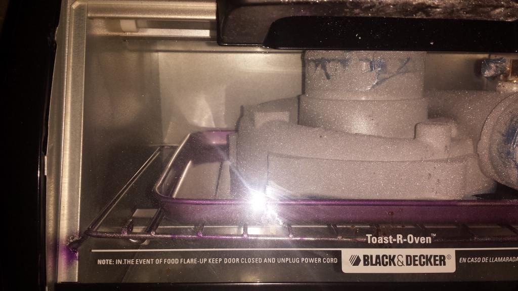

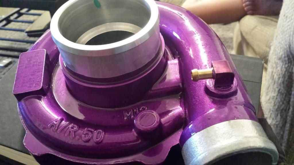

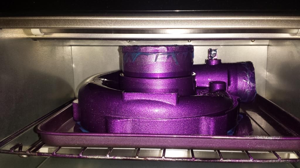

But the main project of the day was this. I didnt take a before pic cuz i was too excited lol. so it goes to the backing pics first
http://i28.photobucket.com/albums/c2...729_205230.jpg
had to do a silver base to get a nice finish
then did this
http://i28.photobucket.com/albums/c2...729_215155.jpg
^^^fresh powder turns into this vvv
http://i28.photobucket.com/albums/c2...729_222901.jpg
http://i28.photobucket.com/albums/c2...730_001717.jpg
it came out pretty freaking good imo. I need a bigger oven. to do cooler parts now. and more colors

Epic turbo!!!
Fixed but no tiny Tim turbo... Lol
That turbo dude is freaken ugh no words lol you came a good way with this build and inspired to finish my swap to the accord and boost it quick question that powder coat would up to the temp? Never actually understood powder coating.
Oh how cute. I got nicknames now! Lol
The powder is actually really fine plastic that you melt into a coating. It bakes/cures at 400-450 depending on a few things. But its supposed to be good on most things that dont deal with exhaust temps directly. Idk the exact temperatures tho. Ill find out.
Well that's awesome I can't wait to see it installed gonna look real sharp that's for sure
Prismatic Powders: How well can the Prismatic line handle heat situations?
their site says 400 degrees is what it can sustain.
