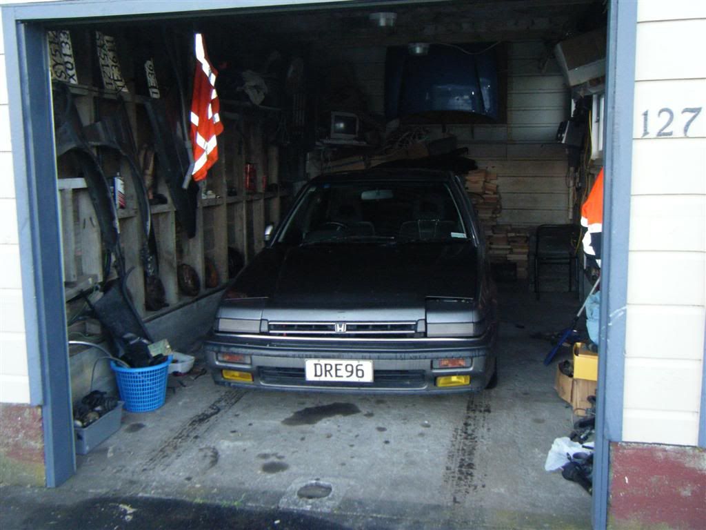

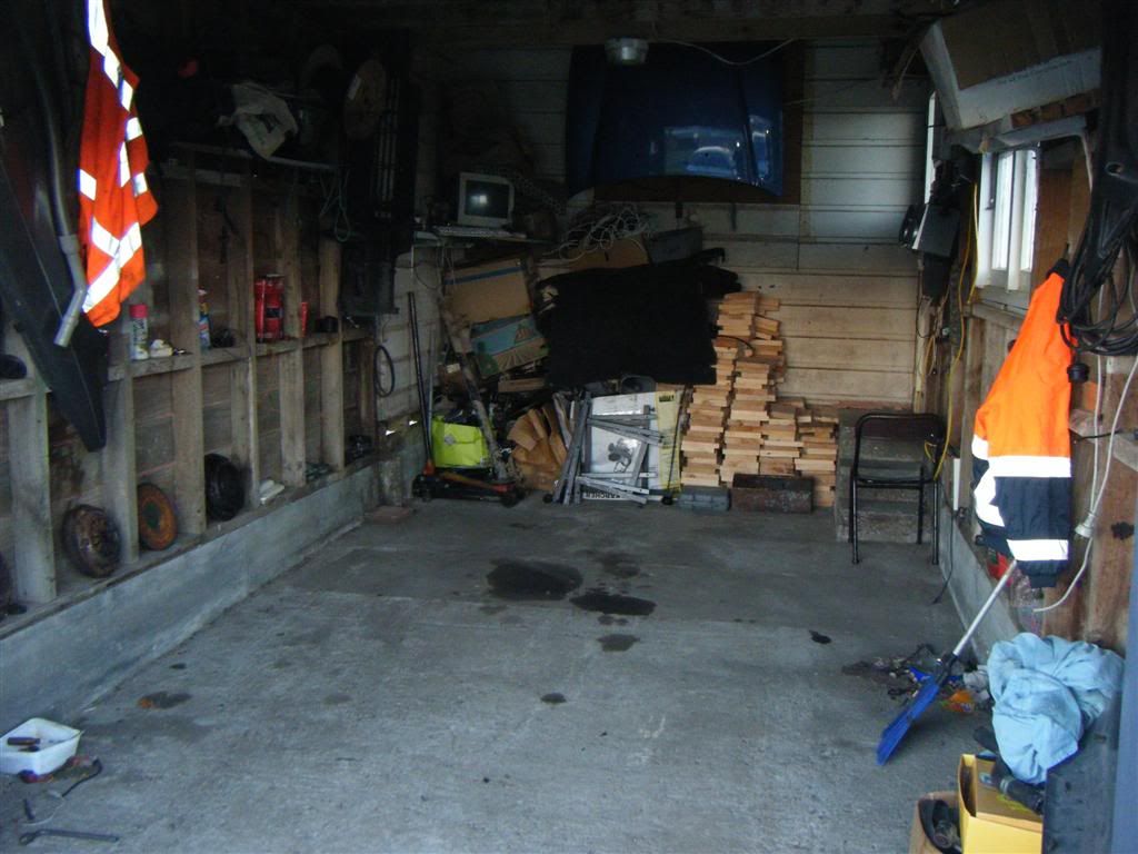

cleaned the shed out today!!! so this can happen....
http://i687.photobucket.com/albums/v...a/DSCF2753.jpg
http://i687.photobucket.com/albums/v...a/DSCF2754.jpg
and
http://i687.photobucket.com/albums/v...a/DSCF2755.jpg
can start working on this one now (Y)
yayah!
i like where this is headed!

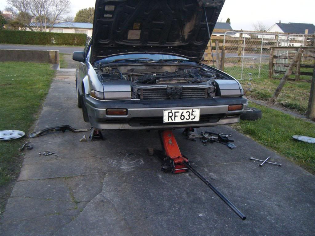

right, lets open the bonnet and pull some shit off.
http://i687.photobucket.com/albums/v...a/DSCF2763.jpg
- drained coolant and removed radiator and disconnected heater hoses
- drained engine oil and removed dizzy and unplugged shit
- drained gearbox oil and remvoed the axles
- disconnected gearbox linkages and unbolted the exhaust system from the manifold

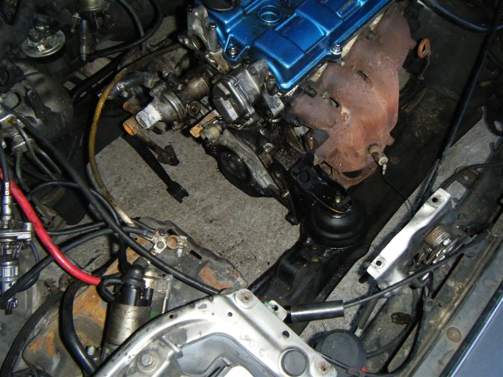

now waiting on an engine crane to lift this b18a/b20a hybrid motor out
http://i687.photobucket.com/albums/v...a/DSCF2767.jpg

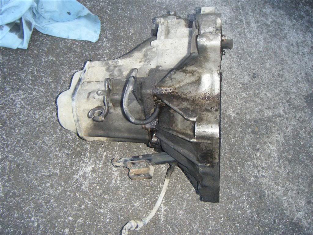

lol, the main idea is to remvoe the box from t=my car so i can swap it into the other car i have that has a b18 gearbox, so i can sell the car, and ill run the b18 box with civic/integra gears and a LSd in my car.

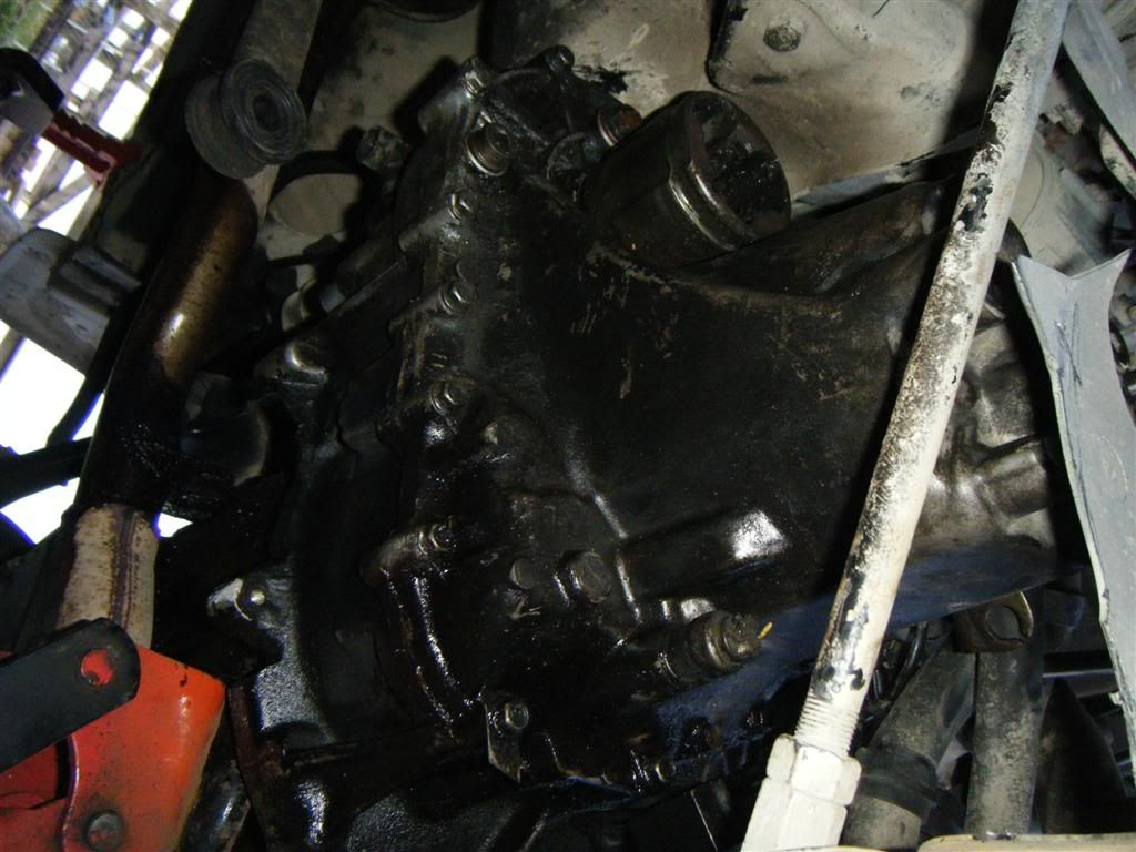

removed my B20A gearbox
http://i687.photobucket.com/albums/v...a/DSCF2769.jpg
remove b18 box
http://i687.photobucket.com/albums/v...a/DSCF2770.jpg
http://i687.photobucket.com/albums/v...a/DSCF2772.jpg
and put b20 box back onto the b18, car is ready to sell now
