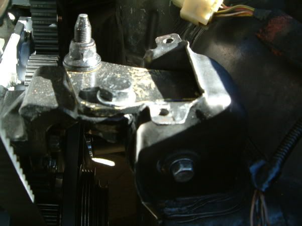

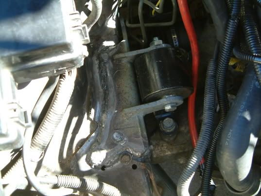

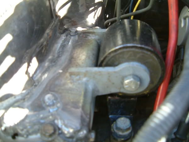

Here are some pictures of the tranny and drivers side mount.
http://img.photobucket.com/albums/v6...r/c2de37fe.jpg
http://img.photobucket.com/albums/v6...r/578bc03d.jpg
http://img.photobucket.com/albums/v6...r/6d3a4c69.jpg
