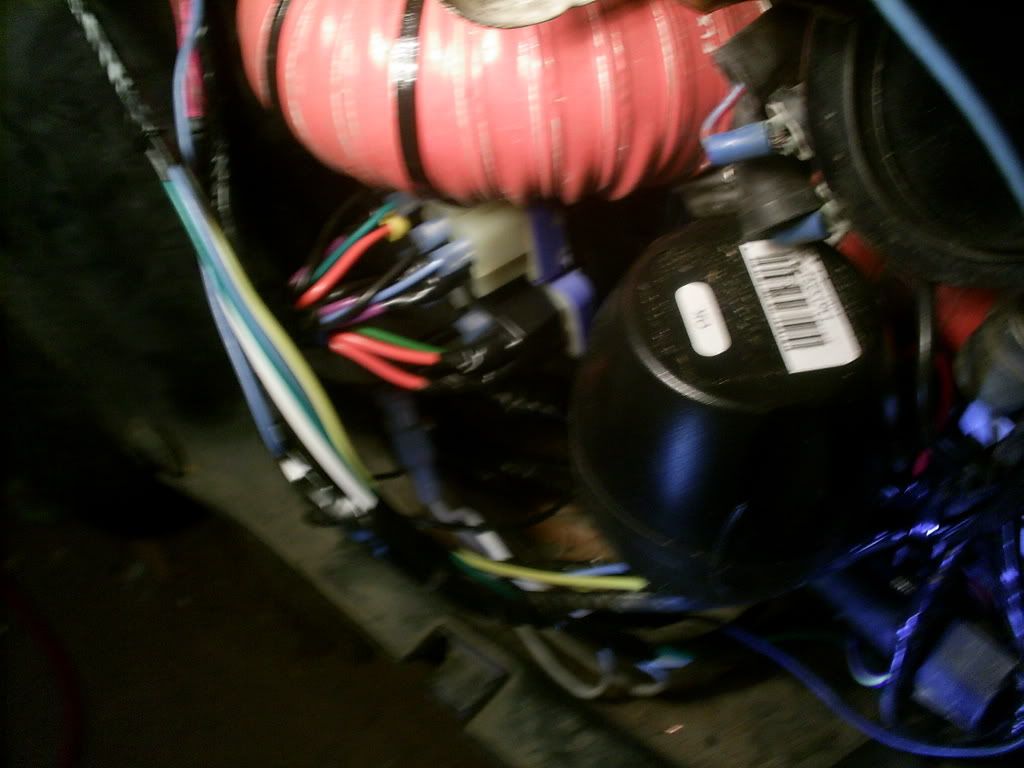

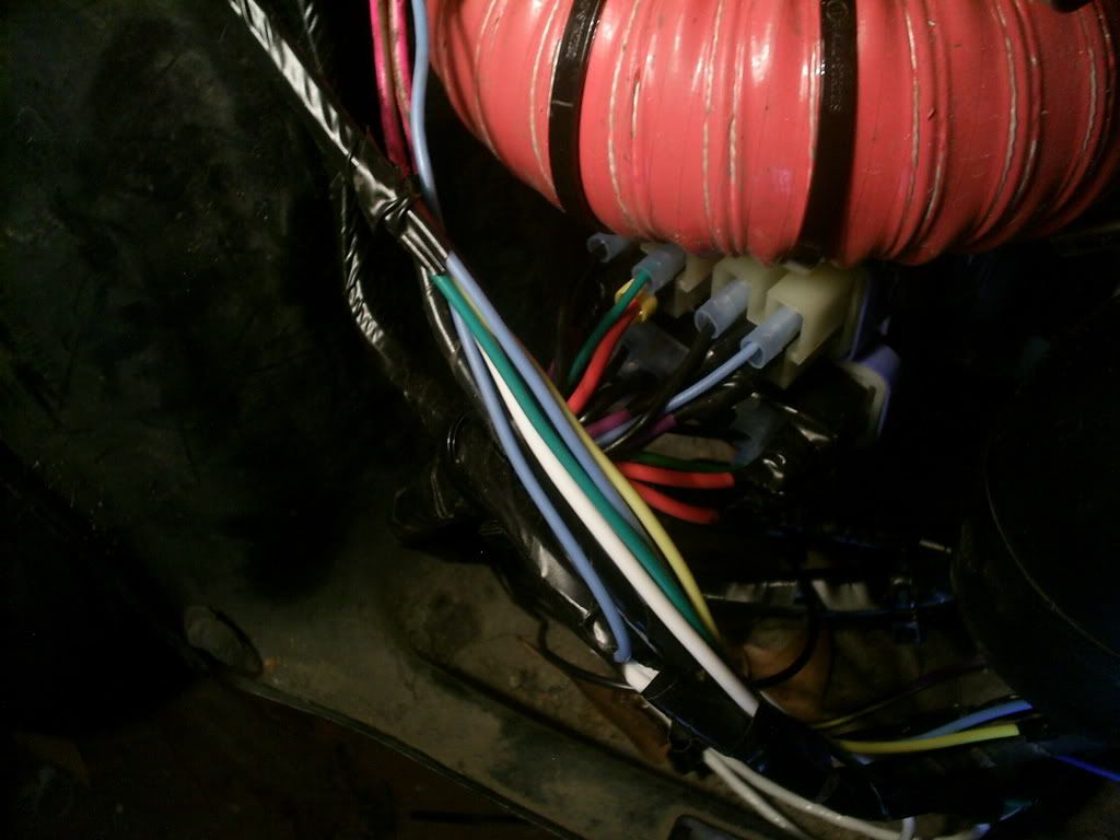

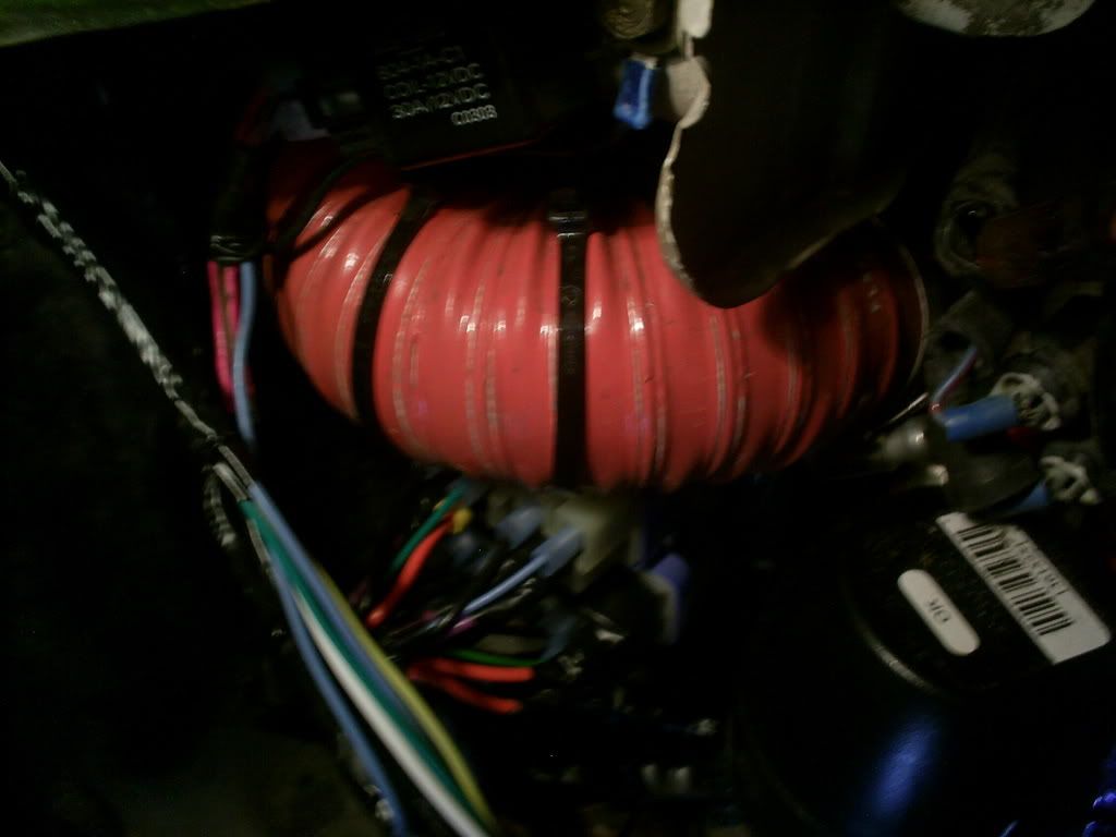

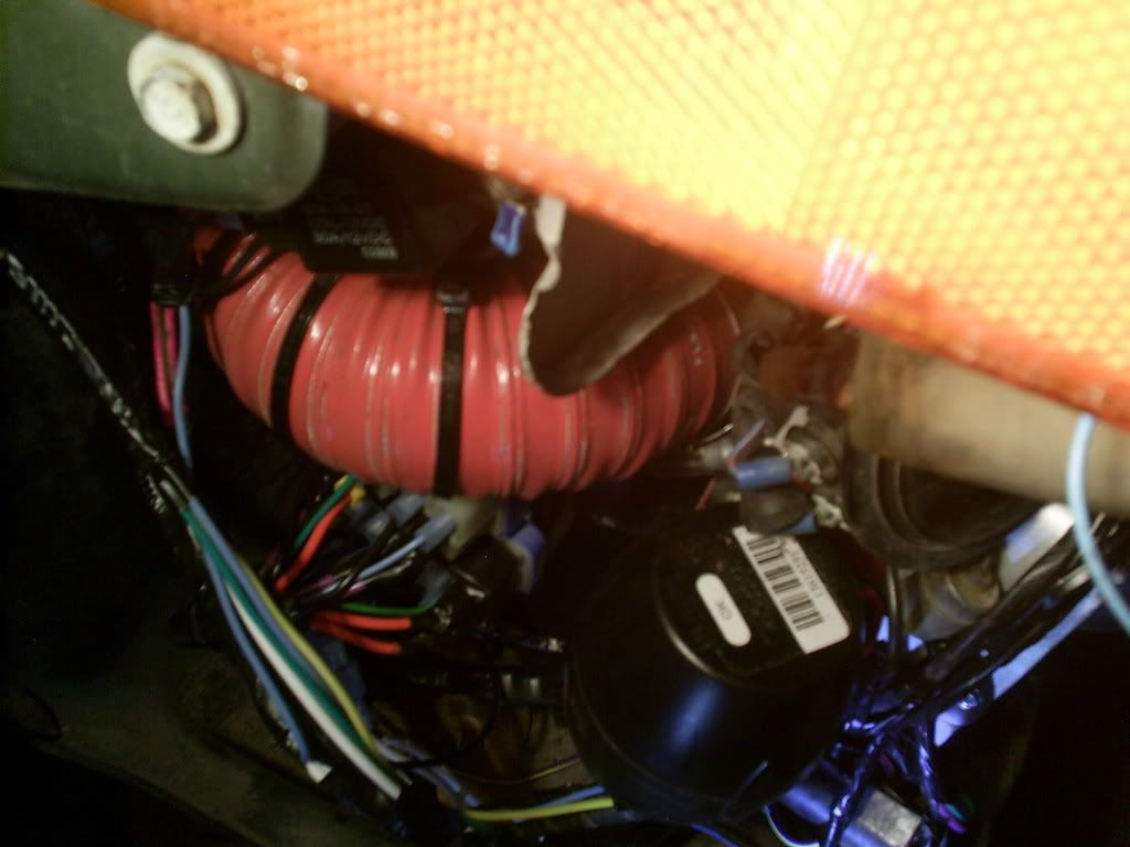

well i just moved 5 relays and a bunch of wiring to under the corner of the bumper.. these are the relays that control my fog and driving lights, 2 of them control current to the lights,one of them controls the ground to those two relays,for the master switch,and one lets the alarm turn on the driving lights. also moved the relay that lets me turn on the fan manually, while i was doing this i wired one of the several alarm sirens i have,and ran the wires to the engine compartment for the hood pin switch, the oil cooler pressure sender, and the thermostatically controlled switch for the oil cooler. i managed to cram all that in,plus the alarm siren,and the blower motor for the oil cooler and it's ducting.
i'll take the fender off tomorrow and run the harnesses in the car. really cleaned up the engine bay around the battery a lot. i am moving the odyssey bettery to a different location,other then under the other side now,so i will mount the cruise unit under there.
