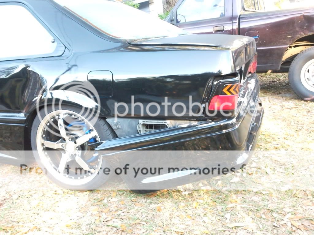

They should be cause last night I got sandwiched between two cars and it may end up total loss when the adjuster comes to look at it cause its bad. I'll post pics of the tragedy tomorrow. Im so damn mad...8 years in the making and now this shit. In a few day i was gonna buy the obd1 dizzy,ecu,and conversion harness. Just my luck....

BTW the verdict is in and i'll only be receiving $1,200 for the car. After i put bout $9K into it in the last 8 years. But rest assure in that all is not lost. Cause i will be getting another coupe to put all my sweet after market goodies and custom mods onto. So once again....stay tuned for the rebirth lol.
Re: Sickest3g se-i stock rebuild motor/suspension/5speed swap
hmm you know it does look fixable. Im not really sure how bad the rear 1/4 is tweaked but the front def looks like an easy fix... That sucks though, I liked your black coupe :(
