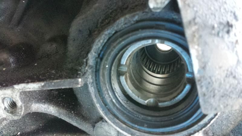

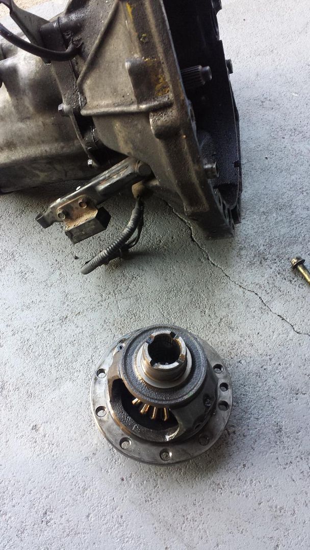

Any ways, i picked this up from the shop today
http://i28.photobucket.com/albums/c2...210_173258.jpg
http://i28.photobucket.com/albums/c2...210_173320.jpg
all rebuilt and bseries lsd installed. The guy didnt have any comments about the install either so im assuming it was smooth. Hopefully i can get it in the car next week.
Dam, they could of cleaned it. Now hurry up and get it in.
nahh its cool. Ill clean it. i dont mind doing that lol. price was right on the labor.
That's a b series lsd, from any particular engine group or trans.
b16 lsd with ARP bolt upgrade. they can take a pounding ~500whp

^^ get it. thats how much i paid for the obx. the guy who rebuilt this trans said that he had an obx one in his race car(500+hp) for like a yr or 2 and was launching at 8k on it all the time before something inside the trans blew up. so im assuming for my application it is gonna do just fine.
& yes its just a b16 diff
