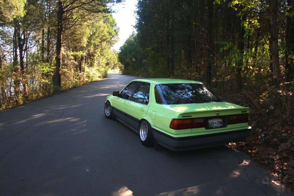

haha yeah I hadn't looked at it that way... it's like... belly button height lol. And thank you
You should chop the roof for more lowness! ;)
eehhhh I think it would throw off the lines of the car. There's plenty of headroom to come down, but I have no desire to do that at this time. I've done a roof chop before. It sucks.
Lol, I had one of those on my 4dr...
I don't like how it sticks out on the sides, so I'm gonna cut it down and fiberglass it shorter. maybe even mold it into the trunk.
Subtile, I like.
where can i find one is tht like a crx spoiler
I cut mine down the middle, it made the arch thing for the H super skinny
Sexy, as always (Y)
Is that spoiler off a prelude?
I feel like that would be harder to get it exactly straight again than it would be to just shave the edges down and smooth it back out. Plus I have an emblem in there.
(o Y o)
I added some lower case "o"s and some spaces and made your (Y) look like boobies. :)
