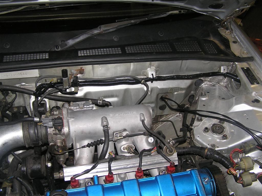

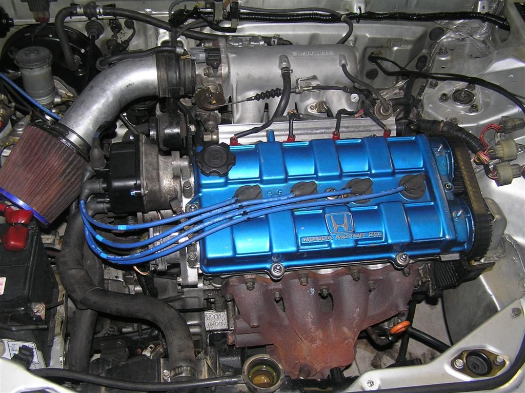

and a few pics of my OBD1 swap in the engine bay. No pics of what i did under the seat as its bolted back in. basically i lopped off the OBD0 plugs and soldered OBD1 plugs from an EG civic straight on.
Engine bay shot.
http://i687.photobucket.com/albums/v...ps463e8440.jpg
Map sensor wiring on firewall extended to reach the thottlebody. These cars usually have a black box with a million vacuum lines coming out. Inside the black wire is also the wires for the climate control heater tap actuator.
http://i687.photobucket.com/albums/v...psb814d148.jpg
B20B Dizzy. i havent installed the cam cap yet so the top bolt doesnt line up.
http://i687.photobucket.com/albums/v...ps623c8745.jpg
The B20B districtutor is rocking a brand new EDM BB2 prelude cap with an external coil input. This way i can throw away the unreliable coil and ignitor inside the dizzy and use my factory items
So your running a CRV distributor? Or is it from a prelude?
orthia / CRV yeaH

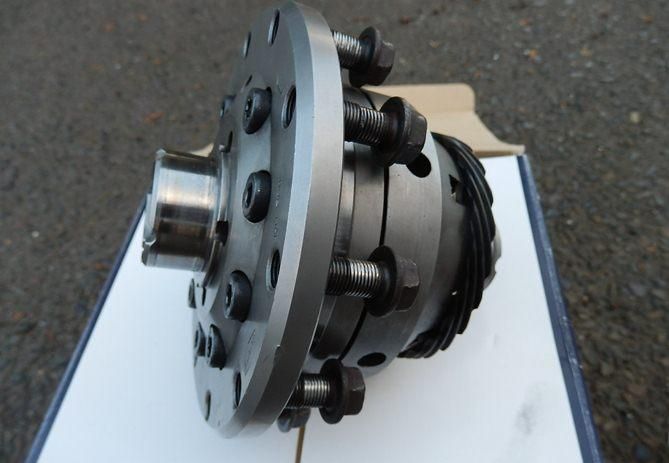

this is worth more than the car. No more broken diff pins for me
http://i687.photobucket.com/albums/v...pse0ec94f9.jpg
Nice Aaron
