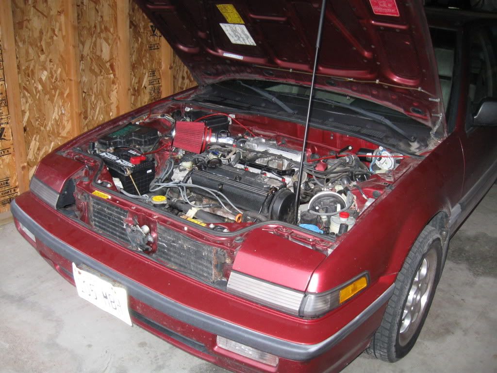

Well, today I bought a new battery for my 3gee, and I also fabbed up a SRI that was a FUCKING pain in the ass- had to cut the intake pipe 3 times til I finally got it to just fit decently haha!
http://i237.photobucket.com/albums/f.../Newintake.jpg
The hood closes okay, I do notice if I look under while I lower the hood it pushes down on the filter just a little.
Other then clearing out the engine bay and adding a bit more throttle response I like it, i doubt it added much of anything as far as HP...well maybe- the OEM intake design had to be made by someone on drugs of some kind :slap:
Oh, and on a side note I haven't started this car for almost 6 months since I put it away- It started right up without a hiccup in 2 cranks...if that doesn't rock I dont know wtf does :rockon:
looks good!
Just a small update, I fixed my sri by adding a small 60* bend, so no more hood bumping :)
http://i237.photobucket.com/albums/f...RIfinished.jpg

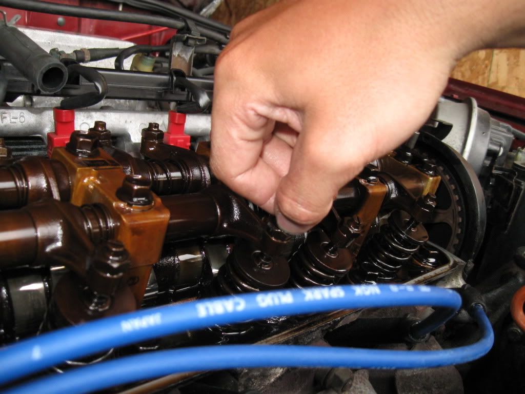

Well today I picked up a 17mm socket and a feeler gauge!
http://i237.photobucket.com/albums/f...vemovement.jpg
Yep, you guessed it, I'm getting ready for a valve lash adjustment. My VC peel'd off very easily, the gasket appears to be very new and from a glimpse under the timing belt cover the belt looks new-ish too!
Tomorrow im going to remove all the spark plugs and jack the front diver side wheel up, pull it off and then turn the crank bolt to get each cyl to its proper TDC, setting the exhaust valves to .010 and the intake valves to .006 (or whatever the middle # is of the 3 sizes, I think it was 6 if I remember right) Currently as it sits the exhaust valves seem to be at about .015 or slightly higher clearance and my intake valves feel the same as the exhaust- .015+, they ALL move....I mean I can pick them up by the adjust-screw locking nut and move them up and down!
I'm following this guide:
https://www.3geez.com/forum/showthread.php?t=39319
By the general looks of it this should really quiet down my engine, I wonder how long if at ALL ago that this was done to the car.
Status update! This was probably by far my first completely solo job that was semi-major. I didnt find it too difficult...I could use much better tools then the small set I got. Oh well got the job done :)
I took the car over to my mechanic friend Louie after I finished the job at my apartment and he told me I should be proud, my 2 hour valve lash job turned out very well! There is virtually no more tapping sound that used to come from the out of spec valve lash and it runs a bit smoother! :) Only fail is I got a few scratches and got a little bloody when the wrench would slip and I would smack the back of my hand/knuckles right up against the sharp adjustment bolts ><
