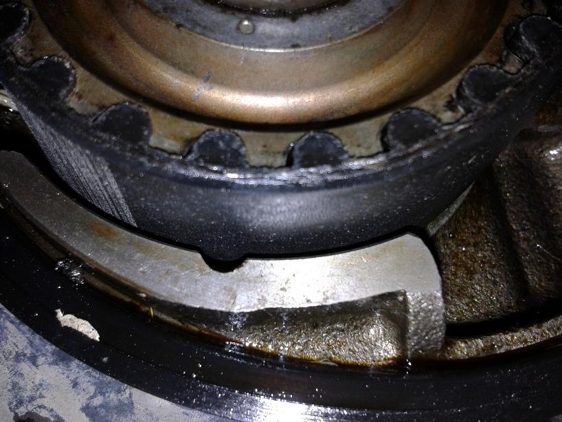

While following the instructions in my Haynes manual I have checked the timing and I can not see the mark, I have checked that they are there and I even re-marked it to make sure it is visible but no matter how I angle the light, move the distributor or rev the engine I can not see the mark with the timing light..
Here is the pictures of the timing belt lined up.
Attachment 9627
Attachment 9628
And when the gears are lined up is the fixed pointer at the T mark on the flywheel
No, the+ mark on the flywheel (I'm assuming is the T mark you are referring to) does not line up.
Sometimes there's two marks a t Mark and usually sometimes a circle approximately 15 degrees before top dead center. If it's not line up on the flywheel the timing is most likely off . So line up the mark on the flywheel and see where your cam gear sits
