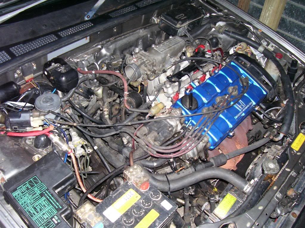

I fixed the misfiring and running like shit issue. it had fucked plugs and leads. It now purs like a kitten

yeah. so the day before the trip the water pump on the 1.8Si engine took a shit. so in the pissing rain for 6 hours i took the engine from rp5476 and put it in my car. B20A Power for Teh wiN
