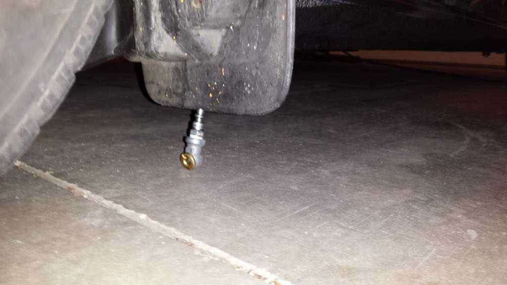

4 Attachment(s)
Re: How to pass the sniffer?
Originally Posted by
2ndTimeHondaOwner
A picture of your car would be sweet.

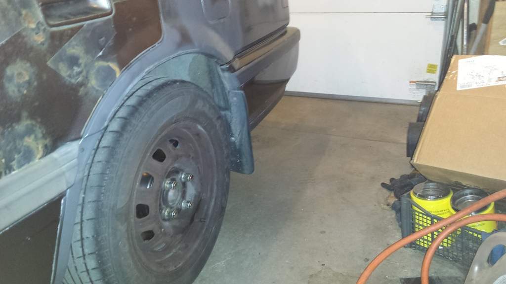

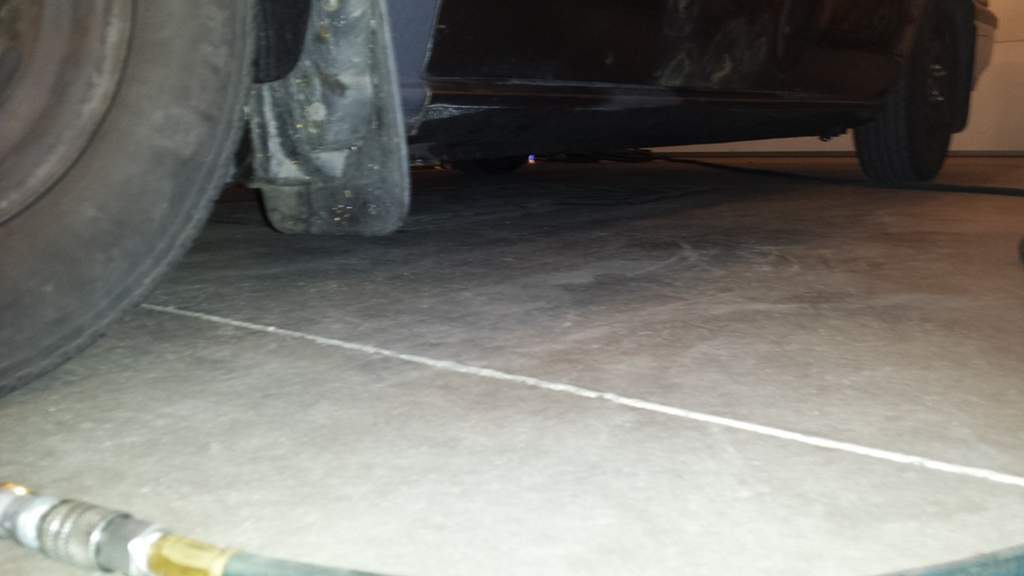

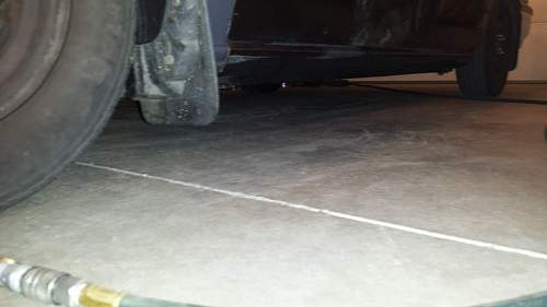

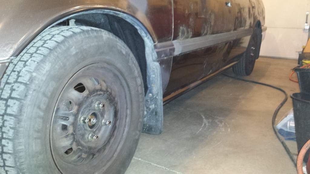

Here's how it looks like right now on the stock 13"wheels. The rear left wheel looks funky cause it's got a geo-metro size small tire on it (170/65/13).
The air chuck in the last pic is 2.5" tall
Attachment 6829
Attachment 6830
Attachment 6831

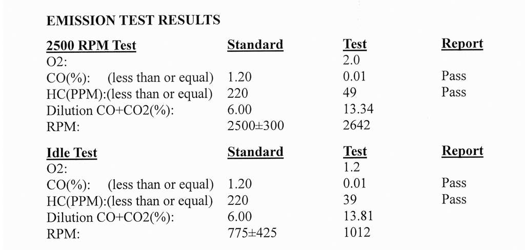

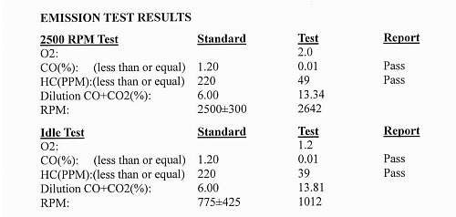

Either way, I went out to the station today, and this time, the guy bothered to remember that he's supposed to automatically fail anyone who doesn't have the egr & air injection hooked up irregardless of what carb they have :rant:
I'll have to re-install those parts, and at least hook up the vac to the egr, but I dunno where to plug it in either. I'm assuming it should go to manifold vac, since it should be open mainly at idle, right?

UPDATE:
I passed the test today.
I seafoamed the car on Friday, and did the oil pan gasket (and changed the oil) over the past weekend.
Here are the results from the test.
If anyone is interested how to jet the 38.38 Weber for the sniffer, here's what I have:
Mains - 145
Air Correctors - 210
Idle jets - 40
Pump Jet - 70
AFR by Bosch LSU 4.9:
@Idle: 14.8
@2500RPM: 15.8
I think I'll leave my car like this actually and see what kind of mpg I get for the rest of the tank.
I had a lean hole when I open the throttle up a bit more than 1mm via the pedal, (AFR spikes to 17.8-> off the charts) but it tends to settle out when the car's been warmed up for a while.
I love the carbon-caked puddle's I'm making on my driveway now though :kekeke:

Nice! 15.8 is pretty lean and you may get misfires (engine will have sort of a nervous twitchy feeling), but if you can run that lean go for it. Advancing the timing a few degrees may help if you do get misfiring.
My guess is that 40 idle jets are too small, which results in the lean hole. But hey, you should get decent mileage.

I probably should have updated you guys sooner, but as Cygnus was thinking, the 40 idle jets were a bit too small, and I got tired of lurching around when the car still hadn't come to full temp (and even then it was still lurching).
I put in 45's and rolled with it, it's still lurchy up until the water temp goes past the low bar, and when its warm its ok.
I was getting 30mpg at the beginning with the 40's, & it dropped to ~28 +/- 1.5 when I put in the 45's & the 15" wheels (wrapped by 205/55/15's).
Now I'm getting a steady 26.5-27 & I think it's because the air filter is caked over in dirt from the past year... Now I'm learning that the small 1 7/8" filter should be washed/oiled pretty often.
Plus I started to mess with the timing thinking that I could try straight mechanical advance (not bad, but I think I set it too high on the first try, it wasn't pinging, but felt like it was running into a wall over 3k rpm) I set it to the middle of the 3 marks that you're supposed to align to while the vac advance is hooked up. Now that I put it back to that mark with the vac advance hooked up, it's gutless, makes a lot of noise, with low power.
I noticed that my AFR was a bit leaner with the mechanical advance, but I gotta figure out how to set it at a good point where the motor isn't banging itself to hell... (ideas?)
