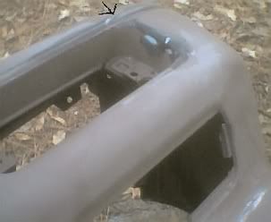

the back side of the crack around the light,the panels were aligned,and it was filled with plastic epoxy. the panels were warped enough to require cutting out part of the bumper plastic to make the two parts of the crack line up.
http://i20.photobucket.com/albums/b2...rrepair005.jpg
after the epoxy cured it required cuttting a groove with a dremel in the opposite side of the crack,this was to give the bumper repair filler somewhere to go.
http://i20.photobucket.com/albums/b2...rrepair003.jpg
the bumper repair compound requires mixing in a 1:1 ratio,it's real fun to mix at 30 degrees outside.
http://i20.photobucket.com/albums/b2...rrepair006.jpg
the filled repair
http://i20.photobucket.com/albums/b2...rrepair007.jpg
after it's dry you sand it like body filler,but is a permanent part of the plastic bumper,in the last two pictures,you can see part of my new grill.
http://i20.photobucket.com/albums/b2...rrepair008.jpg
http://i20.photobucket.com/albums/b2...rrepair002.jpg
http://i20.photobucket.com/albums/b2...rrepair010.jpg

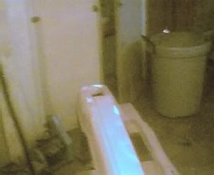

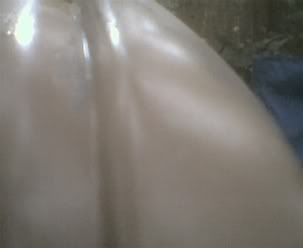

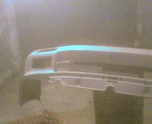

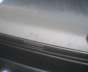

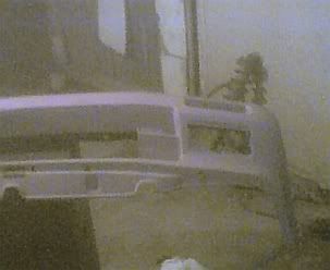

ok i got the initial coat of primer on,this is a guide to show me where all the high and low spots are,then i started sanding it with 600 grit sandpaper,since this is a semirigid plastic,all the really shallow imperfections can be filled with glazing putty. the flex compound is primarily for the deeper areas. i'm typing this while i'm waiting for the glazing putty to dry. then it's sand fill,sand fill,sand fill,you get the idea. i hope by wendsday night to have the paint on it,i'm going to do more work tomorrow,and some more tonight. they said it would be in the thirties,but it's about seventy degrees out.
http://i20.photobucket.com/albums/b2.../primer003.jpg
http://i20.photobucket.com/albums/b2.../primer002.jpg
http://i20.photobucket.com/albums/b2.../primer001.jpg

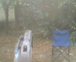

ok i'm here today because the accord refused to start due to the extremly cold weather and wind we had all night,but here are a few pics from school on monday night. cathy was finishing up the three areas on the bumper where we had cut away original plastic grill.

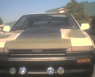

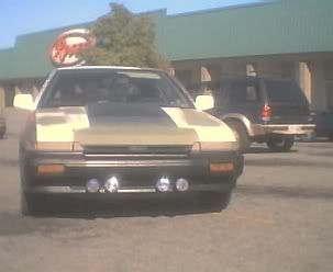

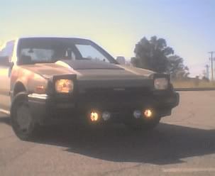

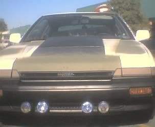

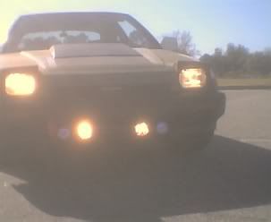

gobble gobble it's done
Re: progress on the front bumper
that looks great, i think it would of looked better if you had somewhat mold the fog lights into the grill some how....

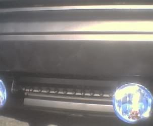

well I had thought of that,but these lights are huge,there just isn't enough room,the upper grill bar is seperate from the lower two because it bolts to the steel part of the bumper,the lights attach to it,the lower two grill bars attach to the plastic part of the bumper so they float with the bumper. we have a lot of unlit country roads around here so the lights are a nescisity, as i have explained before on here they are a system,they switch automatically with high and low beam. the amber for low beam and the clear for high beam. the outer amber lamps are antique hella lamps,and the inner two are cyber white simulated H.I.D beams from navigator. they had the city blue light extra bulb in them that has been converted to an amber bulb,they function with the side turn/marker lamps. I just replaced them because i had broken one. they are extremly bright. as far as the bumper i'm done except for a few small runs,I'll let the paint cure for a couple of weeks,then wet sand those out and recoat them. The only thing left to do is finish the grills up that go under the bumper on each side,where the plastic grills keep falling out. it was a bitch with that ground, I had it bolted directly to a nut that was welded to the frame from the factory,it was tight,the crimps on the pig tail were tight,but it still wasn't grounding. I had to pull the bumper back off and move the ground. for a laugh I had stood that bumper cover up in the shower and wet sanded it with a hand held shower because it was too cold to do it outside last night. this was at 3:00am
http://i20.photobucket.com/albums/b2...perwork005.jpg
you can see the small amber bulbs in the bottom of the lights,these are naxl 194/or 194naxlbp2 these will replace most of the push in bulbs on lights with city lights that can be removed.
http://i20.photobucket.com/albums/b2...dbumper004.jpg

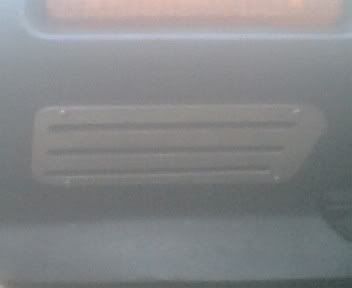

all right i made the grills that go up under the bumper,I'm sorry the pic sucks,bad lighting,they are aluminum and painted to match the new grill.
