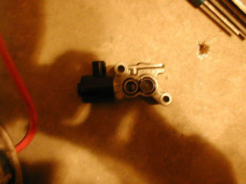

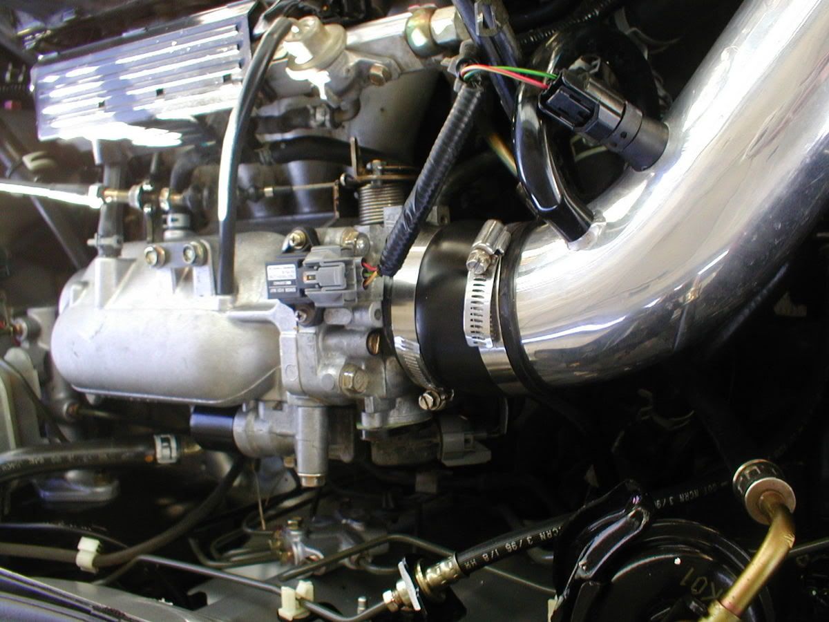

take a pic of your intake mani and i'll point the IACV out. it's usually attached to the plenum, not the TB. it's just a funky thing that sticks out like a wart and has 1 vacuum line going to it. when you remove it, you'll notice 2 holes and there's a gasket between this whole IACV and the plenum

ok your TPS is the dirty black plug on the bottom of the pic, near the TB. it looks like you replaced the black box that's all shiney on TOP of the TB. that's not the TPS, in case that's what you replaced.
also the TPS is adjusted by moving it the same way as a dizzy. loosen nuts, adjust, tighten nuts. and you need a volt meter to do it. i can give you detailed instructions later.

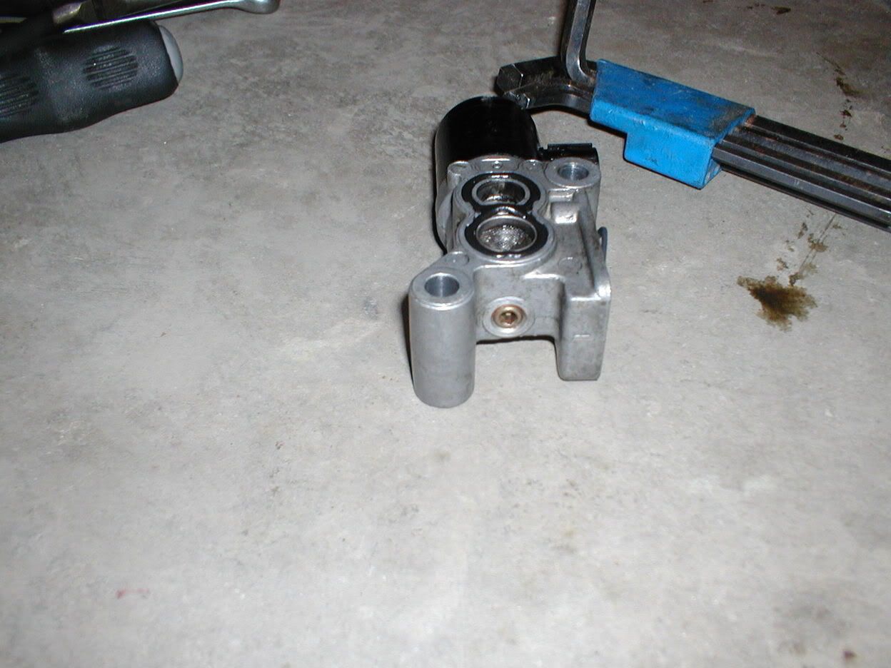

OK, got some pictures of the IACV.
http://i22.photobucket.com/albums/b3...h_537f637e.jpg
http://i22.photobucket.com/albums/b3...h_1921626a.jpg
it looked relatively clean when i took it off, but i'm letting it dry now after spraying the hell out of it with carb cleaner.
AND what is that screw thingy on the side??? It is not a normal wrench that goes in there.... it's got 5 sides.

You did rotor/cap/plugs but not wires?
Seems like you are getting plenty of fuel and air... and unless the wires are bad you're getting spark... next thing I would consider is timing.
Unless it's just WAY too much fuel in which case perhaps you have a stuck open injector?

I've already decided the IACV is the problem. It is stuck CLOSED. Too much fuel and not enough air.
Also, the o2 sensor is another part of the problems.
Just waiting on parts.
The CEL has not been checked yet, but will be soon.
I know the IACV is bad because the car didn't die when i unplugged the plug on the lower part of the motor. It was more than likely stuck closed as the car was getting too much fuel and on a full tank was getting about 200 miles out of it.
The o2 sensor is probably also a cluprit seeing as the o2 on the manifold is brand new and the one on the cat is old. My guess is that code came up and they replaced the one on the manifold. Thinking that there was a glitch with the light not going off, they decided to take out the light on the dash to pass inspection.
I am just waiting on parts and tires... then we will know what code the computer has stored, I'll keep you guys updated.
