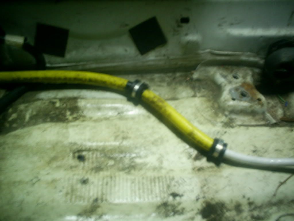

heres some more useful info i am running 2 gauge cable back to the back of the car to relocate the battery. i ran it inside of air line hose for physical protection.

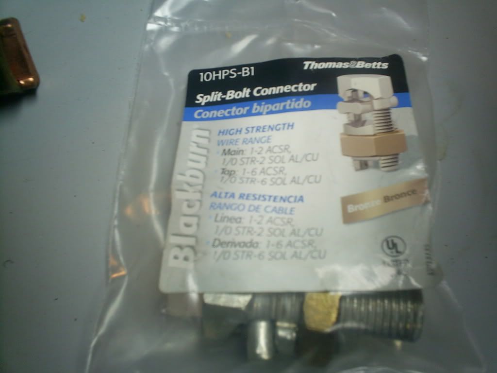

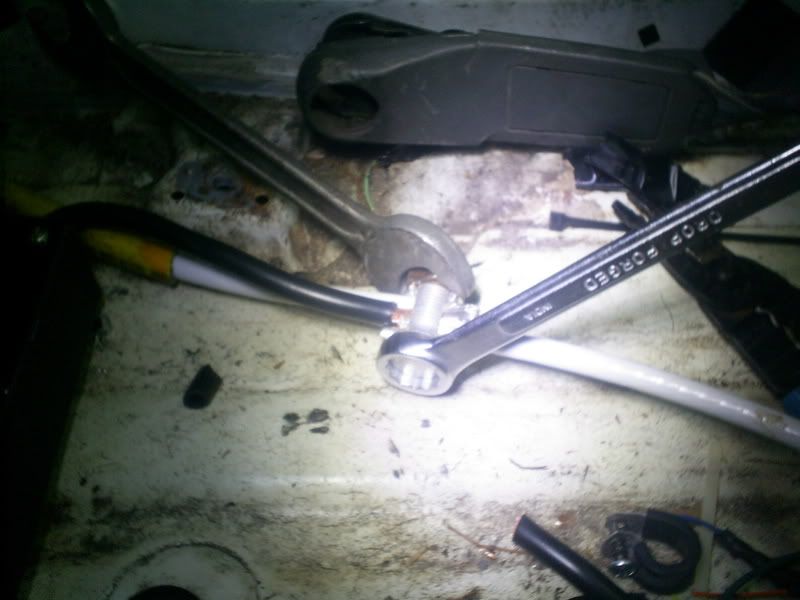

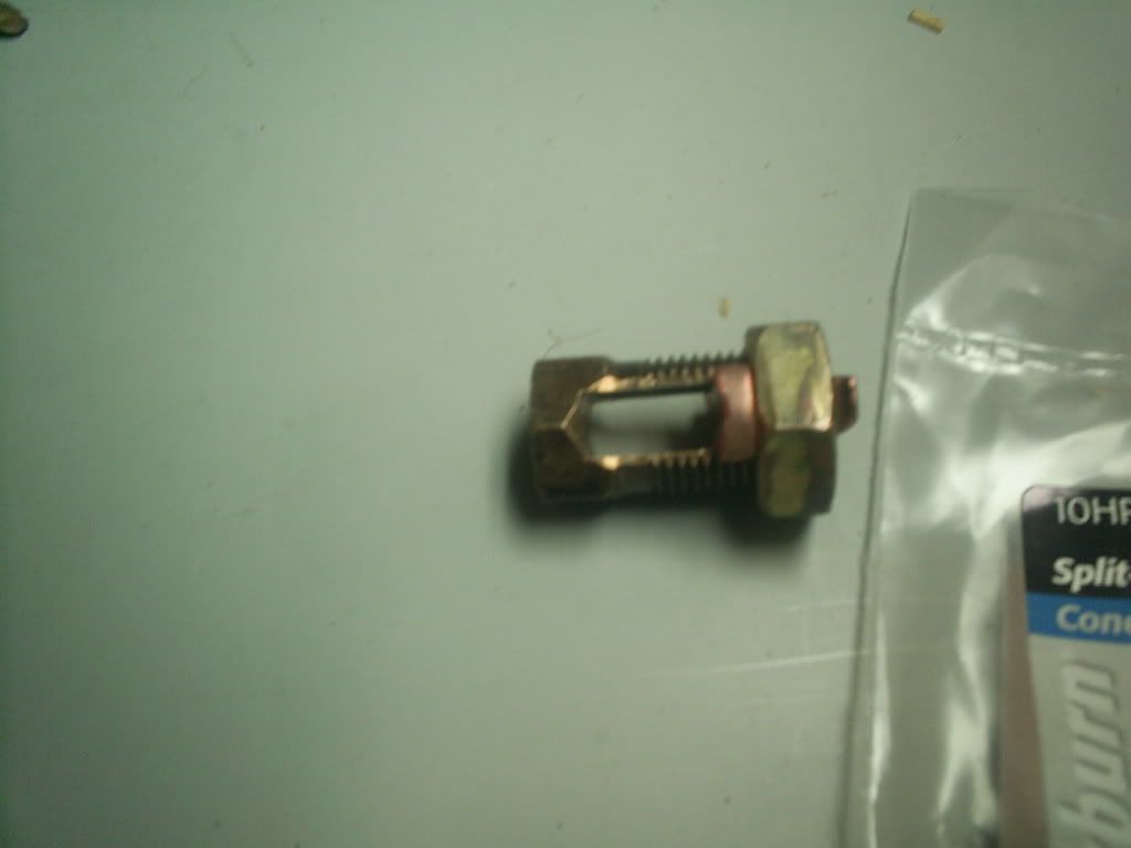

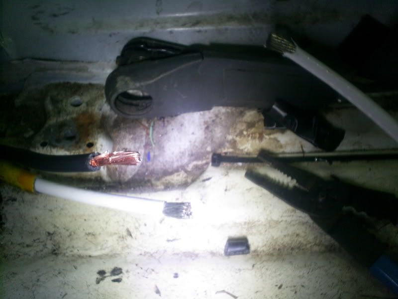

when you connect these large type wires together,instead of crimping and soldering, you can use split bolt connectors
http://i220.photobucket.com/albums/d...e/S4020042.jpg

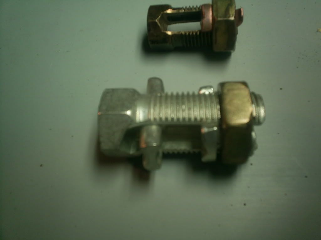

these are a mechanical type connector, you insert all the wires into it,then you tighten the halves together.
you can get them in different sizes
http://i220.photobucket.com/albums/d...e/S4020043.jpg
http://i220.photobucket.com/albums/d...e/S4020046.jpg

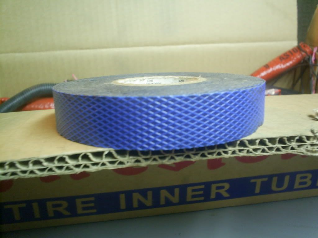

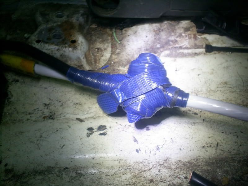

after that,you wrap it in rubber insulating tape,this tape sticks to itself,you stretch it super tight over the connector,
http://i220.photobucket.com/albums/d...e/S4020049.jpg
then you wrap the rubber tape with several layers of quality electrical tape. this is 3m tartan type tape. DON"T use the walmart special tape. http://i220.photobucket.com/albums/d...e/S4020045.jpg

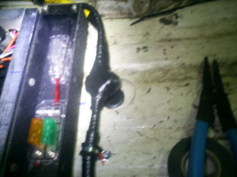

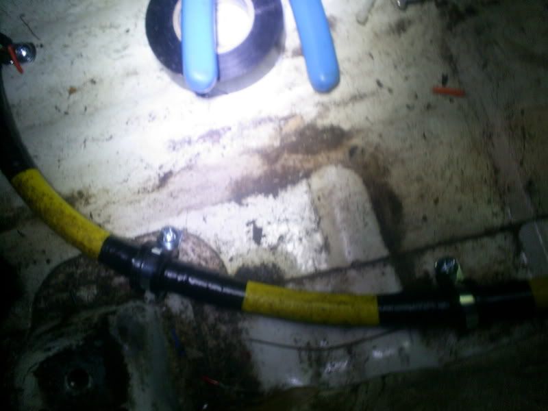

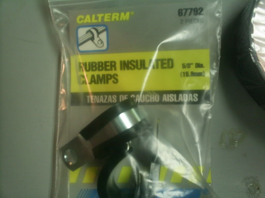

to hold down the wire and air hose over it,i used rubber insulated clamps,these attach with screws into the sheet metal. you don't want to use wire wraps for these heavy wires.
http://i220.photobucket.com/albums/d...e/S4020044.jpg
http://i220.photobucket.com/albums/d...e/S4020048.jpg
