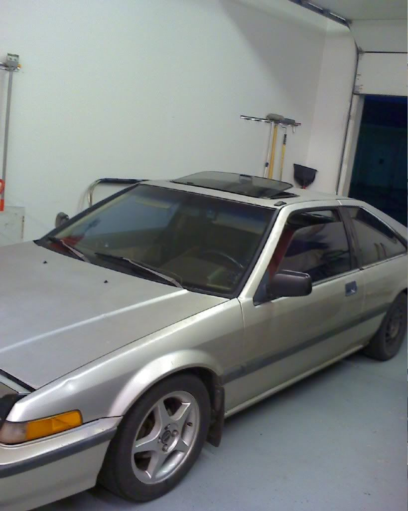

Finally have sun roof :)
Re: Finally have sun roof :)

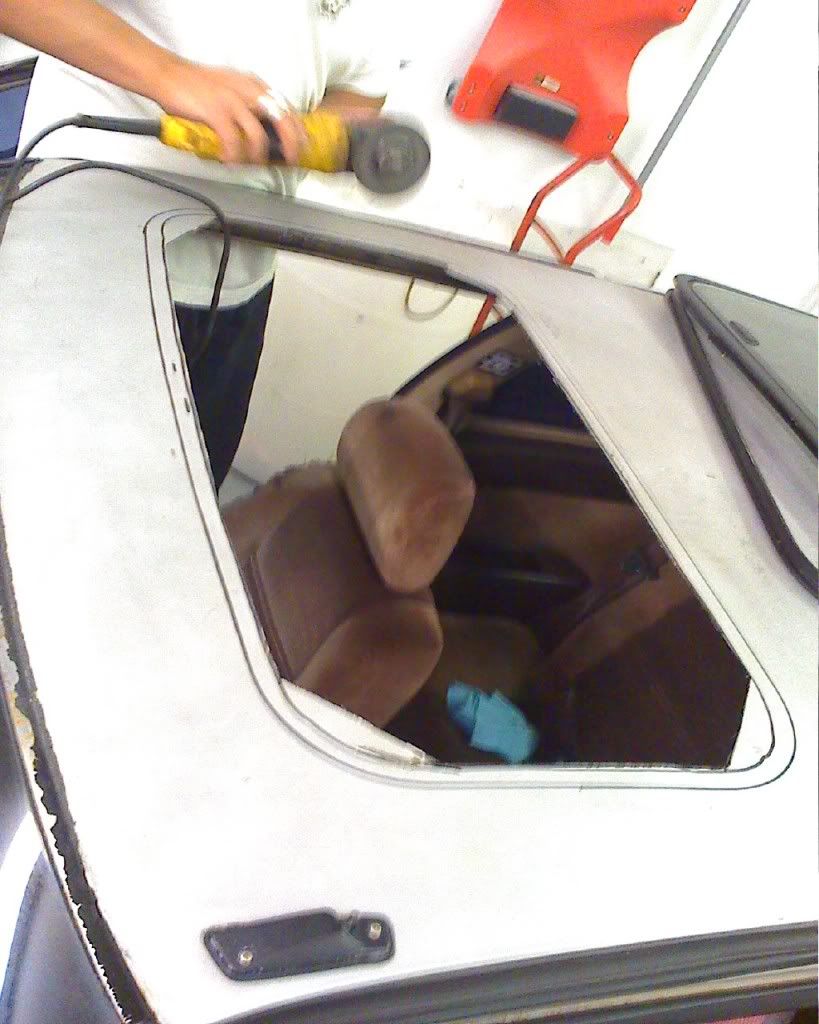

haha thanks guys but at first i was scared to grind it but then i was like i want a sunroof so i continued lol ended up turning out quit good :thumbup:
and messy sadly its not my garage its my friends dads i can just use it whenever i want so thats a plus.

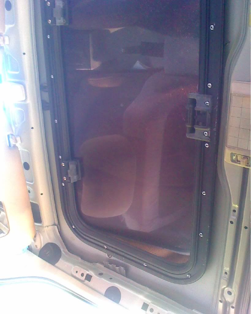

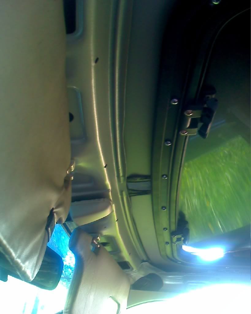

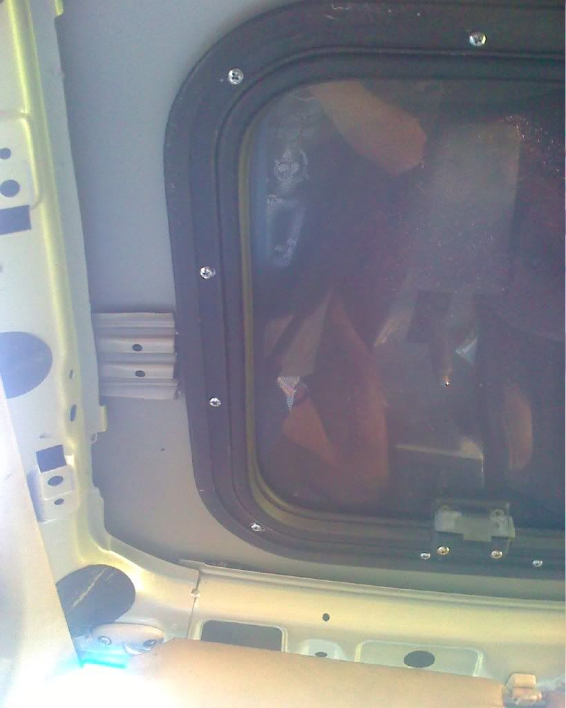

can i see what it looks like from the inside?!
and what they mean by drain is most sunroofs have drain lines that will drain the water out through drain lines.. make sence? i hope lmao
ooooo okay like the stock ones have okay i got u but no i dont think the aftermarket ones have that unless a professional installs it i guess not sure.
here are some pics of the inside
http://i192.photobucket.com/albums/z...driverroof.jpg
http://i192.photobucket.com/albums/z...rontofroof.jpg
http://i192.photobucket.com/albums/z.../frontroof.jpg

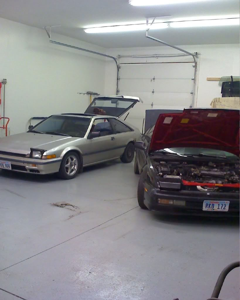

You're far more courageous than I am, dude. I also like your oversized garage. I'm insanely jealous!
thanks man but u can easily fit 2 more cars in there but sadly its not mine its my friends dads he replaces windshields but i can use it whenever i want thow so thats good

Oh my god...!
Cut by hand...!
Water leaking...!

well tommy not hand but grinder if thats wat u mean
and yes a very slight leak not a problem thow

sweet dude another hatch with a sunroof but some word of advice when u measure wat ur gonna cut. cut before the line to make it a lil smaller and then work ur way up to the line till the roof fits nice and snug. took me about 3 to 4 hours to do everything on mine. so take ur time dude and use window weld to seal the roof. good luck on it
