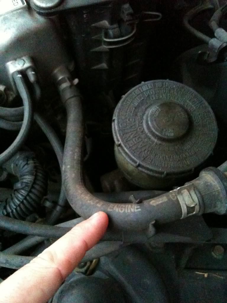

Knew about the brake booster line but unsure which one it is exactly, got a picture handy?
any vac line into the manifold will do if for some reason you cant or dont want to go thru the booster line
This the one?

The neighbors offically hate me :)
