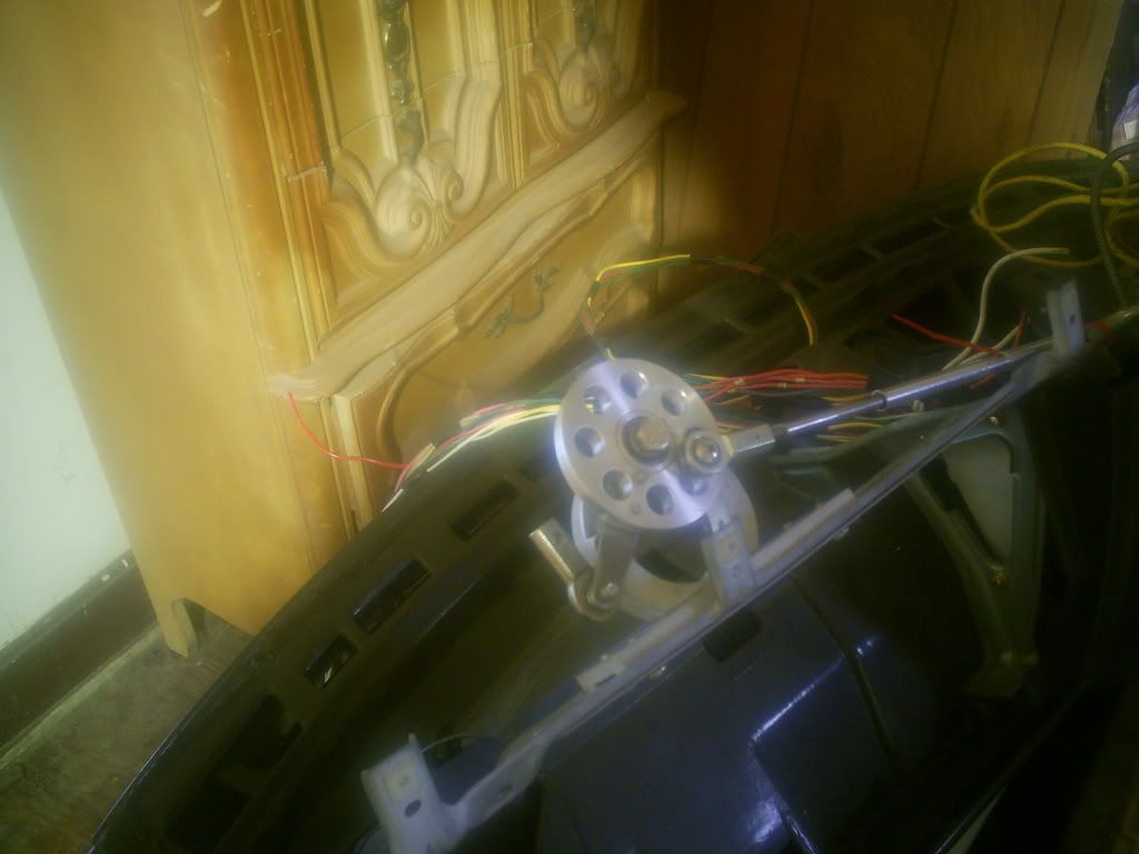

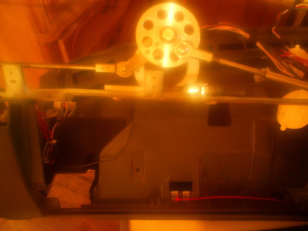

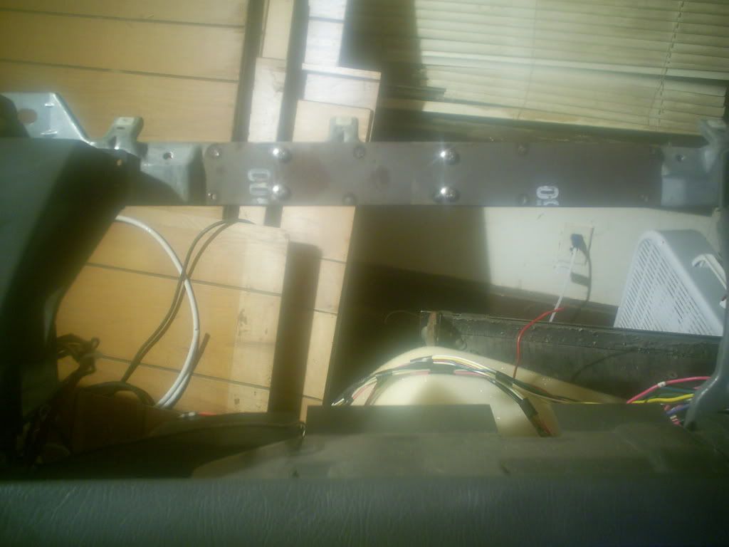

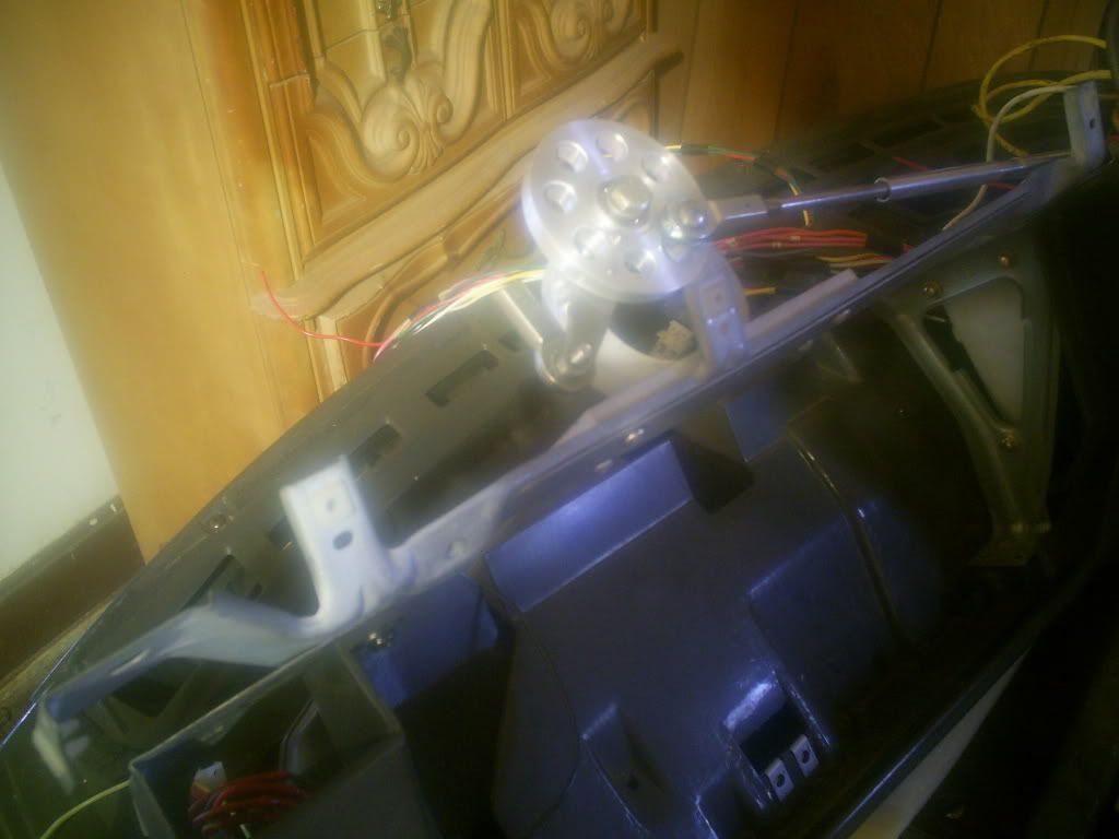

finally got something done, the dash that's going in the car is sitting on a rolling cart in my living room, been trying to figure out the linkage stuff for the chokes on the SU's, I have the nice aluminum pull knob from the aircraft, but the cable is too short to reach the firewall, i ended up making a nice bell crank, out of aluminum, this allows the choke cable to pull sideways, and exerts a pulling motion out from the firewall. there is another lever that attaches to this, but it's not on in these pictures. I had to figure the correct angle first. my making the choke cable pull for a small distance, and the lever that pulls the choke linkage rod longer,it allows me to give up force for a greater pull distance on the rod.
here is the actual bell crank minus the one lever,the rod end on here is for the choke cable from the dash, this mounts behind the glove box lower bracing
http://i220.photobucket.com/albums/d...S4020087-3.jpg
http://i220.photobucket.com/albums/d...S4020089-4.jpg
here you can see the welded reinforcing on the glovebox brace.
this is all in the fitting stage right now
http://i220.photobucket.com/albums/d...S4020088-3.jpg

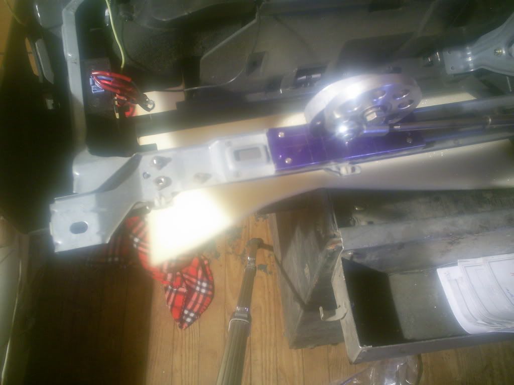

ok almost done, i have to install this with the existing dash so i can figure the length of the pull rod. We decided if we are ever going to finish this car,it's going to be one piece finished at a time, so we are working on the dash, once it's totally finished and painted, it gets installed, while it's out the heater core gets installed. this way i won't be working on 50 projects at a time. everything under it is finished, now i need to finish it and install it. http://i220.photobucket.com/albums/d...S4020091-3.jpg
http://i220.photobucket.com/albums/d...S4020090-4.jpg
Re: some interesting new parts for the carb setup

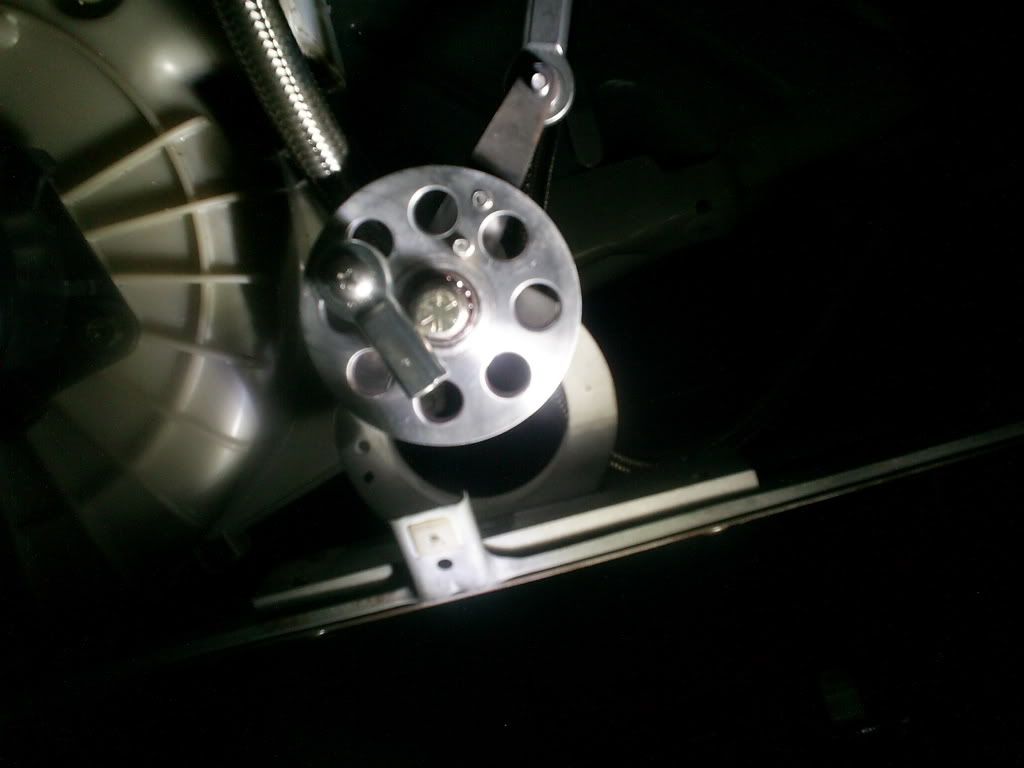

Ok how this works, when the choke knob is pulled out, it pulls on the bell crank through a spherical rod end, this causes the bell crank to turn, this causes the other lever to rotate, another rod end attaches to the choke pull rod, when this rod is pulled back, it pulls on a spring loaded bolt at the firewall pulling it back, this bolt pulls the choke cable in the engine compartment. all aircraft quality stuff, so no slop or play at all, everything fits nicely under the glovebox area.

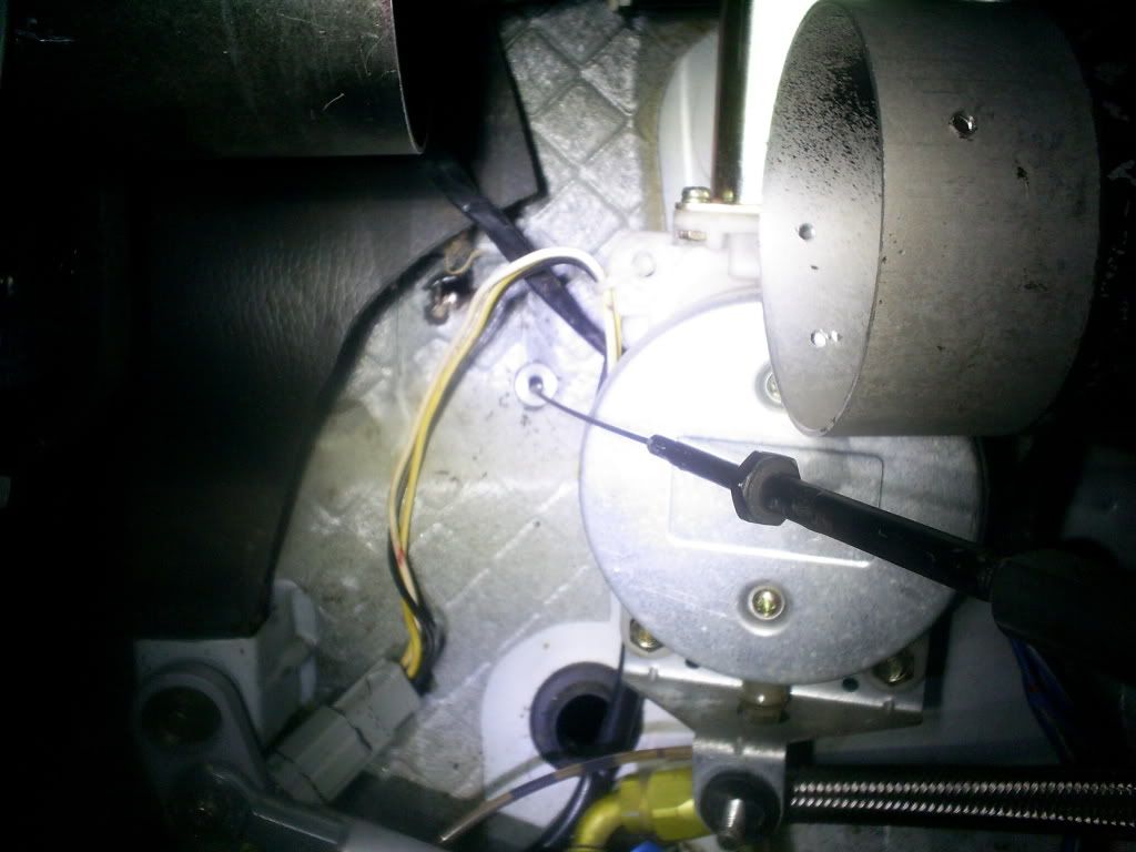

ok everything will clear,just clears the power antenna motor under the blower area, anyone know if the bracket for the evap canister is spot welded on,or does it unbolt? needs to come off I need to move it anyway,but it's in the way of the choke pull rod.

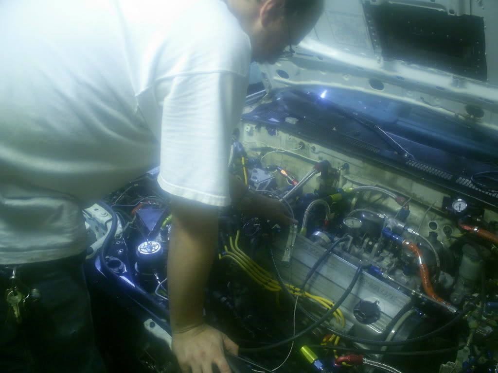

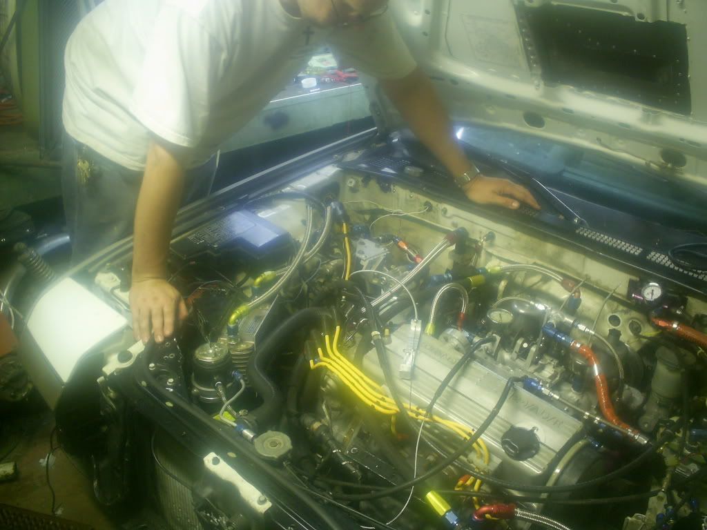

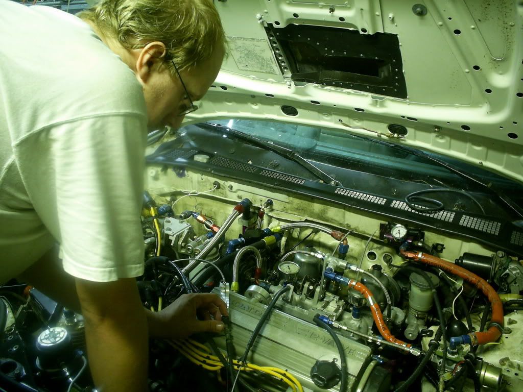

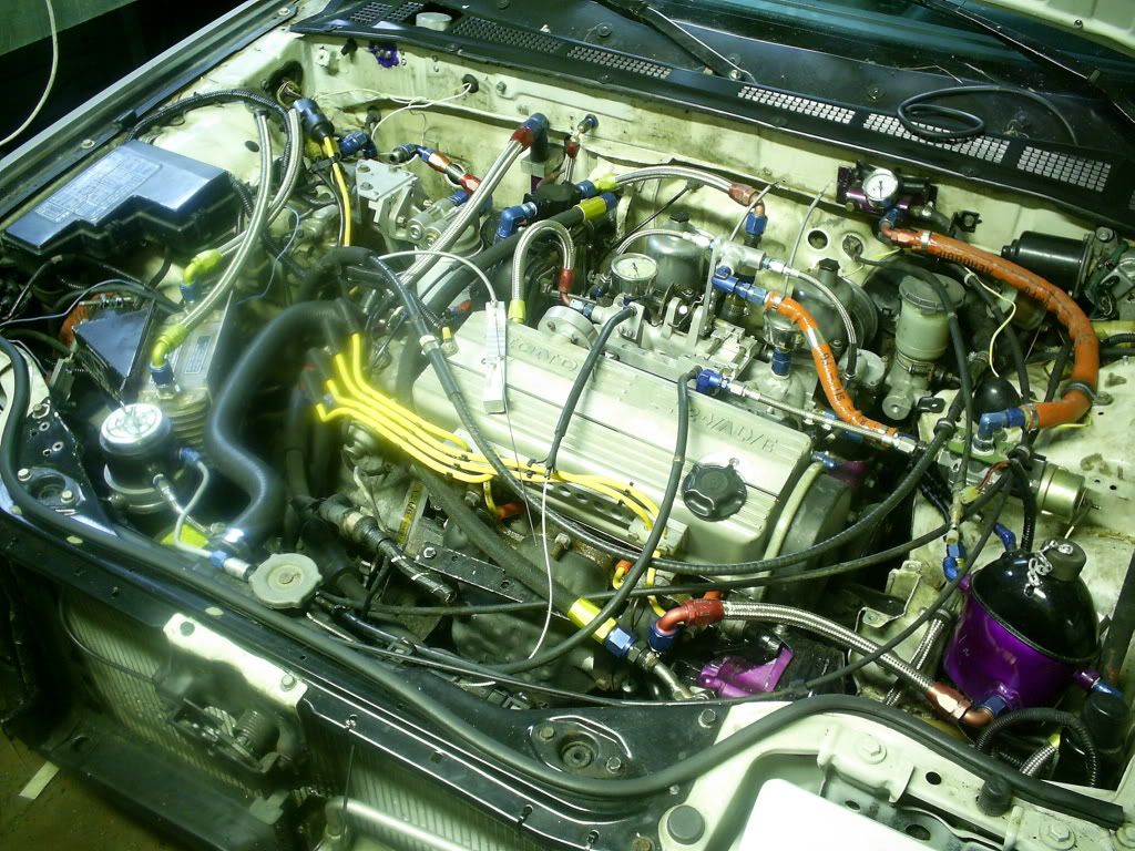

few pictures after i cleaned out my garage working on the choke linkage
took a few fuzzy pictures working on my choke linkage in the garage, camera is dying, common software glitch in this model. saw black widows,recluses, wolf spiders, huntsman spiders, daddy long legs and about ten spiders i've never seen before, probably snuck across the border. linkage is almost finished works good so far. http://i220.photobucket.com/albums/d...S4020107-3.jpg
http://i220.photobucket.com/albums/d...S4020109-2.jpg
http://i220.photobucket.com/albums/d...S4020110-4.jpg
http://i220.photobucket.com/albums/d...S4020111-2.jpg
Re: few pictures after i cleaned out my garage working on the choke linkage
w00t
and damn your engine bay looks confusing as hell
"glances at civic engine bay then glances at losts engines bay then glances back at civic engine bay then again at losts" holy shit!

it's not that complicated, way less then the factory crap

it really isn't the crap on a factory carb would give someone a migraine in 5 minutes.

ok more pictures
you can see where the two cables will connect over the valve cover,once i get both fitted, that bracket will get finished up,probably powdercoated black
http://i220.photobucket.com/albums/d...S4020013-3.jpg
how the choke cable connects to it, i have another clamp to put in so the cable loops around the oil filler.
http://i220.photobucket.com/albums/d...S4020014-3.jpg

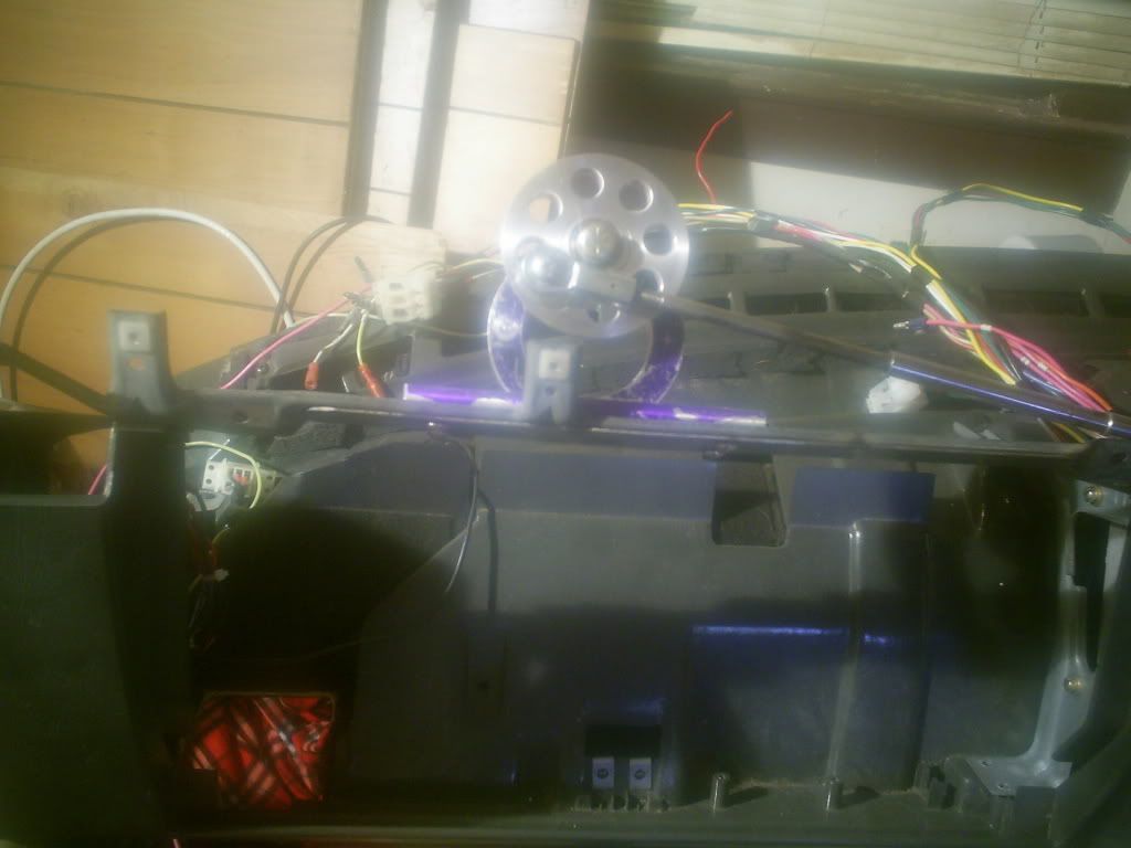

this is the bell crank under the dash, you can see how with a sideways pull the cable pulls out from the firewall.
http://i220.photobucket.com/albums/d...S4020007-2.jpg
the cable at the firewall doesn't actually hit the power antenna motor, the bracket that holds the bottom of the motor is off in the picture,so the motor is leaned over.
http://i220.photobucket.com/albums/d...S4020011-2.jpg
