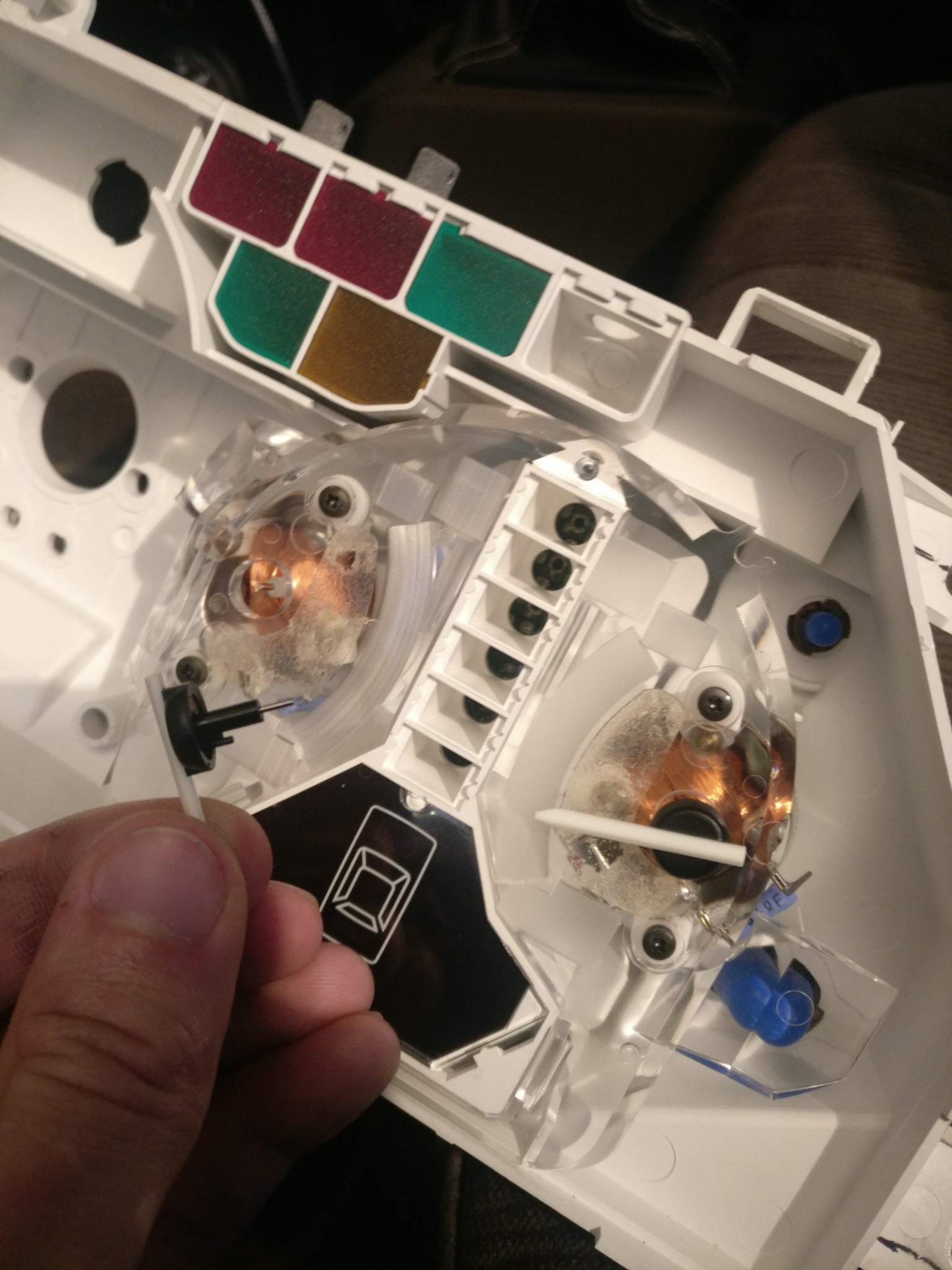

I opened the cluster the other night to desolder the BRAKE LIGHT warning, put it back together and the fuel gauge pegs. Opened it up again and checked the voltage, looks ok just needs the needle adjusted I think. The whole shaft pulled out of the needle and it snapped when I tried to pull it out. I think the same thing happened to the coolant gauge before I opened it, I think Ive got the needle in a little better place... or it could be totally whack, idk. Pretty sure my low fuel light works... at least it worked before.
My plan is to swap in eg/ek gauges, looks like they fit, if not its close enough to modify. I need to get a wheel speed sensor somehow though. Surely I can use the trans speedo output, it just has to drive something I can get a reading from.
Not if I remove the speedo cable lol. Whole point of an EK speedo is to get rid of the cable.
If Civic gauges fit, which I think they should, it should be a lot easier to get parts. My main worry is the fuel and coolant gauges don't share the same centerline as the Accord.

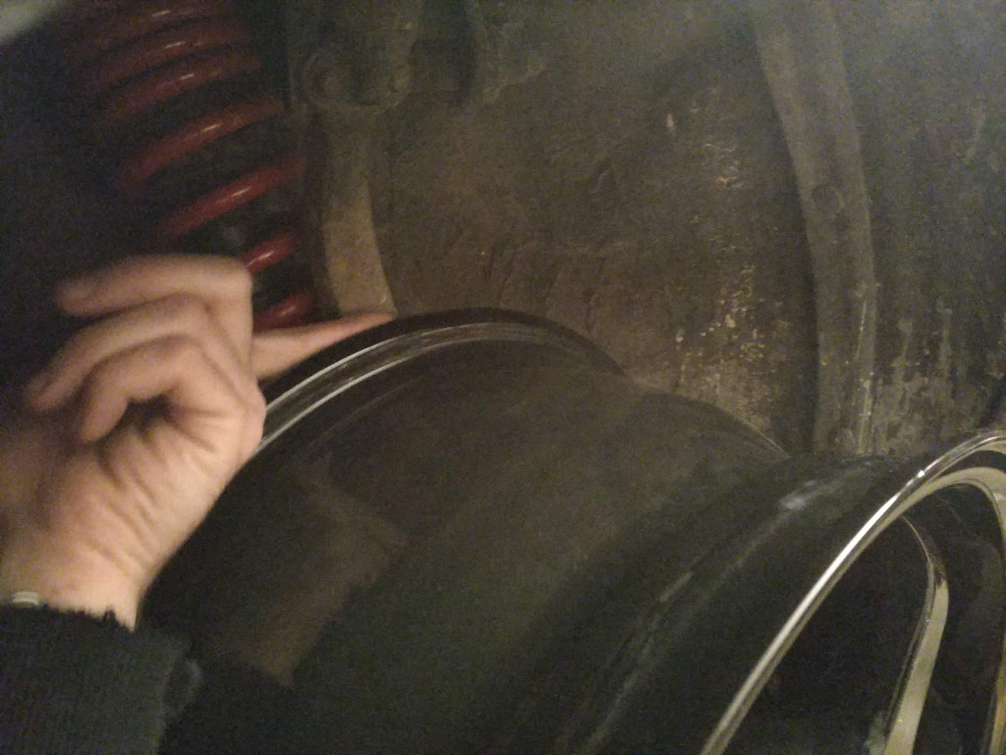

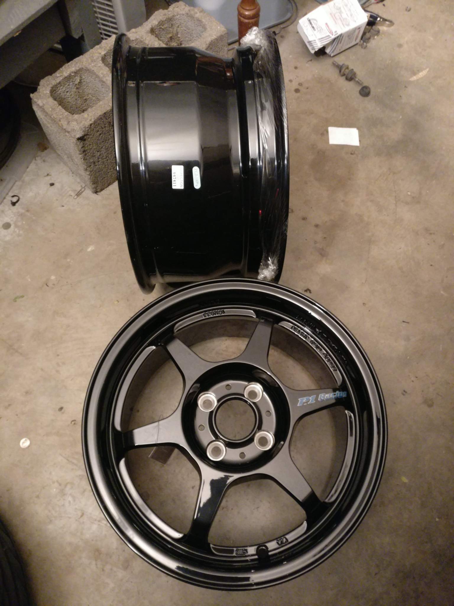

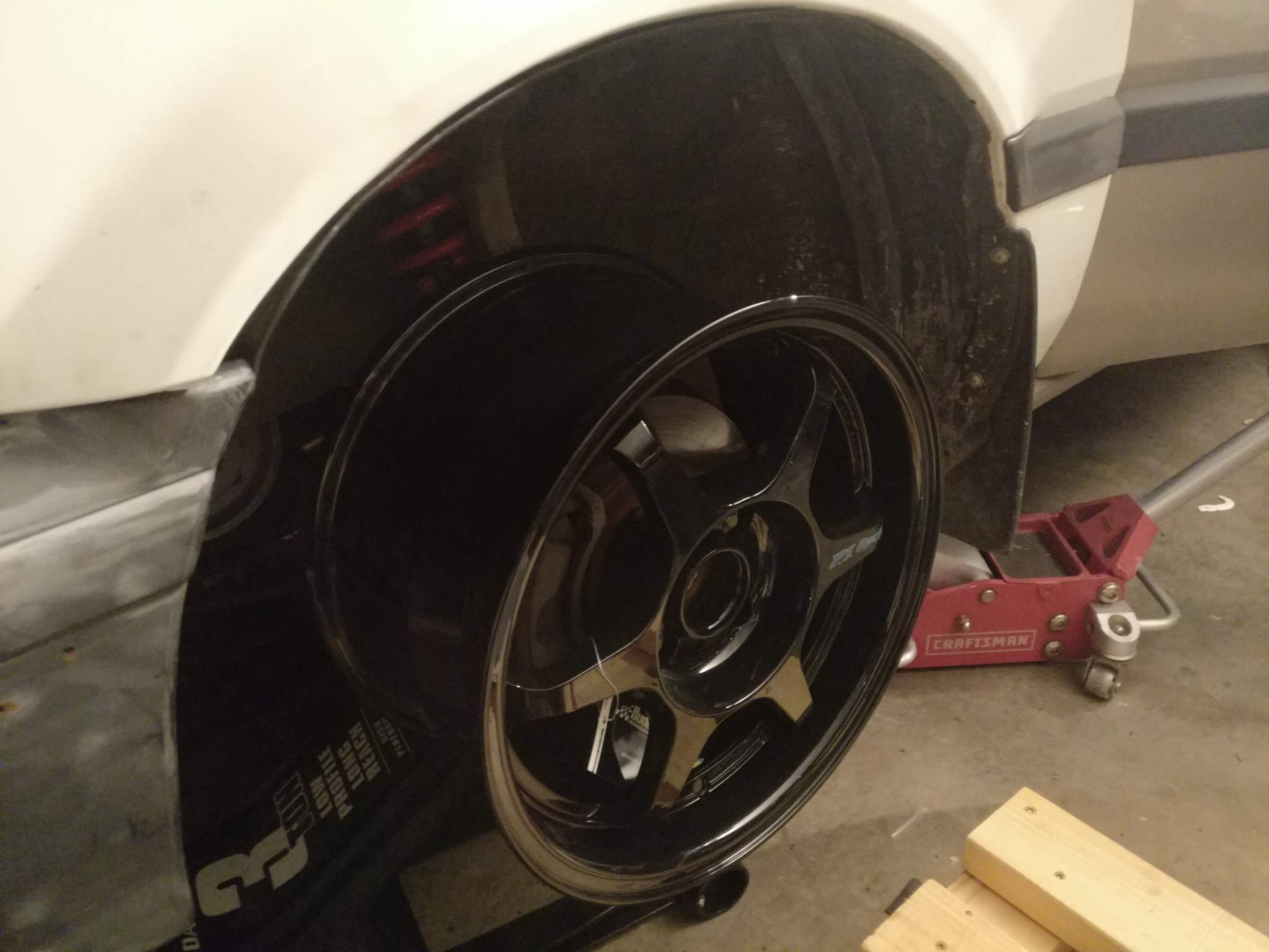

Buddy club SF 15x8+32JJ, will mount a 225/45r15, probably Nankang CR-1. I don't think fitment can be any tighter than this lol.
At a later date I might get a pair of 15x7+35s and 205/50r15s for the rear to run a reverse stagger, but I got a deal on a full set :rockon:
