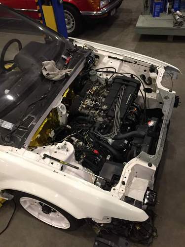

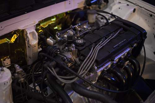

Alright! Updaaaaates!
I'm still doing my best to dodge around the wiring harness, basically doing anything I can to put that off, since it's terrifying! Instead, I put some hours into deleting brackets, cleaning up the engine bay, and other odds and ends. I've got a heap of no longer used parts growing in the trunk, those being: the coil pack support, power steering fluid container bracket, the brake booster vacuum hose arm, the OEM overflow tank (& bracket!), the prop valve heat shield, fuse box rear support, pedal cluster cable management bracket over the engine mount and finally the throttle cable bracket (which is TBD. Might be putting that back on, that mostly depends if I can figure out how to make custom cables! Or, does anyone know someone who can??).
Attachment 9463
That said, there's a lot of things I need to make, the biggest one being the support for the fusebox, which is in stage two of three right now! Our first step was to mock something up out of cardboard, just to sorta' get it in the place it wants to be. I utilized the battery tray bolts on the inner side of the frame rail, and made a small bracket that used the cold air intake screw and another OEM hole to match up to the little support that's part of the injection molded fuse box.
Attachment 9464
...and after realizing that setup had the box too high, I made another pass and got into sheetmetal, this time making a C-shaped central support bracket and shortened frame side bracket with a slight bend to match up to the existing fuse box screws. I'm not perfectly pleased with it yet, so I'll make one more with provisions for a positive battery terminal lead and isolator, fingers crossed that all the packaging works!
Attachment 9465
So that was the main thing, there's some different things here and there, but in the downtime I mocked up a better idea for my hanging subwoofer plan, using a trapezoid shaped box to hang over the tank so that it's still visible, and using all the space that's up there so I can have two subs instead of one in a clunky box! Nice!!
Attachment 9466

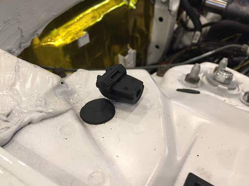

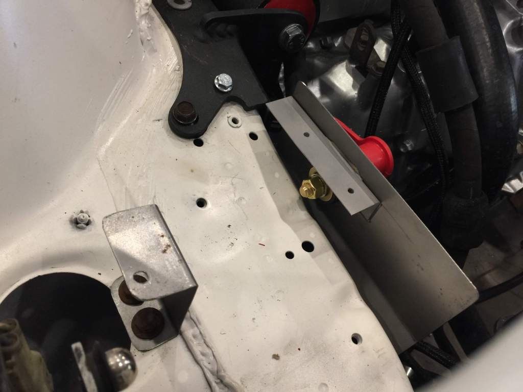

Time to catch up from the weekend, as many of these posts have gone, it was mostly focused on a few little details and trying to get them sorted! Friday and Saturday were spent on iteration three of the fuse box relocation, and all its secrets!
There were a few things I was not happy with with the previous iteration, the main one being a half flange-half harsh edge running across the top, and we hadn't sorted out a location for the remote battery terminal, so it was back to the drawing board! I traced out the previous bracket on a new sheet, made my radius' a bit cleaner, and spot welded the previous screw hole flange onto a new sheet, and dremeled out a hole for the positive post. But pictures describe it easier!
Attachment 9474
And you can see how I (purely by chance!) lined up the positive lead with a divet in the frame here:
Attachment 9475
Which all explains the first bracket, but what about that other C shaped one? I drilled two holes next to the big hole (where most of my wiring will be feeding through) and then drilled through the fuse box (that was honestly a little nerve-racking!) through a hole that mated the two lower fuse box halves together, and put a longer bolt through it, which will ultimately be our third point of support for the box. (PSA, I haven't tested this method of holding the fusebox on the working car, and I highly suggest you don't do it until years from now when you know for a fact that this thing hasn't burned down in an electrical fire! :) )
Attachment 9476

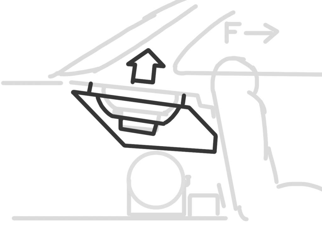

Where is the sub box going. Under the rear deck pointing down?
I build a triangular sub box that fit flat against the back of the seat in the trunk. The top was 3" thick and the bottom was 10" or so. It looked clean and hardly took up space but wouldn't work if you want to fold down the seat to put longer items through the passthrough.

You're pretty much right on the money! I'll be hanging my box from the package shelf (as the tank lives at the back of the trunk) and pointing my speakers up, which will negate the pass through, but still give me access to the air ride control box if I need to make any repairs, along with staying out of the way of the panel that lifts up to reveal the spare. I wanted to use as much space as I could without impeding on the ever so important "Forged by Morons" decal. We'll see how it fits at the end of the day! Here's a shoddy section view sketch to explain my strange sentences!
Attachment 9481

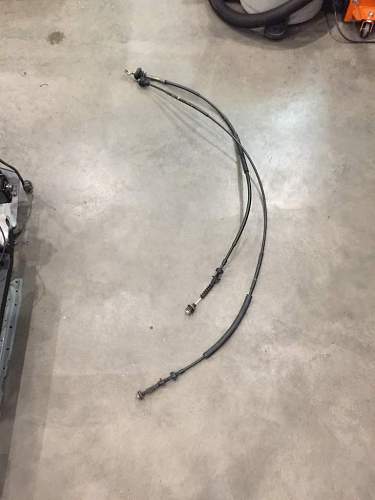

Well! I'm impressed, things went pretty gooood! The clutch cable fits nicely, and only took a little bit of trick to get done, the DA Integra headrest fits the Prelude seat well, and the speedometer cable is (literal inches) from working, so I've got a Prelude one on order, then we should be good for a writeup! Let's dive in!
Prelude seat? Straight forward as they come! This will get re-upholstered, so don't mind the color clash, what's improtant is that they're see-through!
Attachment 9483
The DA Clutch cable conversion was a bit of a pain, but that's fine! The positives of 1) a shorter cable 2) getting brackets to hold it steady in the engine bay 3) it running behind the block as opposed to in front of it make the this conversion worthwhile!
So here, proof of point, you can see how the DA cable (left) is about a foot shorter than factory:
Attachment 9484
The only real difference is that the boot for the Integra is too large, so you have to swap those. There's a big flange on the end of each one, so while getting the DA one off is just some wrestling, I had to slice a slit halfway up the Accord one to get it to fit over.
Attachment 9485
So here, you can see the size difference- with the 3gee being much smaller!
Attachment 9486
Then, since the Inner diameter of the 3gee hole wont happily fit around the large DA metal guide, I trimmed off the end so that it expands easier. I was thinking about cutting it further back up the first bend up, but that's a pretty negligible detail.
Attachment 9487
And then boom! It fits over, and will now slide right into where the last one went!
Attachment 9488

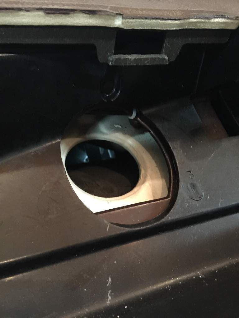

Heyo! Here's a bit of an update! I spent most of it splitting my brother's Equinox in half, so the Accord mostly sat idly by- and there's some big news I'll make another post about in a second, but in terms of wrapping the cable project, here's what got done!
I got the Prelude Speedometer Cable (Search google for PIONEER CA-3073, and buy it from whatever site suits you best) and it fits our car PERFECT. You can see it poking out at the tip of the second velocity stack up, and coming out of the speedometer at the bottom. there's no severe bends, it falls right place and it leaves just enough length that you can extend the gauge-clip end out a little and then plug it in.
Attachment 9498
The only hiccup was that I had to make a new hole in one of the steering column stampings, (in this image, the lower part of the image is toward the back of the car, and the top is heading to front.) Like any part of of under-dash work, it's best to stick you head in there and take a look around with the reference photo handy.
Attachment 9499
You can see here how there's light coming through the hole when you gunsight the speedometer cable hole to the center of the vehicle. which is where the cable ultimately runs.
Attachment 9500

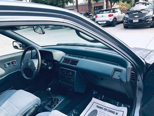

Okay, time to take the lid off of a little side something something that's been in the works for a little while! To those of you who remember seeing TE37s floating into this thread while knowing there's no way I'd replace my Manaray wheels for anything else, wonder no longer!
I'm crossing off a huge item from my bucket list, a roadtrip across the U.S. in a rad old car! (and it also happens to be with a super cute girl, only to sweeten it up!) The car I mention is this amazingly clean and stock 1988 Honda Civic (DX, with AC, a sunroof, and five speed! Awesome!), I recently remotely purchased it, and its currently sitting in LA at a friends apartment while plates and titles make their way across the country!
Attachment 9503
Attachment 9504
Attachment 9506
Attachment 9507
Attachment 9508
Attachment 9509
Attachment 9510
so YEAAAAA! Super geeked to get another parts hauler for the Accord(s!), in fact I was on the verge of buying one of these when I got into 3geez (imagine that timeline!) and have thought they were awesome ever since. So I'm extremely excited for this trip coming up in May!
The current plans are to make LIGHT, REVERSIBLE modifications, the big three being a full disc swap, and some nice Skunk2 suspension work, and the Integra lip that was mentioned in the post above! I'm stoked, had to share!!! Can't wait to once again own three Hondas at once!! :D

Another weekend, another couple steps forward!
I've got good news! I've got a near working hood strut system! Its SO close to finally being a thread! But I'll show ya what I've done so far so that you can take notes!
I'm using a SINGLE factory hole (it's a 10mm bolt on both sides of the car) that has m6x1.0 threads, one holds down some vacuum lines on the drivers side, (or you can replace the bolt that holds down a leg of the coil pack bracket on the passenger side) and replacing that 10mm bolt with an m6x1.0 ball stud! Here's what I bought:
https://www.ebay.com/itm/New-Zinc-Pl...cAAOSwNnRYh9xq
Then, since we're only using one hole, you cant hold a bracket arm steady for a full 90 degree rotation, so I bought these:
https://www.ebay.com/itm/Nitro-Prop-...72.m2749.l2649
And they swing up quite nicely, feel free to scroll up to find the near duplicate photos, and you'll see how they work.
And now getting to the good part, I bought a pair of Cadillac CTS struts from here: https://www.ebay.com/itm/2-Hood-6249...IAAOSwOztciryb
(IMPORTANT NOTE. You MUST buy these from this seller. The ends (unlike OEM) are threaded on, and that has to be true for this setup to work so you can swap the ends.)
Then, lastly, I'm using a M8x1.25 13mm ball stud from a Ford Taurus for the upper hood hole. I'm not using another m6x1.0 ball stud since we're mounting it in flimsy sheet metal. There's a preexisting hole in the hood near where the struts wants to live naturally, so I'm drilling in new hole near that and (once it arrives) installing a matching Riv-nut there. Ultimately giving you a setup that looks like this:
Attachment 9514
It closes nicely even while only being held up with one strut, and lifts the hood with ease. I'm excited to be getting so close to cracking this! Plus, if you buy everything listed, you can build the other one and sell it as a kit to some other dude! Or put it in your spare 3gee!
