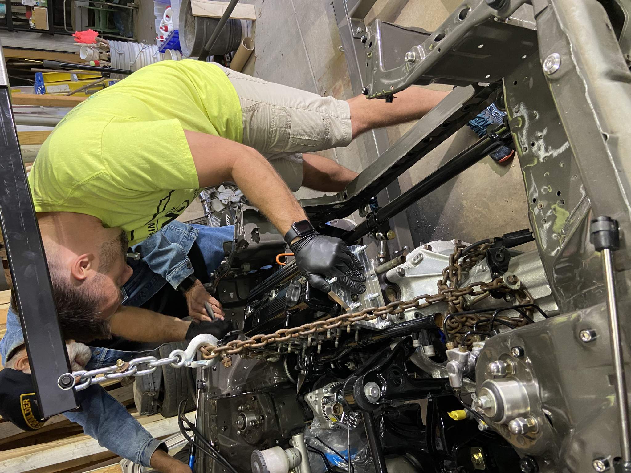

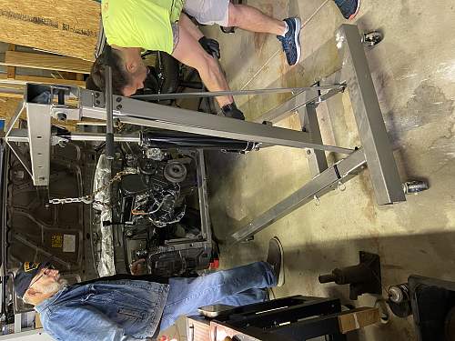

3 Attachment(s)
Re: bscanlan' Hatch Build - The Sequel
O…K…so today was motor drop day! :beer: I am running Cheddas solid front cross member, and I swapped auto-to-manual (yeah I know Snooz). So in doing so I have 3 motor mounts; when an auto it had 6. Am I concerned…mildly but what the hell. Then I installed the half shafts and had to persuade the driver side spline-to-hub assembly. I am now taking a nap because I am old and can’t be crawling all over a concrete shop floor anymore. I will get the area cleaned up tomorrow and get more pics…but oh yea, I hooked up the clutch cable and seem to have good engagement and movement with the throw out bearing, so my flywheel milling might just do the trick Attachment 10917
Attachment 10918
Attachment 10919
