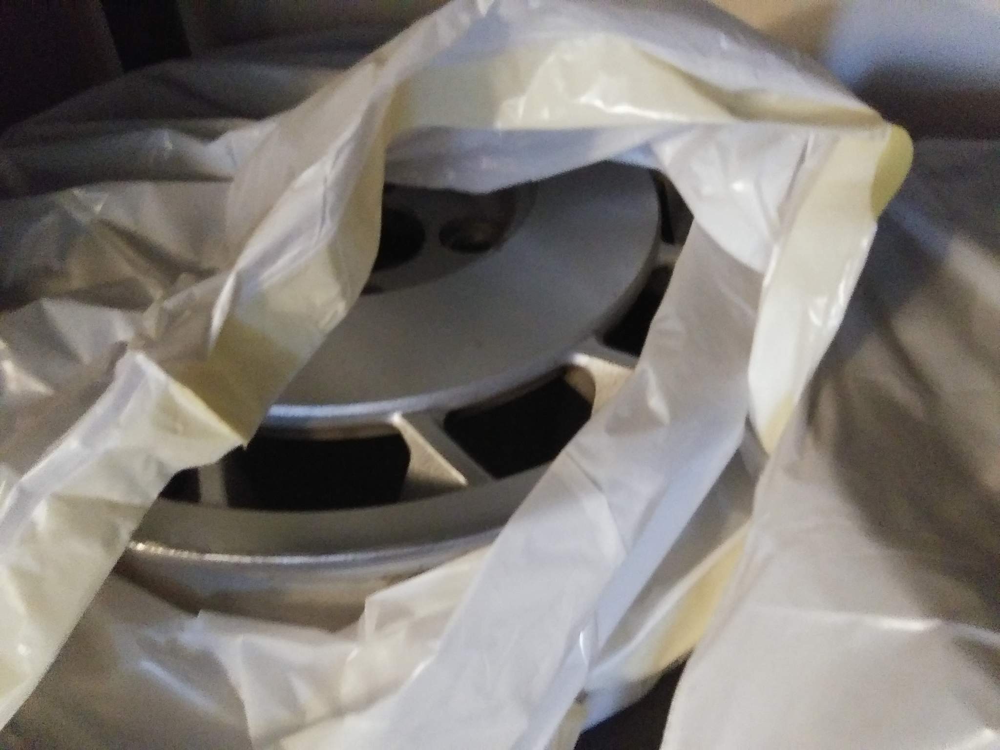

Yes, those are crap tire-shop wheels. They couldn't get anything factory-size when I urgently needed them some years back.
But of course I kept the factory wheels for the next set of tires...
Attachment 10229
