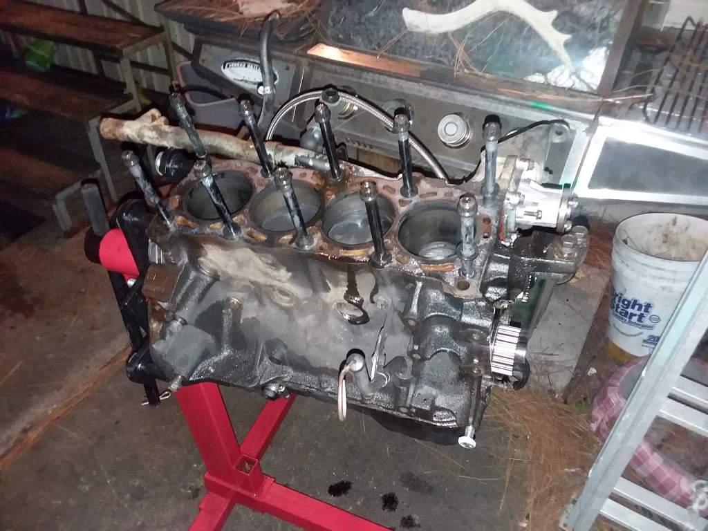

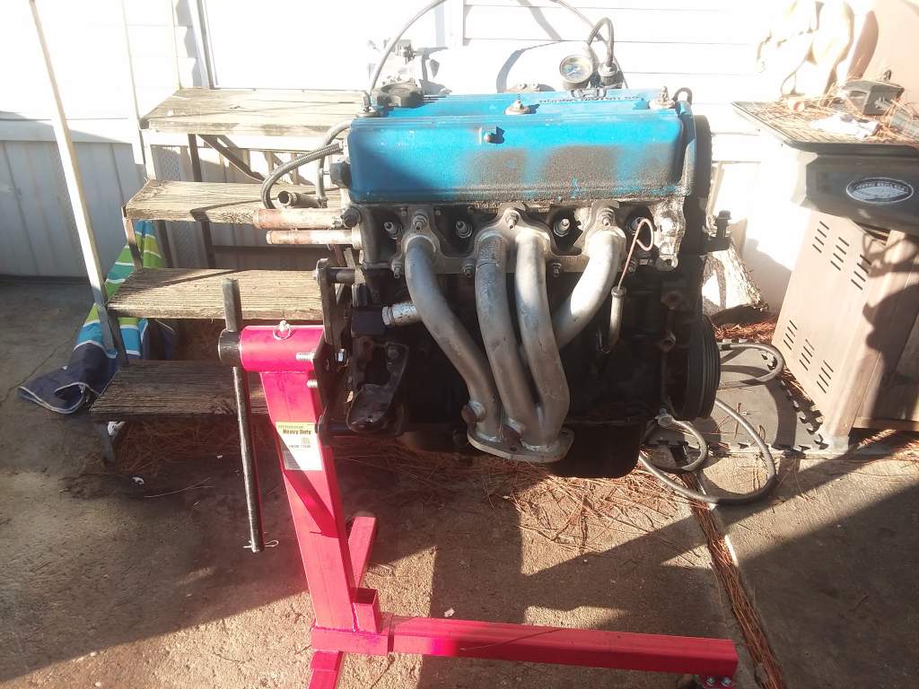

I let it dry out and it's still knocking so we're proceeding to pull it all out
Attachment 9758
Thanks so far it's looking like one bent rod

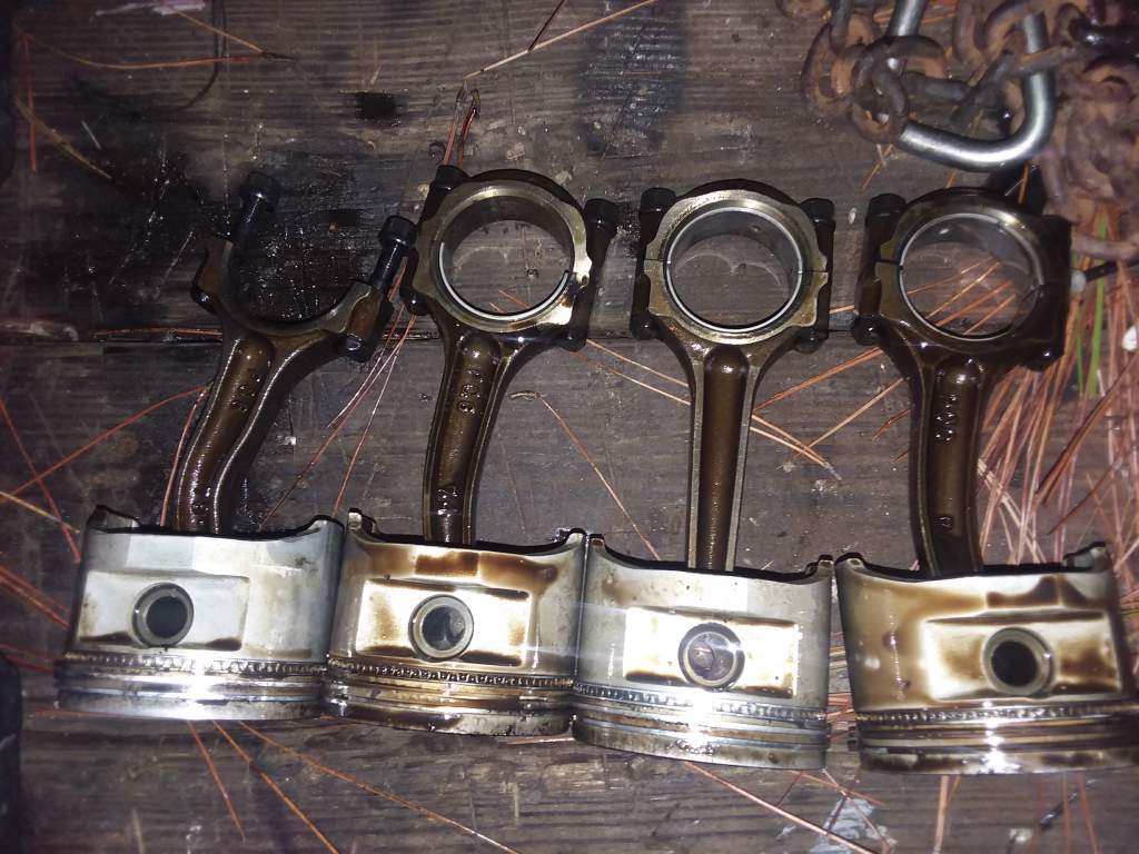

We got it almost all tore all down and looking like three out of four are bent
Attachment 9760
Attachment 9761
Attachment 9762
Looks like your rods were at the Funhouse Carnival Mirror Tent too long.
Bent but not broken!
same thing happen to me two years ago broke the number 1 rod i put in another motor
Eek! Good luck on the rebuild.

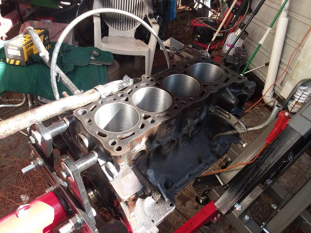

It's getting there hopefully we'll have it back together and running in tomorrow.
Attachment 9764
ohhh that hone does look fresh. am intrested
Replacement rods Pistons Rings fresh rebuild. back on the streets.

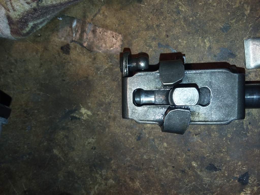

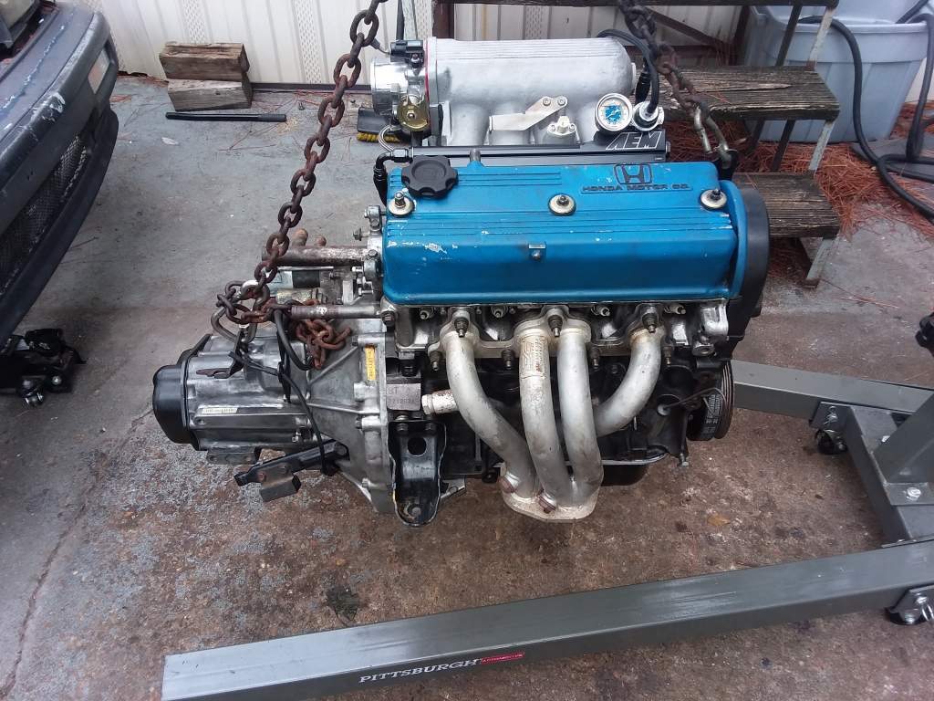

All right the hybrid transmission has been taken apart and I found out that the shift change holder mechanism is bent the reason why I wasn't able to go inn first and second only 3rd 4th 5th and reverse.

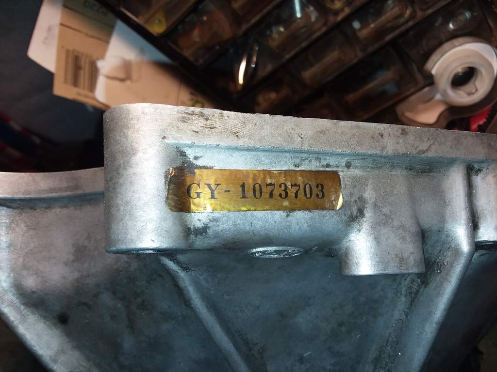

And come to find out from looking up the number the transmission bell housing is a second gen Accord a18 bellhousing. So two areas have to be grinded down to clear the larger pressure plate for the A20.

But other than that the main shafts both shaft just slide into place Integra gears 1 through 4 and A18 5th gear and bellhousing. Waiting on a throwout bearing from spec clutch before I swap it out. As far as the car running it runs pretty good I got some tapping coming from the valve cover area I may have a bent valve it's also time to adjust valve lash so that's it for now.
Whats you clutch choice? this EDIT: Clutchnet Green I have always sucked and now its just getting worse as far as shifting and hanging up. I swear I need just go back to stock.

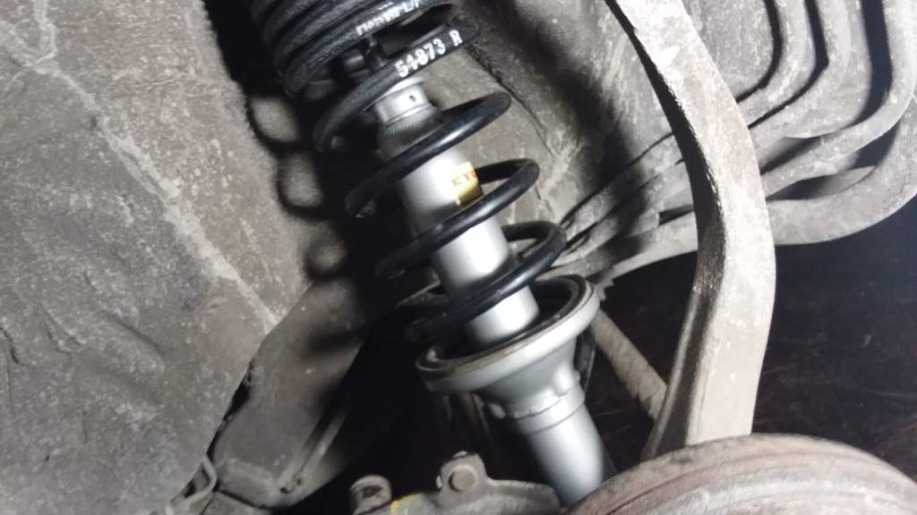

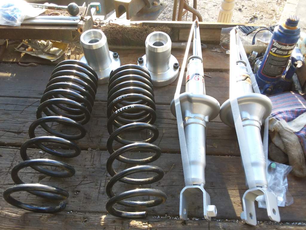

I gave up on searching for the rear tokicos everyone is discontinued. So I went with these eBay special KYB shocks for the rear. To go with my H&R Springs and Cheddars Auto rear top hats.

Good find. Let us know how it rides.
Cool man.
The stock shocks valving was always terrible and the cheap aftermarket replacements are usually worse.
