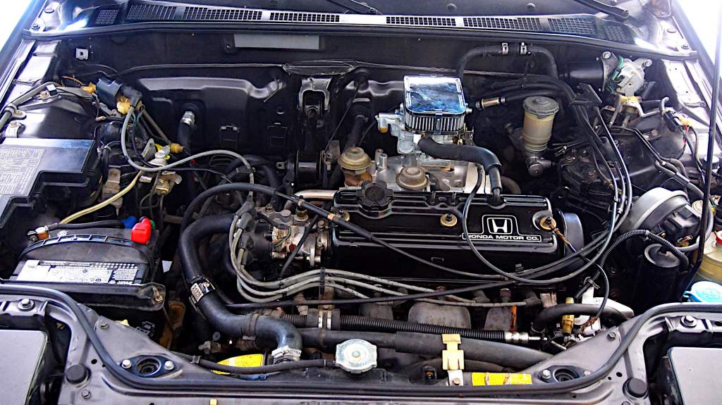

3rd GEN ACCORD WEBER 32/36 Conversion
Engine bay pic. I made this throttle cable connector so the cable would go slack and allow the throttle to close completely. Also easy to disconnect and reconnect without adjustment. I moved to the inner hole to better match the transmission cable action, shift points are identical to OEM. (Edit: Shift points are better than OEM)

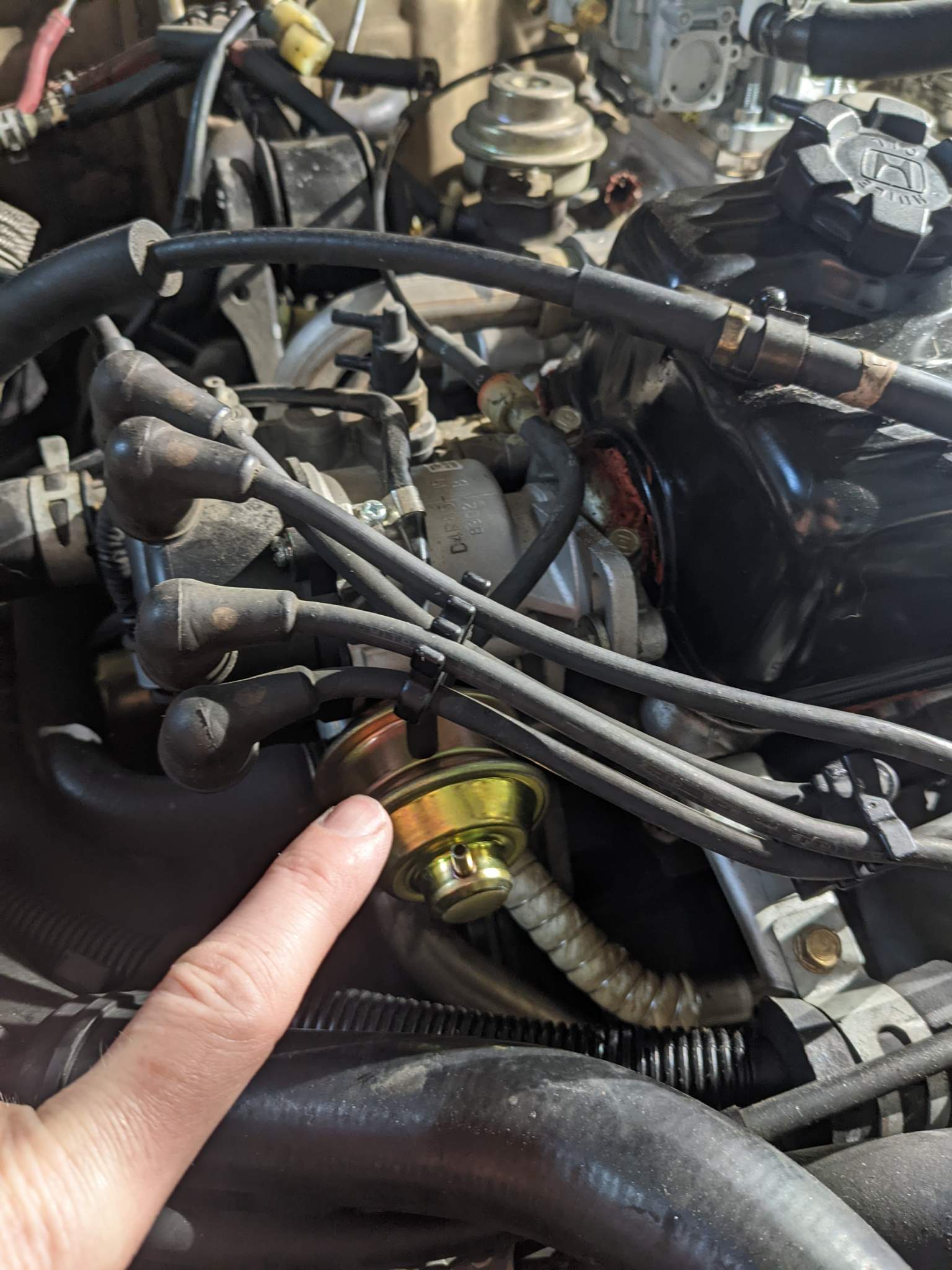

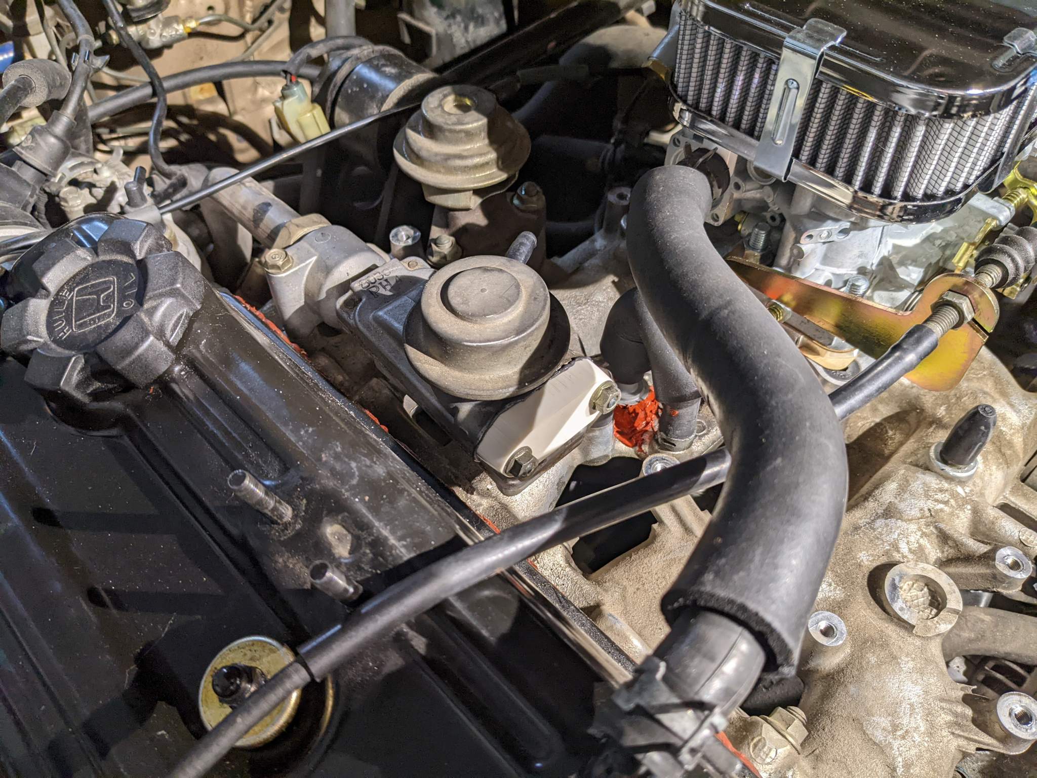

So I have a few questions on my Weber install that I hope y’all can help me with…
Do you plug this hot air pipe or remove it at the exhaust header and block it off somehow? And what is the other valve with two vacuum lines, do I just leave it venting to atmosphere?
Attachment 11079
And what is this connection? And the vacuum line in the pic also? Might be the coolant line, unsure it goes underneath the intake manifold:
Attachment 11080
And lastly in the install directions in a thread I was reading said to connect choke wire from harness to new choke, where is that at?

Oh and to make sure I’m right on this one, I plug the nipple that doesn’t have a vacuum line on it and the other one goes to the back of the carb, correct?
Attachment 11081

That hot air pipe from the manifold you can remove. I'd doubt there's any hole at the other end to block off.
I haven't done this conversion, so if someone else contradicts me later, then listen to them.
Generally speaking, however, anything that still needs vacuum (like the brake booster or distributor advance), you can plug into almost any available vacuum port on the new carb. The only exception is if there's a ported vacuum port on the new carb, which should only be used for a ported advance distributor, which I'm pretty sure Honda never used. Just block that vac port off and use a tee if you run out of the other ports. The choke wire will plug into an electric choke. If your new carb doesn't have an electric choke on it, then there's nothing to be done.
That's really all there is to it. You just need it to run at this point. If there are old sensors missing vac lines, or random wires no longer plugged in, it doesn't really matter as long as it runs well enough (and you don't have vacuum leaks). It will probably not run as well as the original carb, however. You've removed a lot of the magic Honda put on it to make it civilized. You might notice weirdness here and there, like high altitude cold starts are more protracted, but that should be rare.
Post a vid when you get it running.
Re: 2nd & 3rd GEN ACCORD WEBER 32/36 & 38 HELP
It looks like you are on the right track. The vacuum nipple thing coming off the thermostat housing can be left alone. You can delete the hot air pipe, I don't think it is necessary and it is difficult to remove and will require a plug in the exhaust manifold and a block off plate on the manifold. There are 3 coolant lines on the manifold, I am unsure what you do with them for a weber because I believe they all come together at the carb. The 2 large lines on the sides flow through the manifold, the one underneath goes through the carb and meets up in the manifold. I prefer to plug the center carb line and connect the other 2 together, bypassing the manifold, I don't think they are necessary and doing so will prevent leaks. Your region of this dirt is no colder than mine, but make sure you know how to handle a stuck throttle if the carb ever so happens to ice. And I think you have the lines on the dizzy right, but it goes back to the manifold, anywhere you like as long as there is full vacuum, it only tees to the carb if your weber has a vacuum power valve, I don't remember if they do, but if they do it will have a very obvious vacuum nipple on it.
I'm pretty sure that air pipe runs from a baffle on the exhaust manifold to a door on the (old) air filter. Unless these setups are really atypical.
Oooooh, I didn't look at the picture well enough... yeah, he can't even use that with the weber, only with the stock air cleaner
So just pull that off the exhaust, no plugging anyting
Yep, once I pulled it I felt in there and it was just to direct some hot air up. I got to looking at the old carb and found that electrical connection went to the stock carb’s choke so I made an extension wire and plugged it into the Weber’s choke. And with the help of the coolant pressure tester, that other vacuum hose was actually the coolant line I had to plug. I threw a bolt in it and put a worm gear clamp on it. Didn’t have any aluminum bar stock laying around to I used an old piece of corian countertop I had laying around and used that for a block off plate. Probably not the best block off plate but it works.
